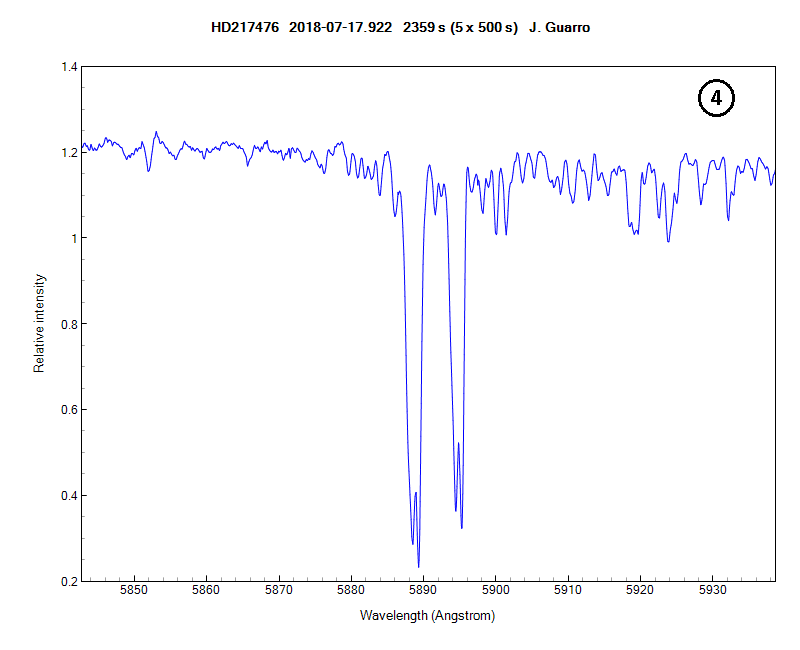

I observed the star HR8752, ( HD217476 ).
I send here some graphics to R=9000
1.- A general vision, range 3980 to 7759 Angstroms.
2.- Ha in emission
3.- It's appreciated a blue-shift in the Ha.
4.- Na doublet, double lines.
5:- Main zone to observe, 6300 to 6600 Angstroms.
Regards, Joan.

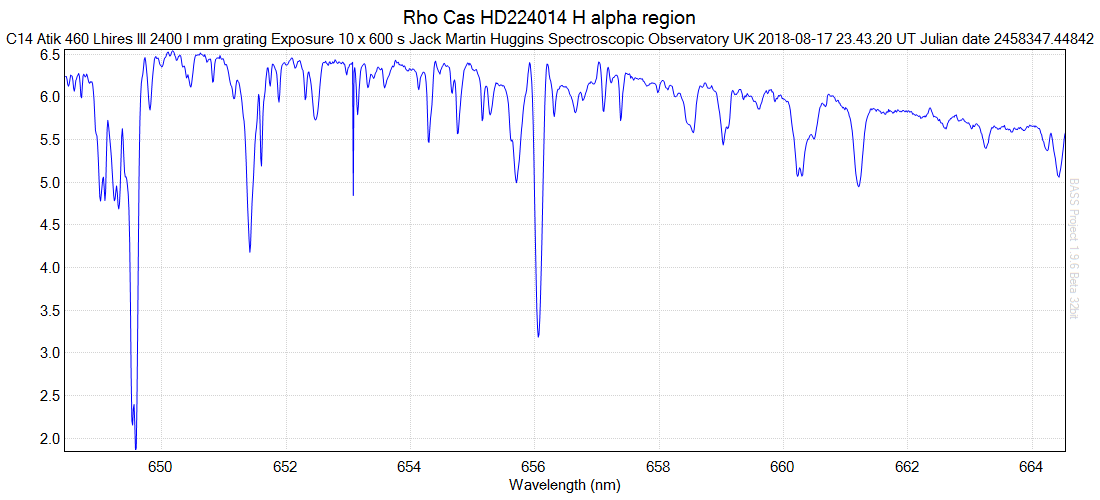

Here is my effort from last night.
Any comments ?
Regards,
Jack
Huggins Spectroscopic Observatory UK
