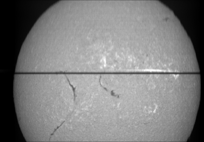

Hier sind vier Sonnen Bilder im Lichte der vier Fraunhoferlinien; Ca II H3 (3968.5 A), H beta (4861.3 A), He D3 (5875.6 A) und H alpha (6562.8 A). Diese geben vier Ansichten der Chromosphäre.
Jetzt kommt Englisch!
Because the spectroheliograph (SHG) is a grating instrument, it is easily tuneable to any wavelength of choice. In the present configuration, I achieve a resolution of ~ 0.2 A. The images below show a series of spectroheliograms taken by "stepping" the SHG, in small wavelength increments, through the broad Ca II (H) and H alpha absorption lines. Physically, as we tune from the absorption line centre outward to the line wings, we observe the disk as it appears at different depths in the solar atmosphere. The farther from line centre, the deeper into the atmosphere we look. At line centre of strong absorption lines, we observe pure upper chromosphere and, as we move into the line wings, the photosphere comes into view. By tuning through strong lines with the SHG we are accomplishing solar "tomography".
There is further complication to this simple picture! Some solar features (especially filaments and prominences) have large line-of-sight velocity components with respect to the Earth. This contributes a Doppler shift to the absorption or emission lines associated with these features. I have measured some of these velocities in earlier observations and will discuss them further in future posts.
Here, for example, is a study of prominences observed in Ca II K light. The prominence shape changes strongly from the red side to blue side of line centre because of the different velocity components in the prominence plasma.
http://www.pbase.com/p_zetner/image/160940150
Ich hoffe, das für Sie von Interesse ist, und ich hoffe, Ihr Feedback zu hören.

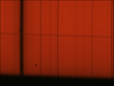

Hier habe ich ein Hg-Spektrum (gelbes Dublett) hochgeladen.
Hg Spectrum-01Jul2015-01.png [ 74.65 KiB | 2990 mal betrachtet ]
Mit einer Linienbreite von 0,25 A erreiche ich R ~ 23000. (Für Optik-Konfiguration: 500mmf Kollimatorlinse; 25 um x 18mm Schlitz; 25mm x 50mm, 2400 l / mm Gitter und 400mmf Kameraobjektiv).
Im Betrieb wird das SHG fixiert und die Sonne durch das "field of view" driftet. Ein vollständiges Bild der Sonnenscheibe erfordert die Sonnenscheibe seinen eigenen Durchmesser zu reisen. Das dauert ~ 128 Sekunden.
Schöne Grüße.
Peter.

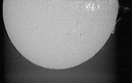

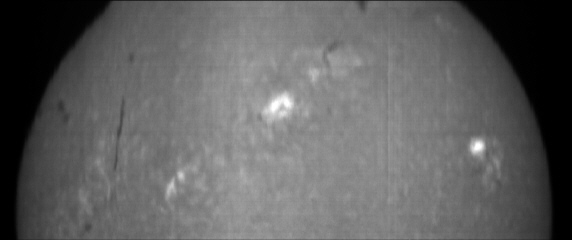

nachdem ich aus der Schweiz wieder zurück nach Norddeutschland gezogen bin, habe ich nun allerdings schlechtere Bedingungen wegen erhöhter Nachthimmelshelligkeit durch heftige Beleuchtung und naher Bebauung. Meine Schwerpunkte sind die Veränderlichenbeobachtung und die Spektroskopie. Wegen der kurzen Sommernächte wende ich mich aber mehr der Sonne zu, die ich vom Frühjahr bis Herbst ganz gut beobachten kann; danach ist zwangsweise Winterpause in dem Thema.
Letzten Sommer habe ich erste Versuche mit der Spektroheliografie unternommen. Die Ergebnisse sind aber noch heftig suboptimal. Als Aufnahmegerät benutze ich einen 3Zoll-Refraktor mit dem LHIRES (2400 L/mm, Spalt 15 µm) und der QHY5-II. Die empfangenen Daten werden mit der französischen Software IRIS bearbeitet. Diese kann die aufgenommene avi-Datei in eine Serie von fits-Dateien umwandeln. Da ist aber je nach Auflösung der Kamera die Anzahl der erstellten fits-Dateien begrenzt. Hier wäre demnach eine mächtigere Software angebracht. Mit welcher Software arbeitest du, Peter? Die Befehle zum Zusammenfügen der fits-Dateien zu einem neuen Gesamtbild arbeiten aber gut.
Ich hänge einmal zwei Beispiele an, die nach der Durchlaufmethode entstanden sind (Sonne wandert bei abgeschalteter Nachführung durch das Bildfeld).
Das H-alpha-Bild wurde mit höherer Auflösung gemacht und anschließend in der x-Achse mit dem Faktor 2 gestaucht. Nur der Rot-Kanal wurde ausgewertet. Das Segment ist aber noch nicht gleichförmig rund. Die kleinen Randausfransungen könnten vom schlechten Seeing kommen. Die Software beendete die Konvertierung nach 577 Bildstreifen.
Das Ca-H-Bild wurde mit der Auflösung 640 x 480 Pixel der Kamera aufgenommen und anschließend in der x-Achse mit dem Faktor 2 gestaucht. Der Sonnenrand ist aber auch noch nicht gleichförmig rund. Hier hat die Software die gesamte avi-Datei konvertiert.
Wie bekomme ich den Sonnenrand gleichförmig rund? Wie bekomme ich ein gleichmäßiges (glattes) Bild?
Schöne Grüße, Jörg!

Ca-h-klein-binx2.jpg [ 50.92 KiB | 2874 mal betrachtet ]
Halpha-redx2.jpg [ 52.41 KiB | 2874 mal betrachtet ]

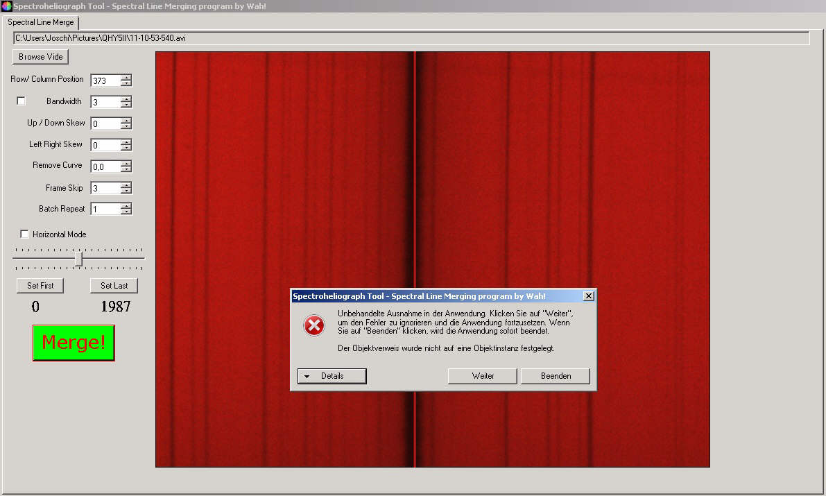

Hi there,
when using SLiM by Wah! a strange error occurs. If I use 'Left/Right Skew' or 'Up/Down Skew' with an avi-file cropped by VirtualDub and try to use 'Remove Curve' too the spectrum gets skewed in itself (see attached screenshot). Any suggestions?
Greetings Jörg!
SLiM_screenshot.jpg [ 42.62 KiB | 2775 mal betrachtet ]
BeitragVerfasst: 09. Februar 2017, 23:32:31 PM
Beiträge: 244
Jorg,
Hmmmmm......
I usually work with the absorption line horizontal....
Going back to Wah! recent comments on the latest upgrade:
If you use the mono 8bit or 16bit SER file format to capture the video, it should be able to support without problem (I hope)
I was too lazy to implement the code for 16bit SER vertical mode, please make the spectral lines horizontally while using 16bit SER
Could it be this issue????

Well, let's have a look!
Jörg!

BeitragVerfasst: 23. Februar 2017, 16:42:30 PM
Beiträge: 216
Wohnort: Harsefeld
Hi Peter and Ken,
I found Peter's explanations really helpful and tried to make myself familiar with this distortion filter. Well, I'll see ......
At last I tried Wha!'s program in the horizontal mode, as Ken had suggested, and it worked fine. The result isn't that good because of bad aquisition conditions.

BeitragVerfasst: 30. März 2017, 15:49:14 PM
Beiträge: 216
Wohnort: Harsefeld
Hi Ken and Peter.
Finally got the chance to take some avi-files of the sun. The results are below.
Before the acquisition I took care that the sun moves perpendicular to the slit. I managed this by letting the sun move parallel to the slit in declination. A sunspot was really helpful in this case. Afterwards I aligned the spectral lines in an upright position by turning the camera (snapshot.jpg; the dark horizontal line is a sunspot). I found that these provisions decrease the distortions of the raw picture.
1. After all geometrical corrections with the software fitswork the sun disc istn't perfectly round, especially in the upper left part. I saw that this appears in some of Peter's pictures too. I don't no why.
2. Are the tiny sawteeth (seeing.jpg; magnified snippet) a product of bad seeing? I've attached two frames of the avi-file (rot192.jpg, rot195.jpg) where you can see that one is really fuzzy at the lower part.
Cheers.
Jörg!
rot195.jpg [ 3.62 KiB | 2528 mal betrachtet ]
rot192.jpg [ 3.69 KiB | 2528 mal betrachtet ]
seeing.jpg [ 32.05 KiB | 2528 mal betrachtet ]
snapshot.jpg [ 31.63 KiB | 2528 mal betrachtet ]
20170328-1451-halpha-2601x600_2.jpg [ 28 KiB | 2528 mal betrachtet ]
BeitragVerfasst: 31. März 2017, 00:49:20 AM
Beiträge: 244
Jorg,
based on my experiences with the long focus Littrow SHG, the "edge effects" can be caused by a few issues:
1. General seeing and wind vibration causing the image to shift slightly during the exposure. Not much you can do about it....the answer I think is faster image acquisition, hence my ongoing trials with the fast frame (500fps) ASI 17MM and a wobble mirror.
2. Slight drifting in dec during the exposure. This can cause a "diagonal" shift of the image which then needs to be corrected. The impact is seen more at the edges.
3. Collimation and alignment of the solar image to the entrance slit. One edge of the solar disk may be better focused on the slit gap than the other. Should be verified and checked.
4. Long slit aberrations - ??? Imaging at a distance from the optical axis.....
5. The spectrum should be horizontal to the CCD chip (no obvious tilt) and the Littrow slant corrected during processing. This should give a cleaner top/ bottom edge to the individual extracted images.
Hope this helps.

BeitragVerfasst: 23. Juni 2017, 21:38:21 PM
Beiträge: 216
Wohnort: Harsefeld
Hi Peter,
what did you change in your SHG setup?
By the way, I took a SHG-image at the same day. As you can see, my slit broke at the beginning of the session, because I didn't limit the entrance aperture of my 3"refractor to 50 mm and used it without any filter.
Can anyone give me a hint, why the attached image isn't as sharp in the upper third as in the lower third?
Best regards,
Jörg!
20170619-09-22-r90-03.jpg [ 57.55 KiB | 2198 mal betrachtet ]
BeitragVerfasst: 24. Juni 2017, 09:44:00 AM
Beiträge: 244
Peter explains he has changed to a 4" SCT telescope here:
https://solarchatforum.com/viewtopic.php?f=8&t=22752
I use a 100mm refractor with no ERF on my SHG - no issues.....
Don't know about the image softness - seeing or focus issue??
BeitragVerfasst: 24. Juni 2017, 18:07:14 PM

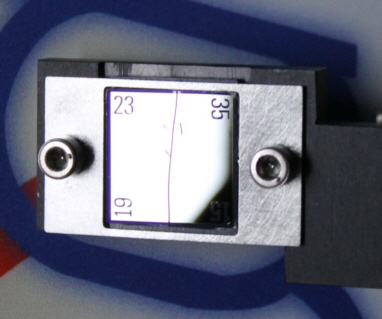

BeitragVerfasst: 25. Juni 2017, 10:49:49 AM
Beiträge: 216
Wohnort: Harsefeld
Hi Peter and Ken,
thank you for your explanations and hints. No ERF on 100 mm objectives ..... are you using metal slits? If not, it can't be the heat alone, that broke my slit. The four slits of my spec are evaporated onto a glass plate. See attached photo with the damaged plate. When I looked at it from the side (next picture) I saw that the top plate that keeps the slit plate in place is slightly bent. This may put pressure onto the left and right side of the glass plate. Together with the heat of the sun it might have broken the plate????
So I turned the plate 90° clockwise put flat washers left and right and will try it without ERF or something like that on my 3" and 4" refractor.
Best regards,
Jörg!
slit-damage-1.jpg [ 52.48 KiB | 2182 mal betrachtet ]
slit-sideview.jpg [ 58.8 KiB | 2182 mal betrachtet ]
BeitragVerfasst: 03. Juli 2017, 11:04:24 AM
Beiträge: 216
Wohnort: Harsefeld
@Peter and Ken and all the other amateurs who use SHG setups without ERF
Which slit constructions do you use and what are the slits made of?
The construction of my spec-slit can be clearly seen in my post (25.06.2017). The reflective surface is chromium, chemichally deposited on the glass.
Here is the answer of the LhiresIII-manufacturer to the broken slit affair:
"By the way, if the slit is broken, it is not totally flat anymore, and it can explain (at least partially) why the spectrum is not well focused all accross the slit, no ? Can you tell me if you already had the same issue before the slit is broken ?
The bending of the top plate is normal : it is made in a spring material, and its function is to press the slit holder (the slit holder is flat, and the part behind also). There is no reason that this effort - which is normal - breaks the slit (except if there is a small piece (like dust) below the slit holder. But if this is the case, the slit would have been broken for a long time.
Also, the glue we use to stick the glass on its holder is made for optics, and can tolerate some differential dilatation (it is a little bit flexible).
Yes, the chromium is a metal, then it can heat a lot. But the glass can resist to a very high temperature... Anyway, I think that all elements we have in hand say that the slit has been broken by the Sun exposition - no ?"
Best regards,
Jörg!
BeitragVerfasst: 03. Juli 2017, 21:32:32 PM
Beiträge: 244
Jorg,
I have documented many SHG designs in my recent book "Imaging Sunlight - using an SHG"
Most slit assemblies are based on metal slits - from copper to stainless steel. None are based on glass reflective slits.
Having said that, I'm also aware of newer SHG using reflective glass slit plates (I have one on my 100mm Littrow SHG)
The "limitation" seems to be the ability to vary the gap - much easier with metal slits.
Hope this helps.
Ken
