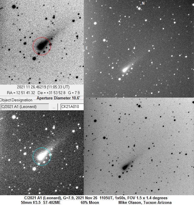

BeitragVerfasst: 28. November 2021, 23:11:12 PM
Beiträge: 439
Wohnort: Tucson, Arizona
Magnitude 7.9 using 50mm f/3.5 scope and ST-402ME, no filters, morning of November 26. Gif animation is 3.5 hours long from time comet rose over Catalina Mountains until morning twilight. Low altitude initially, Moon and passing thin clouds make for brightness fluctuations.
2021A1_20211126_0931_molason.gif [ 1.64 MiB | 31638 mal betrachtet ]
2021A1_20211126_1105_molason.jpg [ 276.03 KiB | 31638 mal betrachtet ]
Cheers, Mike
:lol: Arizona

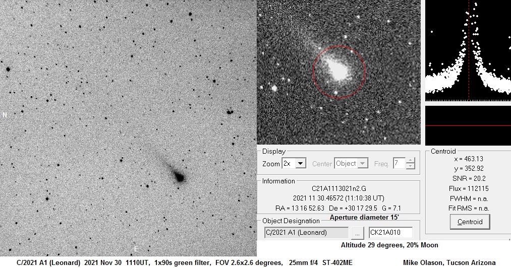

BeitragVerfasst: 30. November 2021, 14:09:27 PM
Beiträge: 439
Before the clouds moved in on morning of November 30, G=7.1 using a green filter at an altitude of 29 degrees, aperture diameter 15', Moon not much of a factor.
2021A1_20211130_1110_molason.jpg [ 300.4 KiB | 31387 mal betrachtet ]
Cheers, Mike
:lol: Arizona

A lot of discussion about the magnitude of the comet. My thoughts for what they are worth based on data from Nov 28, 30 and Dec 3. All data was collected at about the same altitude, 90 second images, green filter, 15' aperture diameter for Astrometrica calculations, 25mm f/4 scope, ST-402ME camera with the Moon not much of a factor and in between clouds on Nov 30. Astrometrica calculated the respective magnitudes at 7.3, 7.1 and 6.9 but the problem with these calculations is that the coma is certainly much larger than the maximum 15' aperture diameter that my equipment allowed Astrometrica to use in it's calculations. So I reverted back to the methods that I used to calculate comet magnitudes before using Astrometrica, this resulted in respective magnitudes of 7.1, 7.0 and 6.7. Images and data from the 3 mornings are provided below for anyone interested. It is my opinion that on Dec 3 the comet is a little brighter than what Astrometrica or my old method of magnitude determination calculated.
2021A1_20211128_1121_molason.jpg [ 311.51 KiB | 30872 mal betrachtet ]
2021A1_20211130_1110_molason.jpg [ 300.4 KiB | 30872 mal betrachtet ]
2021A1_20211203_1128_molason.jpg [ 309.85 KiB | 30872 mal betrachtet ]
Cheers, Mike

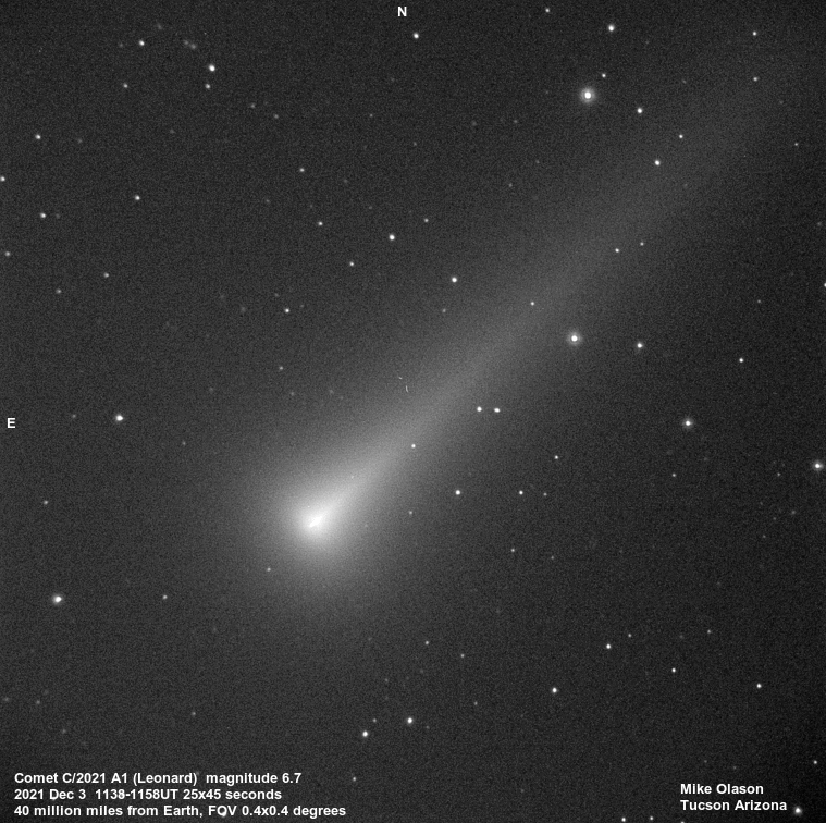

A closer look at the heart of the coma. FOV 0.4x0.4 degrees, coma ~ 0.5 degrees wide per others.
2021A1_20211203_1137_molason.gif [ 7.06 MiB | 30663 mal betrachtet ]
Cheers, Mike
:lol: Arizona

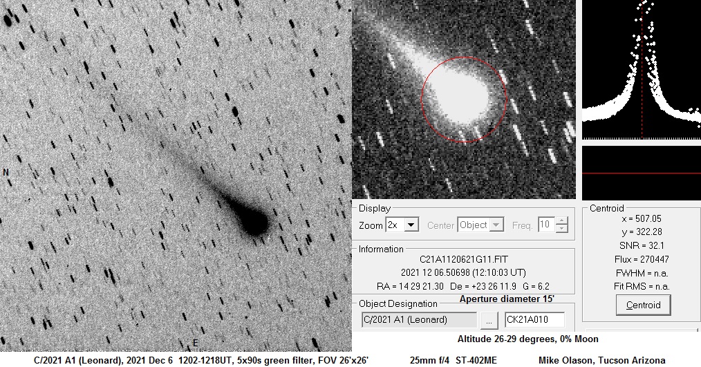

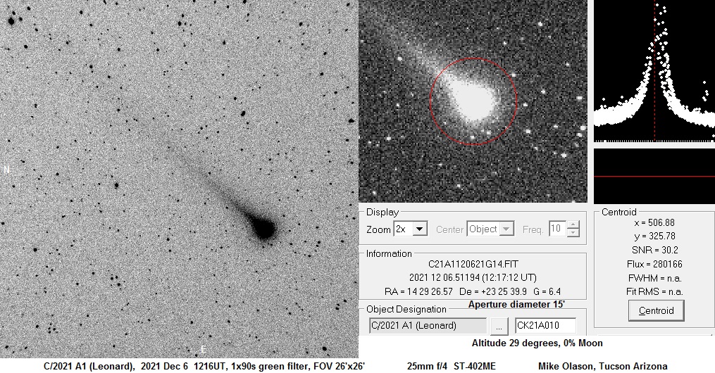

90 second green image and 5x90 second green image taken the morning of 2021 Dec 6 from altitude 26-29 degrees. Astrometrica calculated G=6.4 and 6.2 respectively with an aperture diameter of 15'. Since the coma is wider than 15' one would assume the comet is a little brighter than these results. ****A few days after I posted these images I realized that the FOV was wrong on the images, the correct FOV for both images is 2.6x2.6 degrees, not 26'x26'.****
2021A1_20211206_1216_molason.jpg [ 304.54 KiB | 30264 mal betrachtet ]
2021A1_20211206_1202_molason.jpg [ 294.59 KiB | 30264 mal betrachtet ]
Cheers, Mike
:lol: Arizona
Zuletzt geändert von Mike Olason am 10. Dezember 2021, 09:21:22 AM, insgesamt 1-mal geändert.
