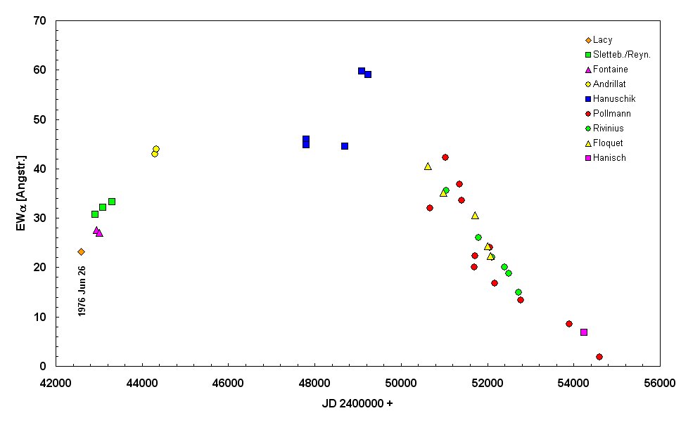

Hallo Thomas!
Gemäß meinem letzten Spektrum von 66 Oph (Anhang) scheint der Stern kurz vor dem Totalverlust seiner Scheibe zu stehen.
Wenn dieser Status erreicht ist, wird es wohl das erste deutliche EW-Minimum sein, dass bisher in Halpha beobachtet werden konnte.
Soweit die Literatur nach meinen Recherchen Auskunft gibt, datiert die früheste Messung von Lacy auf 1976. Davor scheint keine Minimumsbeobachtung vorzuliegen.
Mein Frage nun an dich: kannst du durch eigene Messungen diesen aktuellen Trendverlauf bestätigen?
Beste Grüße,
Ernst

 Betreff des Beitrags: 66 Oph
BeitragVerfasst: 14. Mai 2008, 20:01:47 PM
Dear colleagues!
The continuous decrease since years of the Halpha EW of the star of 66 Oph may be a sign of total loss of its disk soon (see the attached plot).
My question is, exist there EW measurements which would be helpful to complete the plot ?
If yes, it would be great to send me it!!!
It seems, this is the first time, that we observe a real minimum in Halpha for this star.
Thanks in advance...
Ernst Pollmann
Halpha.jpg [ 41.05 KiB | 7267 mal betrachtet ]

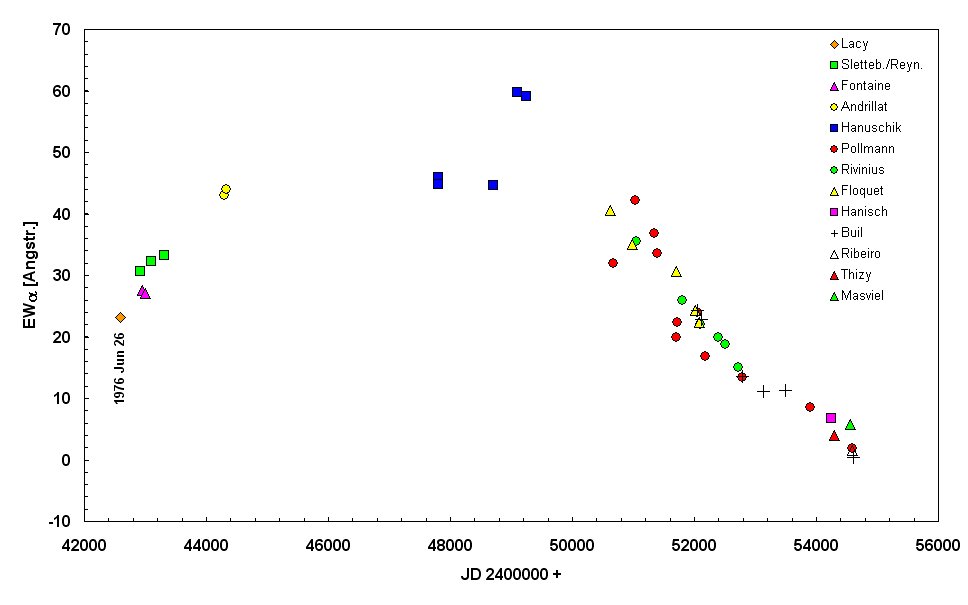

BeitragVerfasst: 15. Mai 2008, 11:30:41 AM
Dear Christian, Jose and Olivier,
thanks a lot for your quick supply of EW measurements.
Olivier, you are right of course. Monitoring of V&R, both intensity and distance, sometimes deliver informations regarding disk stability. And indeed there is enough examples of Be stars, which show this.
However in a first overview in this case, both the intensity and distance of the peaks seems to be fairly equal on the way of the decreasing branch.
All the other spectra in BeSS, I will evaluate during the next days. But let me give you a first impression about our amateur contribution in this high interesting case.
This excellent example shows among others the advantages of co-operation between our groups.
It will be interesting to observe the development during the next months and whether the emission will disappear complete.
The wavelength section I used for evaluation of EW is between 6558-6566 Angstr.
An important aspect in my point of view would be a comments regarding our amateur contribution for professionals (like M. Floquet and Th. Rivinius for instance).
Best wishes,
Ernst
66oph.jpg [ 44.25 KiB | 7255 mal betrachtet ]

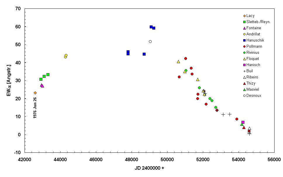

Hi Jean-Pierre,
many thanks for your spectrum.
I normalized it for the EW evaluation with the program MK32.
As you can see at the attached plot, the EW (6558-6566A) is in fairly good agreement with the current trend behavior.
It would be wonderful if you could contribute measurements for the next weeks too.
Best wishes,
Ernst
66oph.jpg [ 44.99 KiB | 7235 mal betrachtet ]
BeitragVerfasst: 18. Mai 2008, 16:26:43 PM
Dear Ernst,
A new spectrum of 66 Oph taken last 16th.
Best regards
Jose
Dear Jose,
I did its EW together with a one of Valerie (I found it in BeSS) into the monitor plot (attachment).
There is obviously still "rests" of the disappearing disk. I am curiously, when the time of total loss is coming....
A note for Valerie:
your BeSS-spectrum fits very good to the measurements of R. Hanuschik.
Best wishes,
Ernst
66_Oph.jpg [ 45.44 KiB | 7196 mal betrachtet ]
BeitragVerfasst: 19. Mai 2008, 17:22:30 PM
Registriert: 17. Dezember 2006, 14:02:51 PM
Beiträge: 69
Hi,
Ich hab' leider keine neueren Daten als die gruenen Punkte in Deinem Plot,
aber ich bin demnaechst am Teleskop. Vielleicht hab' ich 'ne Chance den Stern
einzubauen.
Alles in Allem hab' ich aber keine Zweifel, dass der Niedergang echt ist und
der Stern langsam seine Scheibe verliert. Zeitskala und Profil stimmen mit
dem ueberein, was ich sonst so gesehen habe in derartigen Phasen.
Ich bin gerade in den USA bei einer Theoriegruppe (letzte Woche war Urlaub,
sorry fuer die verspaetete Antwort) und wir haben untere anderem darueber
gesprochen, wie man so einen Niedergang modellieren koennte. Vielleicht kann
ich mit diesen Daten den Appetit der Theoretiker anregen, das mal zu rechnen.
Danke,
Rivi
