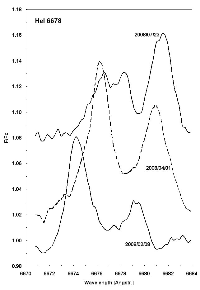

The He emission lines 6678 in delta Sco exhibit considerable changes between
February and July this year (see attachment):
1. change of the V/R ratio from V<R to V>R
2. change of the radial velocity of both peaks
Question:
Is there someone who can confirm this ?
Is there someone who is able to explain that phenomenon ?

Behavior_HeI6678_in_delta_Sco.jpg [ 58.58 KiB | 3425 mal betrachtet ]

Hi,
based on interferometric measurement from the GI2T, we estimate the
size of the
emitting region in He6678 to be 2.3 R* (<8.5 R* in Hbeta and 18 R* in
Halpha) for gamma
Cas see Stee et al. 1998, A&A, 332, 268.
Thus He 6678 must originate very close to the star's surface. I would
favor its formation
thanks to a recent outburst in an rotating ring not centred on the
central star...
Is the double pics separation of He 6678 close to its vsin i ?
You may also have a look to our recent paper on Achernar which try to
explain the relation
between the line intensity and the double peak separation see:
Kanaan et al. 2008, A&A, 486, 785
Cheers,
Phil

Has the width between the peaks of the HeI 6678 line changed, Ernst?
...here the distances related to λ0 (6678.149) in km/s:
2008-02-02 > 230
2008-04-01 > 230
2008-07-23 > 190
What is the background of your question?

Von: "Philippe Stee" <Philippe.Stee An: <BE-STARS Betreff: Re: He lines in delta Sco Datum: 27. Jul 2008 22:54
Hi Ernst,
the important point is not really the change of the radial velocity of both peaks but rather
the change in the peaks separation.
Event if it is more difficult to estimate the peaks separation for the 2008/07/23 spectrum
(since the profile appears not really double peaked but rather with 3 peaks) it seems that
the peaks separation taken 2008/07/23 is larger that those for 2008/04/01 and 2008/02/08
this is exactly what must be observed if the He6678 line is emitted in a rotation disk or ring
that is slowly expanding from the central star.
When it is ejected from the stellar surface its rotational velocity must be close to the stellar photosphere
rotation, i.e. close to the vsini of the star which is about 165-175 km/s (from Simbad) than if the disk or
ring is expanding and assuming a Keplerian rotation, its rotational velocity must decrease
(as a function of the radius ^(-0.5)) and thus the double peaks separation must decrease
as well as a function of time.
If you told me that for 2008/07/23 the double peaks separation is about 190 km/s, this is very
close to the vsini of the central star and this is another evidence that He6678 was just formed
and ejected from the stellar photosphere, maybe thanks to a recent "outburst".
The problem I see is that you also told me that for 2008/04/01 and 2008/02/08 the double
peaks separation is 230 km/s which is unlikely since it should be smaller that 190 km/s...
On the other hand a possible explanation is that we just see the disk/ring expansion as a function
of time and thus the double peaks separation is also decreasing as a function of time (from 230
km/s to 190 km/s) and should still decrease till it will be diluted and will be no more observable.
In the hypothesis, the vsini of the central star should be at least 230 km/s but it would not be the first
time that the true rotational velocity is underestimated (for instance the inclination angle i is
usually poorly estimated).

Dies geschieht in immer gleichbleibender Position des Teleskops plus Spektrograph (im Cassegrainfokus) an Teilkreisen: im Meridian bei Deklination: -30° (delta Sco: ~ 23°)
So ist es mir heute möglich, die Kalibrationsgenauigkeit, hier (zunächst) ausgedrückt als Wiederholgenauigkeit der Dispersion (in Angstr./Pix) im Kalibrationsspektrum, für den fraglichen Zeitraum (02/2008-07/2008) zu dokumentieren:
0.245086 0.245303 0.245086 0.244000 0.244761 0.244491 0.244882 0.244285 0.244411 0.244594 0.244306 0.244110 0.244702 0.244922 0.244410 0.243275 0.246268
Die Standardabweichung vom Mittelwert (0.24469719) beträgt danach 0.00062861 (= 0.25689 %)
Mit dieser Dispersionsgenauigkeit wird ein jeweiliges delta Sco-Summenspektrum in Wellenlänge skaliert. Vergleiche der gemessenen Wellenlängen der Wasserdampflinien (hier verwende ich die Wellenlängen der UVES-Spektren von Herrn Hanuschik aus 2006) mit diesen UVES-Wellenlängen, führte bisher zu einer Standardabweichung zwischen 0.0039 - 0.015 Angstr.
Die Größenordnung dieser Standardabweichung bei der Bestimmung der Wellenlängen der HeI6678-Linien liegt somit deutlich unterhalb des gemessenen Verschiebungsbetrages (zwischen 2008/02/08 und 2008/07/23) von 2.2 Angstr.
Beste Grüße,
Ernst Pollmann

Z.Zt. wird ein Beobachtungsergebnis von mir - Hel6678-Emissionen in delta Sco - in der Be-Star-Mailingliste diskutiert.
U.a. geht´s dabei um den Verschiebungsbetrag (Radialgeschwindigkeit) der Doppelpeakemission (siehe Anhang).
Herr Dietrich Baade (ESO) schrieb nun in diesem Zusammenhang:
man kann zur genauen Bestimmung von Verschiebungen als sehr bequemes Werkzeug eine Kreutzkorrelationsfunktion berechnen.
Da diesbezüglich meine mathematischen Kenntnisse wie Möglichkeiten begrenzt sind, würde ich dich fragen wollen, inwieweit du hier behilflich sein kannst.
Beste Grüße,
Ernst
Behavior_HeI6678_in_delta_Sco.jpg [ 58.58 KiB | 3397 mal betrachtet ]

Weil ich weis, dass es unter den Forumslesern einige Teilnehmer gibt, die durchaus an Interesse daran haben, hinsichtlich des Themas im Betreff auf dem Laufenden zu bleiben, leite ich die jüngste Stellungnahme von Th. Gandet aus der Be-Star-Mailingliste hierhin weiter:
Mustn't any model take into account the multiple
components of the emission lines? Looking at the spectra, it seems a difficult probalem
to determine what is a separate "ring" and
what are V/R components of other "rings".
Measurements of the separation of the peaks
may provide a way of sorting that out.
If we are seeing rings, each will rotate at
a somewhat different velocity. If a disk
is involved, then the changes will tell if
the disk is expanding or collapsing.
There seems to be two physical effects
going on in Delta Sco, yes? One is the
ejection of material from the photosphere,
the other is the formation of "blobs" of gas
in the disk or ring(s) 9probably from viscosity
affects?). The blobs then rotate in a more or
less Keplerian fashion, eventually to fall back
closer to the star.
About the orbit: the orbit inclination is
not well determined - values between 20° and
48° are in the literature. The only directly
observed value of it, from interferometry,
depended primarily on incomplete coverage of the
orbit because of the high eccentricty and long
period.
There also remains a lot of uncertainty about the
orbital eccentricity, which will affect the
periastron distance. It would be good to have i
and e better constrained!
Would the periods and modes of nrps be affected
by the secondary at periastron passage? There
would have to be a change in gas denisty in the
photospher, is that correct? My question is
a separate one from whether the nrps contributed
to the disk formation.
Sorry for the long posting and probably dumb
questions!
There is a very interesting set of spectra
that shows the changes in various lines in
Delta Sco between 1995 and 2006. H-beta
and HeI 5876 are shown, and it's interesting
to compare them with Ernst's recent profiles.
The paper is by Galazutdinov and Krelowski,
in ApJ, 2006, 637, 342.
Cheers,
Thom Gandet

Hallo Ernst,
hier die Ergebnisse meiner Auswertung im Anhang
als Excel-File. Ich habe sowohl die Halpha- als
auch die HaI6678-Emissionen mit SpecRaVE (also
Gaußfit) und Kreuzkorrelation (KK) ausgewertet.
Alle Ergebnisse sind von der Erdbewegung befreit,
also heliozentrisch. Da die KK nur
Geschwindigkeitsänderungen gegenüber einer
Referenz liefert, habe ich alle Werte einheitlich
auf dein erstes Spektrum JD=2454505.3 bezogen.
Beide Methoden reagieren natürlich auf etwas
unterschiedliche Weise auf Profiländerungen,
dennoch zeigen sie die gleichen Tendenzen. Mehr
würde ich erstmal nicht herauslesen wollen, da
man aufgrund der wenigen Messpunkte noch keine
Aussagen über die Streuung treffen kann.
Herzlicher Gruß
Roland
