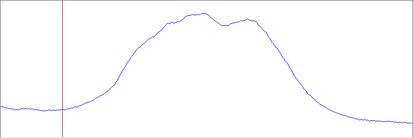

Hi,i began to explore the results of my Dec 12th observing session.
Here is a presentation of the HeII 4686 lines extracted from one order of a eshell spectra at different exposure. Conditions were perfect, 80°high, good seing, easy to guide. The prelimary conclusion are that my echelle setup (C14, ST10XME, eshell, R10000 disp 0.1A), cannot reach SNR200 in 1H. It is more near 20 for 2H40 exposure.
 But the line is well resolved, easy to spot, the continuum is intense and so, such SNR should not be required for a Rv study. Small change in the profile should be evident too. It would be usefull, for better setup choice, to explain why such SNR is required ?
http://gabalou.canalblog.com/archives/2 ... 66856.html
Thierry

20111212-173246-wr134-3x1200s_tgarrel_bin4.png [ 6.75 KiB | 13360 mal betrachtet ]
20111212-173246-wr134-3x1200s_tgarrel_Bin4.fit [8.44 KiB]
520-mal heruntergeladen
Thierry Garrel

Comparison between under sampled spectra and original. Not very confident on what under sampled spectra will show.
2011/12/14 thierry Garrel <fg-spek-convento@vds-astro.de (fg-spek-convento@vds-astro.de)>
re sampling to 0.5 does not support the resolution anymore, it is conditions of  under sampling spectra. You don't know what your spectra would show.The HeII line is quite large and support a strong undersampling with some profile modification, like tiny features may disappear or not depending of the loss of point of profile. With the 1h exposure, SNR get from 17 to 24 by re sampling the dispersion of a factor 4, at 0.4A (R=0.5A at 4686). I don't like it  much and no significant advantage in term of SNR.
T

20111212-173246-wr134-3x1200s_comp_Bin4.png [ 21.96 KiB | 13359 mal betrachtet ]

BeitragVerfasst: 14. Dezember 2011, 23:42:41 PM
Hi Thierry,
The required resolution is only 1A, not the eShel native resolution so we can resample at 0.5A and still match the required resolution (or alternatively filter the original spectrum) I checked the SNR in your 6x1200 sec spectrum in the region 4721-4739A (after removal of the "continuum" and got SNR 48 before resampling and 90 after resampling.

BeitragVerfasst: 14. Dezember 2011, 23:54:20 PM
Attached is the continuum removed region, raw (SNR 48) and with a 5 sample running mean filter (SNR 100). The problem is improving from 100 to 200 SNR will need at least 4x the number of photons ie 4 hours exposure even without the extra camera noise.

Sent: Wednesday, December 14, 2011 9:15 PM
Subject: [fg-spek] Re: ProAm campaign in 2013 - Technical aspects
T
2011/12/14 Robin Leadbeater )vds-astro.de (fg-spek-convento(==>)vds-astro.de ([email]fg-spek-convento(==>)vds-astro.de[/email]))>
: Yes indeed,
Thierry, try resampling your spectrum at 0.5A/bin and see what SNR you get. (Binning vertically will not help much because the pixels are already summed vertically, just a small improvement if it is done in camera due to the reduced number of read noise doses but this is very marginal)
----- Original Message -----
From: Daniel Sablowski (fg-spek-convento(==>)vds-astro.de ([email]fg-spek-convento(==%3E)vds-astro.de[/email]))
To: fg-spek-convento(==>)vds-astro.de ([email]fg-spek-convento(==%3E)vds-astro.de[/email]) (fg-spek-convento(==>)vds-astro.de ([email]fg-spek-convento(==%3E)vds-astro.de[/email]))
Sent: Wednesday, December 14, 2011 7:55 PM
Hi Thierry
Because of your dispersion of 0,1 A/pix you could binn by factor 5, and if you do this also perpendicular to the direction of dispersion you will get a factor of 25^0.5 = 5 in SNR (maybe) . . .
If the detector is oversampled you will not lose much resolution but I think it is only an resolving power of 5.000 needed.
Daniel Sablowski

Thierry Garrel
TG_6x1200_raw_0.5runmean.png [ 4.31 KiB | 13357 mal betrachtet ]
BeitragVerfasst: 15. Dezember 2011, 00:00:03 AM
48*5^0.5 = 107
90/48 = 1,88
so, the theory for best SNR fits nur exactly (85 %, this is noise).

BeitragVerfasst: 15. Dezember 2011, 00:27:09 AM
Yes it is all fitting together as expected. Meeting the required specification is going to need ~0.5m aperture. If we are to get many amateurs participating we will either need a relaxed specification or, as Fil suggested, the results of several (typically 4) observers combined.
----- Original Message ----- From: Daniel Sablowski (fg-spek-convento@vds-astro.de)
Sent: Wednesday, December 14, 2011 10:00 PM
48*5^0.5 = 107
90/48 = 1,88
