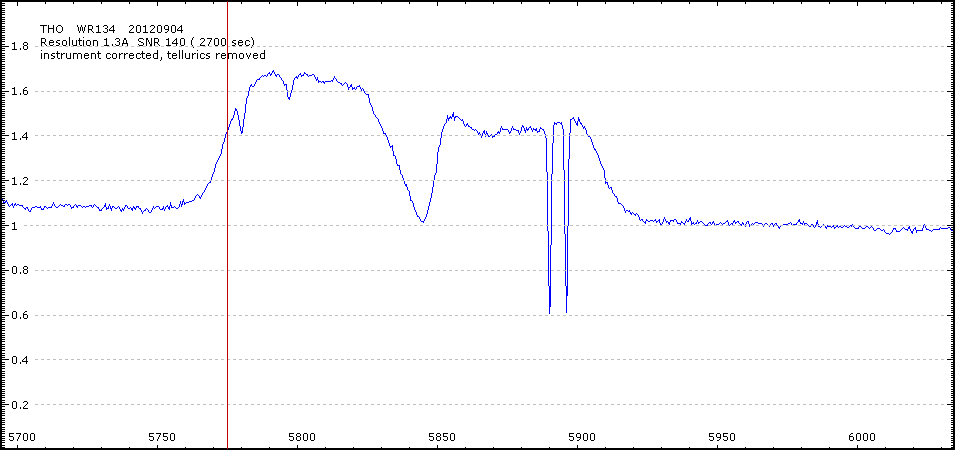

Hello all,
Here are my test spectra for WR134/135
C11 (280mm)
LHIRES III 1200l/mm 35um slit
ATK 314L+ (2x binning)
resolution 1.3A
SNR 160 in 1 hour
wavelength precision ~5km/s
As I suspected, I cannot quite reach the specification from my sea level observatory. I would need ~0.5m aperture. If this quality useful however I can contribute to the campaign next year.
wr134_20120904_necal_respcor_telrem.png [ 16.6 KiB | 14145 mal betrachtet ]
wr135_20120904_necal_respcor_telrem.png [ 15.35 KiB | 14145 mal betrachtet ]

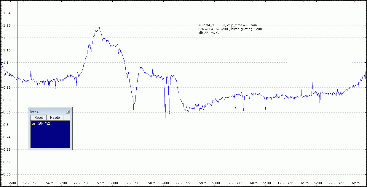

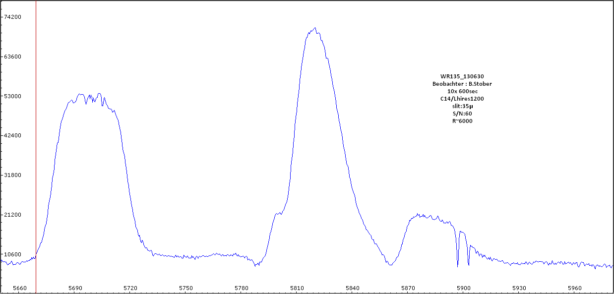

BeitragVerfasst: 10. September 2012, 12:28:14 PM
helleo Robin,
after having done exactly as you said, now.....now I have also a somewhat usefull result, I think......my spectrum is not so good as yours but it is of comparable quality in my eyes. What do you mean?
So I hope and I think that I can reache an exp. time from 60 min. , if I use the C14.......then all the given conditions are considered......:-)
cheers berthold
the weather here becomes bad for the next days....:-(
(PS : the accuracy of callibration is not so good, as I see.....I have to use sms in the next days)
sum_wr134_120909_cal_norm2.gif [ 20.08 KiB | 14040 mal betrachtet ]

Hello Berthold,
helleo Robin,
cheers berthold
To me, it looks like a great improvement.
Torsten

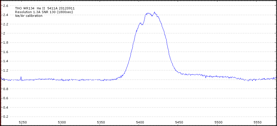

 Betreff des Beitrags: WR134 HeII 5411A 20120911

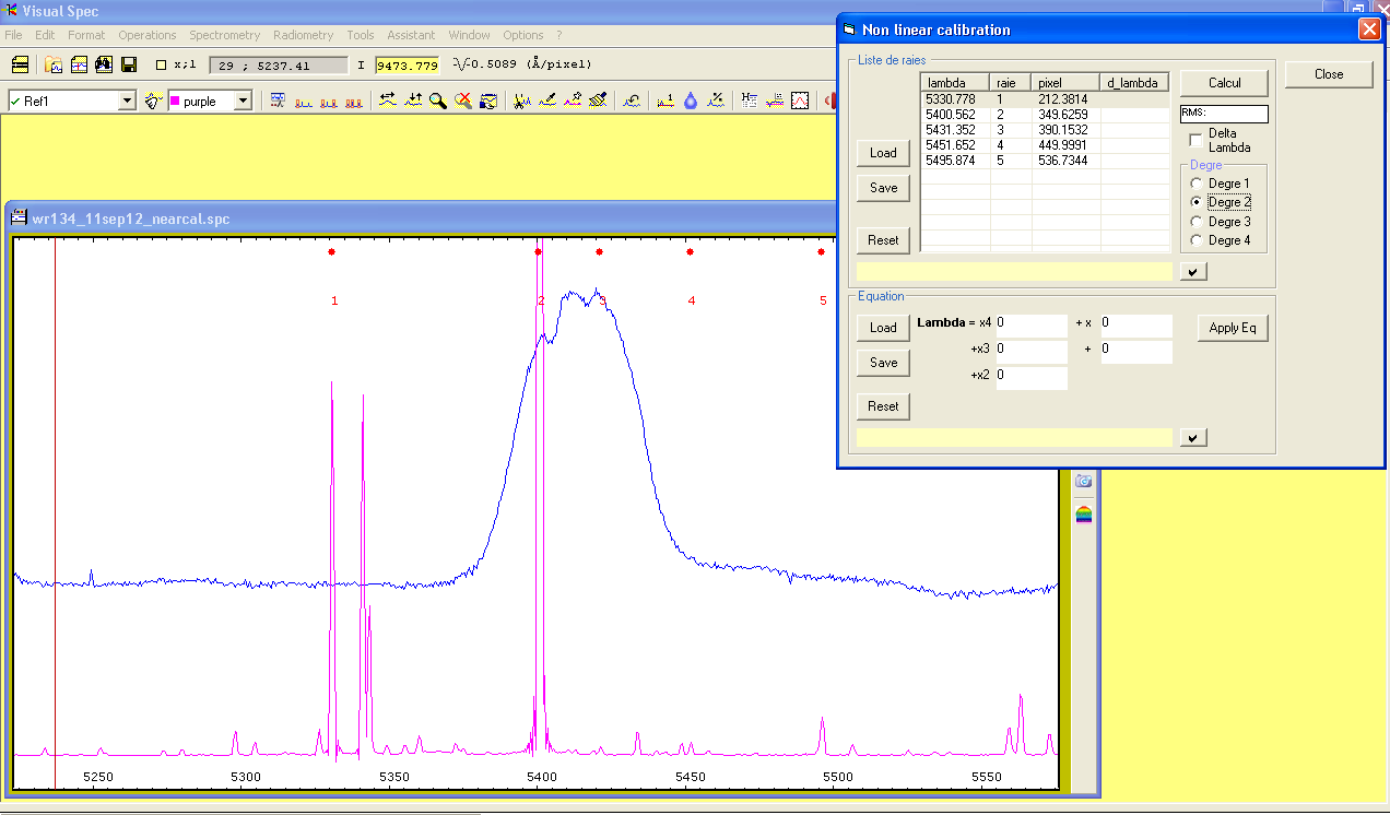

BeitragVerfasst: 13. September 2012, 18:57:51 PM
Here is the WR134 HeII 5411A line taken 20120911
Exposure was 30 min (limited by clouds) SNR 120 resolution 1.3A
wavelength was calibrated using Ne and Ar lines in LHIRES internal neon lamp
5330.778 Ne
5400.562 Ne
5421.352 Ar
5451.652 Ar
5495.874 Ar
A second order fit gave an RMS residual of 0.03A
Next step is to repeat this to see if variations can be detected
wr134_HeII_5411A_THO_20120911.png [ 13.96 KiB | 13980 mal betrachtet ]
BeitragVerfasst: 13. September 2012, 19:40:57 PM
Exzellent Robin!
so far in the blue part of the spectrum I have no calibration lines in my lhires. I have only a neon lamp in my lhires.....the sky here is cloudy at time....
Cheers Berthold

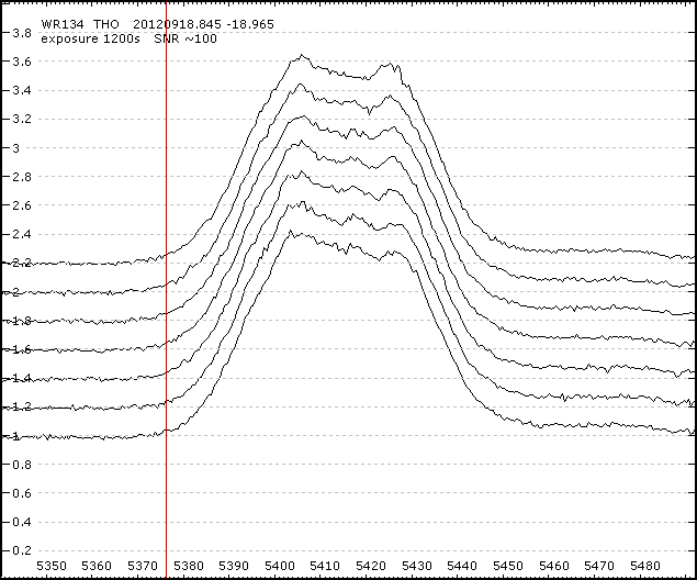

BeitragVerfasst: 20. September 2012, 03:08:12 AM

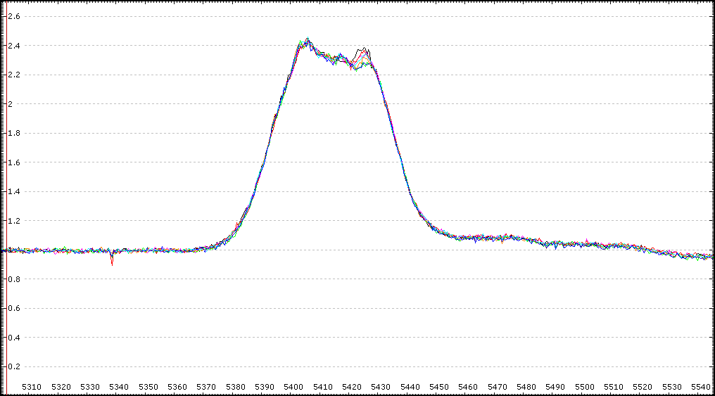

Here is a series of 20min exposures covering 3 hours on 20120918
The SNR is ~100 in each exposure. There are obvious changes on the line top even over this short time, particularly on the red edge.
wr134_he5411_20120918_nearcal_norm5345-5365.png [ 21.34 KiB | 13843 mal betrachtet ]
BeitragVerfasst: 20. September 2012, 03:47:10 AM
Beiträge: 101
Wohnort: Montreal
Hi Robin:
Looks very nice. However, I think you need a bit more S/N to get rid of the short-scale noise that could prevent clear detection of clumps. That?s why I had said S/N about 200, although 160 may be OK in 1 hour.
Best, Tony

BeitragVerfasst: 20. September 2012, 04:26:25 AM
Hi Tony,
Yes these are just the sub exposures that will go to make 2 spectra of 1 hour exposure each. I was interested to see however that significant changes were detectable at 100SNR and even within < 1 hour. Attached is the same spectra overlaid showing how the envelope widens at the red edge of the line compared with elsewhere.
wr134_he5411_20120918_1_nearcal_norm5345-5365_overlaid.png [ 21.93 KiB | 13835 mal betrachtet ]

BeitragVerfasst: 20. September 2012, 09:23:37 AM
Hi Robin, Tony!
The whole line seems to be slightly shifted towars larger wavelenths. What might that be?
Second, clumping should be visible all over the line peak. Here we see variability only in the red peak whereas the blue side is more or less stable. I miss the outward moving sub-features.

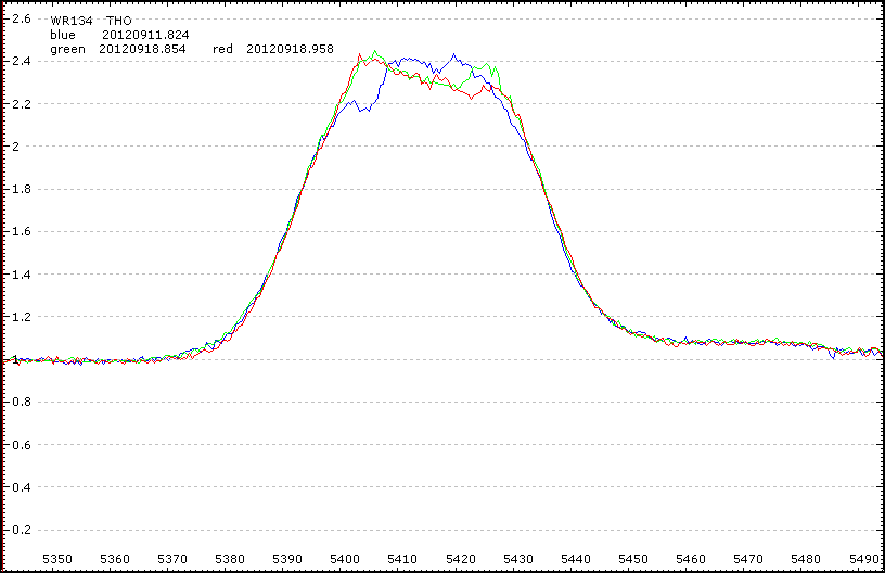

BeitragVerfasst: 20. September 2012, 12:30:04 PM
Here is my previous result from 20120911 overlaid on the first and last spectra from 20120918
wr134_he5411_20120911-18_nearcal_norm5345-5365.png [ 16.61 KiB | 13815 mal betrachtet ]
BeitragVerfasst: 20. September 2012, 13:08:02 PM
Hm, we probably need much more data to identify specific phenomena. Clumping is visible within minutes to hours. So, the single night observations should also show blue wing activity. But the absence might be a stochastic effect (or CIR activity). Too difficult to say with only some spectra. Anyway, your observations obviously show what you can already do with a C11. It is at our parameter threshold but it works.
Cheers, Thomas
BeitragVerfasst: 20. September 2012, 16:10:40 PM
Beiträge: 101
Wohnort: Montreal
Hi Thomas:
WR emission lines tend to be redshifted (it?s part of the line-formation mechanism), sometimes by over 100 km/s. Plus the star could be moving at some positive speed relative to us.
WR134 is dominated by quasi-periodic CIR motion, so the clumps play a secondary role, although they should still be visible. Perhaps one also needs a longer data string (i.e. more than 3 hours; 6+ better). See http://iopscience.iop.org/0004-637X/514 ... 60.web.pdf Fig.1.
We should also compare WR134 with WR135 and WR137 (also in the above paper, but for WR135 see also the best spectroscopic paper ever on any clumped star: http://iopscience.iop.org/1538-3881/120 ... 56.web.pdf . Here we have 3 intense successive nights on two 4m class telescopes (WHT, CFHT, with some cloudy periods!). This is great of course, but we need much longer time coverage to build up better statistics of the clumps and check for a hidden periodicity (e.g. due to weak CIRs), so that?s why we launched this 4-month campaign. But it is important to get adequate coverage each time one observes each star, i.e. at least 4-5 hours with at least 3 good spectra (S/N > ~200). But preferably all night for over 6 hours with even more good spectra, when possible. That?s also why it would be good to have people spread around the globe doing spectroscopy, to fill in the time gaps that one gets from only one site.
Cheers, Tony

BeitragVerfasst: 20. September 2012, 16:12:14 PM
Beiträge: 101
Wohnort: Montreal
Very nice, Robin! The changes are quite evident, while the line flanks remain ~ constant.
Tony

BeitragVerfasst: 20. September 2012, 16:16:05 PM
Beiträge: 101
Wohnort: Montreal
Clumps can show changes over 10?s of minutes, not minutes. But you really don?t see much happening normally until you wait for about an hour. There are some exceptions, though, e.g. weak emission-line stars where we see the fast-accelerating inner part of the wind.
Also: some lines show little if any P Cygni absorption edges, so their extra blue-wing activity is absent.
Tony

Excellent Robin!
Von meinem iPad gesendet
Am 20.09.2012 um 12:30 schrieb Robin Leadbeater <fg-spek-convento@vds-astro.de (fg-spek-convento@vds-astro.de)>:
<wr134_he5411_20120911-18_nearcal_norm5345-5365.png>

BeitragVerfasst: 06. Juli 2013, 19:36:42 PM

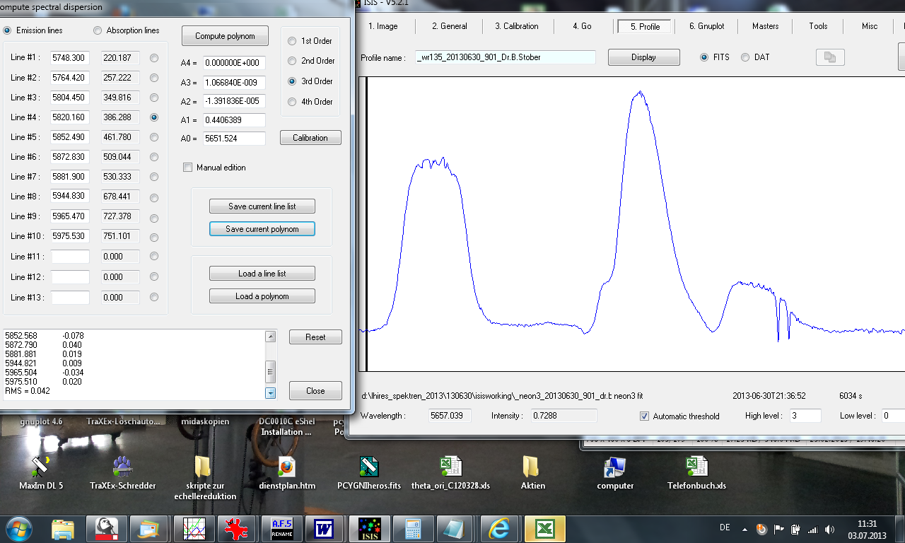

Hello Robin and all others
here my result from 300613 of WR135,
cheers berthold
WR135_130630_RMS=0,04.png [ 404.9 KiB | 11074 mal betrachtet ]
WR135_130630.png [ 16.35 KiB | 11074 mal betrachtet ]
_wr135_130630_20130630_901_Dr.B.Stober.fit [14.06 KiB]
316-mal heruntergeladen
