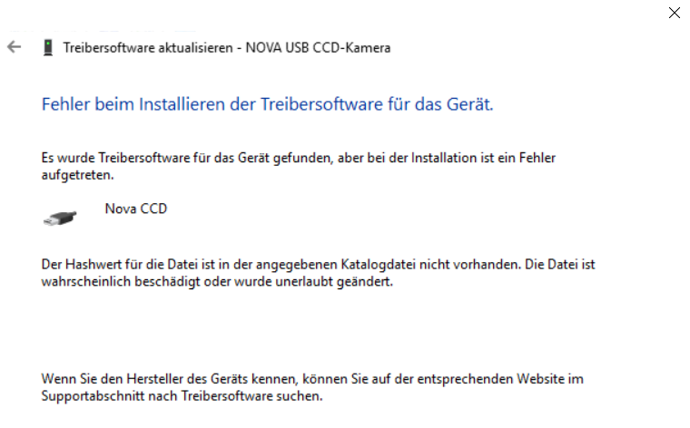

The recent attempt w/ new drivers under Win10 ended w/ the attached message. Quite close but not the final target yet. Nevertheless, seems to be correctable if one knows what to do ;-) May be Emil has a new and brilliant idea?!
Regards
SigmaNovaTreiber.PNG [ 56.56 KiB | 5755 mal betrachtet ]
