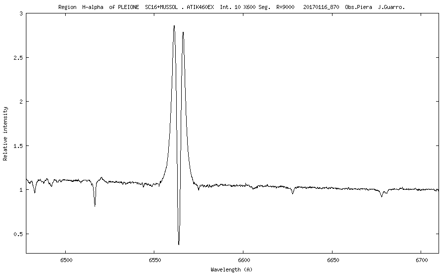

BeitragVerfasst: 19. Januar 2017, 12:03:11 PM
Wohnort: PIERA ( Barcelona )
Hallo Christoph:
Possibly Robin is right, your graphic Pleione can be deformed by some artifact.
I have no observations 20160115. spend the nights 14 and 16.
Cheers, Joan.
_pleione_20170116_870_J. Guarro.png [ 5.9 KiB | 21144 mal betrachtet ]
_pleione_20170114_833_J. Guarro.png [ 5.84 KiB | 21144 mal betrachtet ]

BeitragVerfasst: 19. Januar 2017, 12:55:43 PM
I'm not sure, I think Christoph would have to return to observe the star, exactly the same instrument. We could then see what happens.
It would be fantastic, that Christoph's observation a reality.
The Ernst Pollmann, many years ago that follows the evolution of the star. He knows very well. Could you give your opinion.
Greetings, Joan.

BeitragVerfasst: 20. Januar 2017, 13:06:28 PM
Hmm, 27 Tau? :roll:
BeitragVerfasst: 20. Januar 2017, 13:27:16 PM
Beiträge: 229
There might be a chance...?!
I will going to reduce stacked data of the bright star later. Perhaps it is better for identifying.
Christoph
BeitragVerfasst: 20. Januar 2017, 14:10:40 PM
Ah OK. That makes sense. So is this is a slitless spectrograph? (Can you remind me of the design Christoph?)
27 Tau is the bright star in the image and shows H alpha in absorption as expected (it is not Be) and as it appears in Buil's image.
28 Tau is above it. The central emission is clear in the image but this is very surprising as Joan's spectra taken the day before and the day after do not show any central emission or any variation at all!
The only other suggestion i have is that you are getting a double image. (I think Uwe saw this with a sample of the Star Analyser 100 grating used at high resolution) This could make the 2 emission peaks look like 3. Perhaps you could try measuring a star with a single narrow emission line to check?
BeitragVerfasst: 20. Januar 2017, 14:50:24 PM
Hi Robin, I wouldn't expect it to be a double image because the other spectral features are all single. Christoph, you should check again, anyway.
Cheers, Thomas

BeitragVerfasst: 20. Januar 2017, 17:28:13 PM
Hello all:
Attach a pdf 28Tau the star, where it sees the "slow" evolution of H-alpha from 20011029 to 20131112. The data are the BeSS.
I also want to say that from the year 2008 I regularly observe this star, now bring 250 of the H-alpha spectrographic observations of the Tau 28. I've never seen any changes compulsive.
Changes in the H-alpha always been soft. I speak as an observer, not a theorist.
In short, and nobody gets upset. It may well be that the graph of the H-alpha 28Tau it's true, but I do not believe it.
Friendly, Joan.

BeitragVerfasst: 20. Januar 2017, 18:24:43 PM
Hello Cristoph,
My Data are from two days, the 15. and also like Joans from the 16.
Ah yes, I missed the date on the first one. So we have your and Joan's spectra both taken on 16th.
http://forum.vdsastro.de/download/file.php?id=6722
http://forum.vdsastro.de/download/file.php?id=6724
If the change is real it must be very fast then. There is also perhaps some emission in the line at ~6460A in your spectrum? (But of course this could be real or an artifact too. The problem with slitless spectrographs is that each line has the shape of the star image). What was the time of your observation on 16th ? How close in time to Joan's was it ?

BeitragVerfasst: 20. Januar 2017, 21:51:39 PM
Beiträge: 229
Me again,
Ernst Pollmann asked me to copy the following text in this thread:
Dear colleagues
our ARAS monitoring program don't show such a dramatical changes, how it is suggested by the (incorrect) spectra comparisons here in this forum.
One of our monitoring partner (Olivier Garde) sent me right now a new spectrum of yesterday.
It says, the typical profile characteristic is unchanged (as expected).
I hope that this will help, to understand, that the confusion came from the Be star eta Tau (instead of 28 Tau), taken by Christoph.
Ernst Pollmann

BeitragVerfasst: 20. Januar 2017, 22:57:45 PM
Hello Christoph,
Ernst's suggestion that you have measured eta Tau is not correct. There is no evidence that you have the wrong star. (Certainly not eta Tau). The two stars in your image agree with the relative positions and brightness of 27 Tau and 28 Tau. I agree that it is very unlikely that what you see in your spectrum is real. We do not have an explanation though.
BeitragVerfasst: 20. Januar 2017, 23:12:29 PM
Christoph,
Here is the latest H alpha spectrum of eta Tau in BeSS. The profile shape does not match the one in your spectrum (the emission line in eta Tau is inside a clear wide absorption line. This is not the case in your spectrum.) This confirms that you did not measure eta Tau by mistake.
sp_0130695.png [ 3.02 KiB | 21019 mal betrachtet ]
BeitragVerfasst: 20. Januar 2017, 23:26:12 PM
At the 16th I took the data from 18:50 till 19:20.
OK this is ~2 hours before Joan took his "normal looking" spectrum.
What you saw was repeated on 2 days though. You must go back to the same star again and tell us what you see. This is good fun :D

BeitragVerfasst: 21. Januar 2017, 12:36:21 PM
Hello all,
Ernst Pollmann Include this text in this conference.
"The here discussed triple peak emission (in the slit less spectra) results from mistakes in guiding in declination.
Intermittent correction in that axis did lead to a displacement of the emission components in dispersion direction. Nobody can expect that the real profile of the eta Tau spectra will be recognizable, when such massive mistakes occur. As Christoph itself wrote at the beginning: the mounting EQ 5 did not work very well.
Ernst Pollmann"
I think that is a good point of view, so if Christoph wants to repeat the observation must also keep false, the equatorial mount.
Beware, the spectrograph of Christoph has no slit !! It's has too many things on the counter. I do not give more laps.
Friendly, Joan.

BeitragVerfasst: 21. Januar 2017, 14:44:44 PM
Joan!
It might be that Christoph did not guide perfectly well. It is up to him to test his procedure again. But he certainly does not make „massive mistakes“ (this is really not my wording). He is still learning and on his way to become a good observer. And it might be that we all do not know what we are talking about. But we, including Christoph, want to learn from each other and surely make „mistakes“ by doing so. However, all these mistakes help us to learn more and go through this difficult subject.
Cheers, Thomas
BeitragVerfasst: 21. Januar 2017, 14:45:09 PM
Hello Joan,
Yes I agree. Guiding errors could certainly cause the problem in this slitless spectrum. Your spectrum taken within 2 hours of Christoph's is enough proof for me that Christoph's spectrum is not correct. It is curious how well the incorrect spectrum shape was repeated on two nights though. I am not convinced that we have got to the real cause of the problem but perhaps we never will. :(
BeitragVerfasst: 21. Januar 2017, 17:31:55 PM

First the profile was as expected. Then I begun to play with the parameters of the MGen and was able to reproduce the error by choosing a high tolerance for triggering a guide-impulse. I used only the EQ5 for the Test.
So we can really say, that the error was caused by the bad tracking.
Thanks for your help! Also Ernst Pollmann. One step forward :D ! I never thought, that spectroscopy is so vulnerable for any influences :oops: .
One night later unfortunatly the screw of the Dovetail Clamp broke and the whole Setup dropped to the ground. For luck, nothing was really damaged. But I have to readjust the Setup.
Greetings
Christoph
BeitragVerfasst: 05. Februar 2017, 17:51:57 PM
Very well, Christoph! As you said, one step forward.
I never thought, that spectroscopy is so vulnerable for any influences.
Spectroscopy is not more vulnerable than imaging. For both cases, you need to guide well for longer exposure times.
