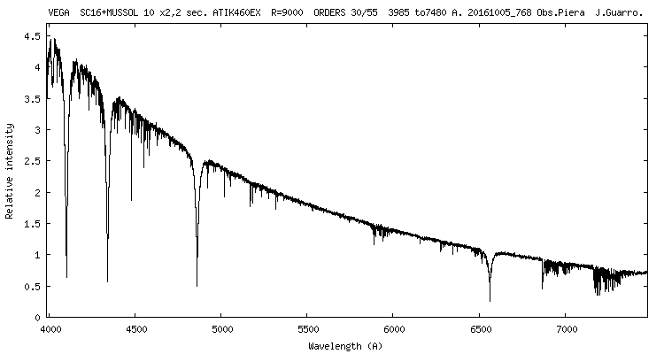

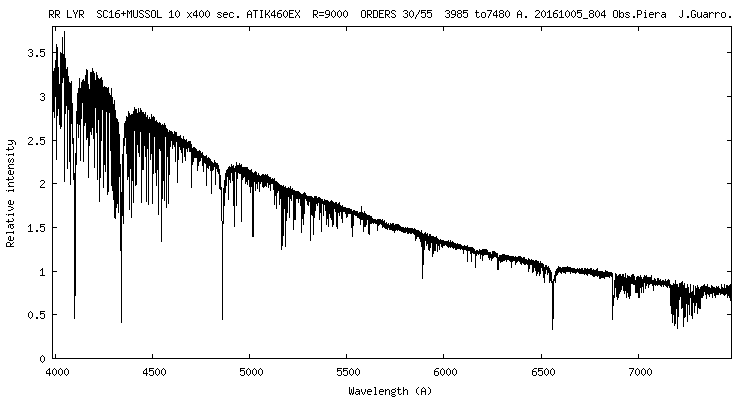

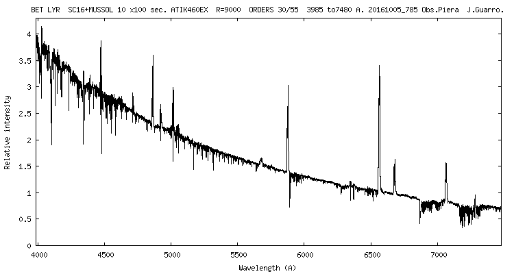

My Echelle Mussol, (Eule ), I work well, from the 5th of October 2016, I've 53 nights of observation (as are many of the good weather allowed me). I am very pleased with their performance. Directions and help, of Martin, they being vital to the tune of the Mussol.
Total are about 200 spectra, 45 of these are the WR140. The range was from 3987 A to 7489 A. The Orders are from 30 to 54.
Mussol's design is very similar to Martin's spectrograph, within paragraph Convento have photos of my guide module, which only has one optical fiber. In the UK Echelle(s) section have schemes of my new have Echelle, the Linx, (Luchs), and its state building. Due to the smooth functioning of the Mussol, I decided to build my Linx for the SC16 of the REMOT Observatory in Sta. Maria de Montmagastrell.
Have some graphic the first positive results of the Mussol.
Friendly, Joan.
__vega_20161005_768_J. Guarro.png [ 5.42 KiB | 1159 mal betrachtet ]
__rrlyr_20161005_804_J. Guarro.png [ 5.94 KiB | 1159 mal betrachtet ]
__betlyr_20161005_785_J. Guarro.png [ 6.38 KiB | 1159 mal betrachtet ]
