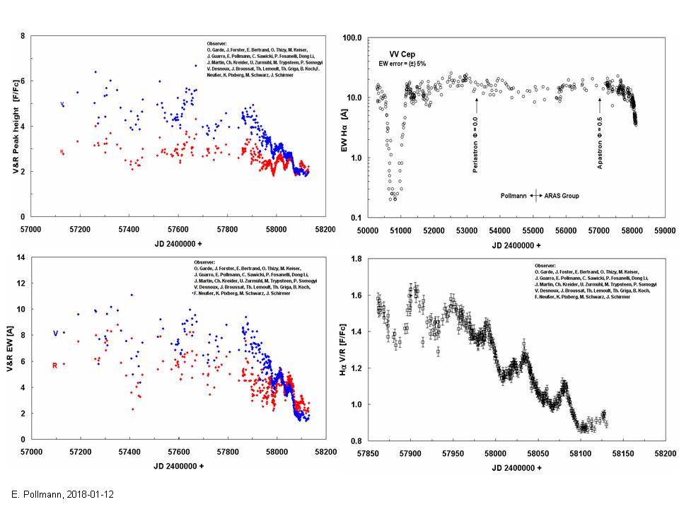

Hello Joan,
are both spectra processed with Isis? It looks strange that the blue lines below 6550 A are stronger than the the red lines but the blue Ha is weaker than the red one. Is V694 MON a variable star? If yes are both spectra taken at the same time?

The two spectra were processed separately, U.Sollecchia sued and I sued, both with ISIS. The small differences below 6500 A. could have several causes, one of them, is the different resolution of the two spectrographs. V694 Mon is a symbiotic variable star, a spectral type (a bit complicated), it is M4ep + Bep. As indicated above the image's right, the difference between them is around 24 hours.
Also, the result of the graphics is due to the processing of CCD "images" (in all cases, the star's light is "transformed", the process is a bit more "complicated", for example, photometric observations where the intensity of the stars is measured directly from the CCD images of the stars).
In spite of all, the precision that we, with our devices and methods is +/-3%, this accuracy is practically the same, that I (a few years ago), obtained when doing CCD photometry with filter V. Measuring the characteristics of the graphs of the different observers, it provides a very reliable medium, that's all we can do.
The two spectra were processed separately, U.Sollecchia sued and I sued, both with ISIS. The small differences below 6500 A. could have several causes, one of them, is the different resolution of the two spectra. V694 Mon is a symbiotic variable star, a spectral type (a bit complicated), it is M4ep + Bep. As indicated above the image's right, the difference between them is around 24 hours.
In spite of all, the precision that we, with our devices and methods is + -3%, this accuracy is practically the same, that I (a few years ago), obtained when doing CCD photometry with F plugin. Measuring the characteristics of the graphs of the different observers, it provides a very reliable medium, that's all we can do.
I think these images are quite eloquent.
Friendly, Joan.
