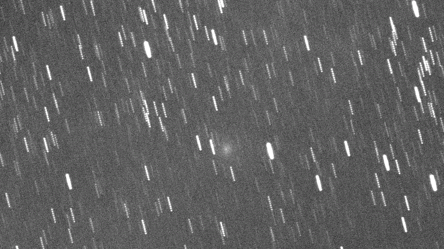

This may be an inverted 3D image of Comet C/2021 O3 (PANSTARRS) from the evening of 2022 April 30. I have not used a 3D image before to show a comet nor attempted to have Astrometrica generate a magnitude from such an image, so this data and what is observed could be correct or a well placed piece of noise. Per Astrometrica the object is magnitude V=8.9 and about where the comet should be located, the SNR is not very good. Due to the bright twilight I couldn't see much in the normal image composed of an average of 10x6 second plus 6x10 second images taken with no filter, but the inverted 3D image shows the stars and maybe the comet. The image has a FOV of 3.8 x 2.5 degrees taken with a 25mm f/4 lens and an ST-402ME camera.
2021O3_20220430_0255_molason.jpg [ 283.59 KiB | 52116 mal betrachtet ]
Cheers, Mike

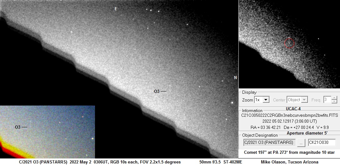

On the evening of 2022 May 2 UT an image composed of RGB images each 10 seconds long appeared to show Comet C/2021 O3 (PANSTARRS). The luminance image was created from the RGB images and a FITS image was created from the luminance image so that Astrometrica could calculate some data from the image. Astrometrica calculated the object magnitude as V=9.9 and the object was located about where one would expect to find the comet. The object was about 3' west of a magnitude 10 star.
2021O3_20220502_0306_molason.jpg [ 189.49 KiB | 51915 mal betrachtet ]
Cheers, Mike
:lol: Arizona

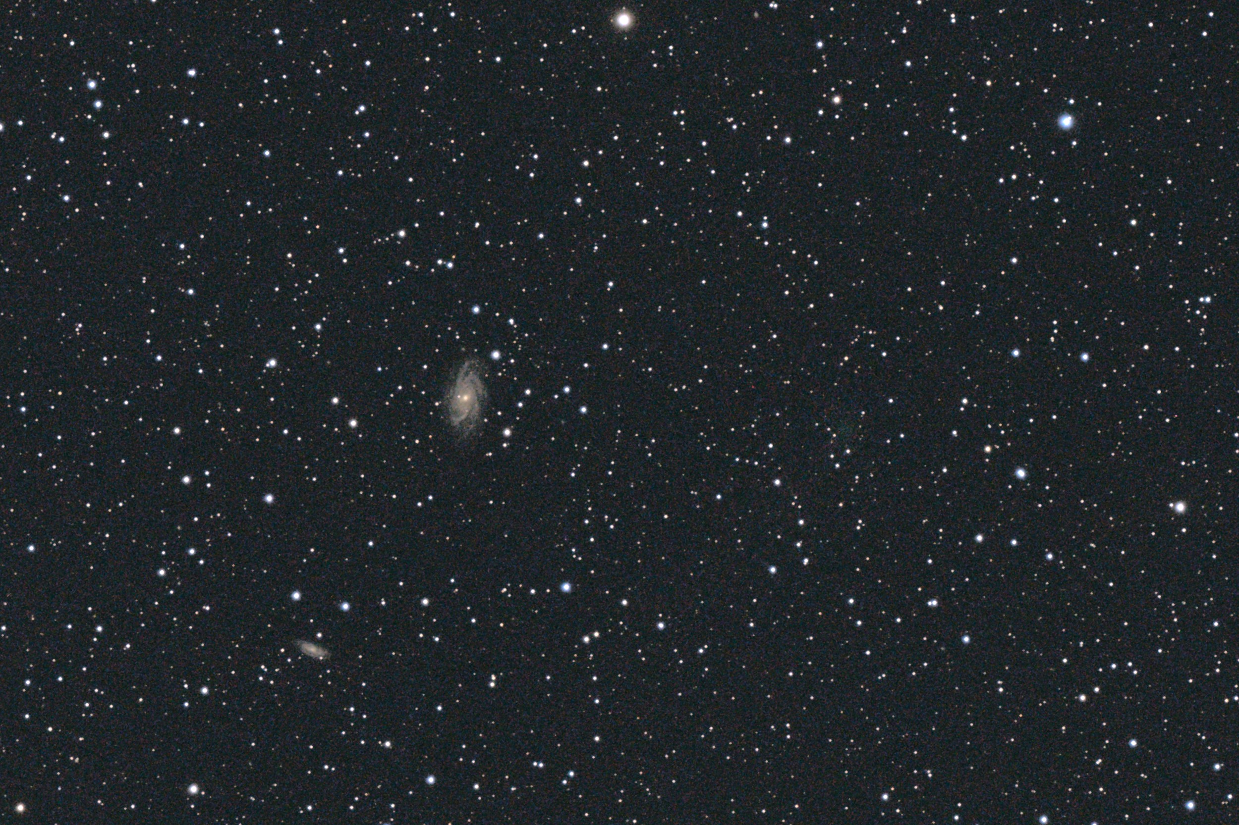

Schade, zu spät mitbekommen. Am 2.5. habe ich noch Bilder von Merkur und den Plejaden gemacht, aber zu kurz belichtet, der Komet ist nicht zu sehen. Wenn das Wetter hält, versuche ich es heute abend noch mal mit tiefen Bildern. Auf La Palma erreicht er heute schon knapp 10 Grad.
Cs,
Jan

war knapp, aber einmal konnte ich zwischen den Wolken 90 Sekunden mit dem 200mm Tele f/4 und ISO 1600 draufhalten. Länger ging nicht, Dämmerung war noch im Gange. Zeit: 21:03 UT.
Unten ein Ausschnitt. Da ist nichts zu sehen: Der Komet sollte nahe der Bildmitte sein. Der helle Stern am linken Bildrand ist 42 Per, der am rechten HD23193. Grenzgröße kann ich gerade nicht genau sagen, bestimmt jenseits 12mag.
cs, Jan

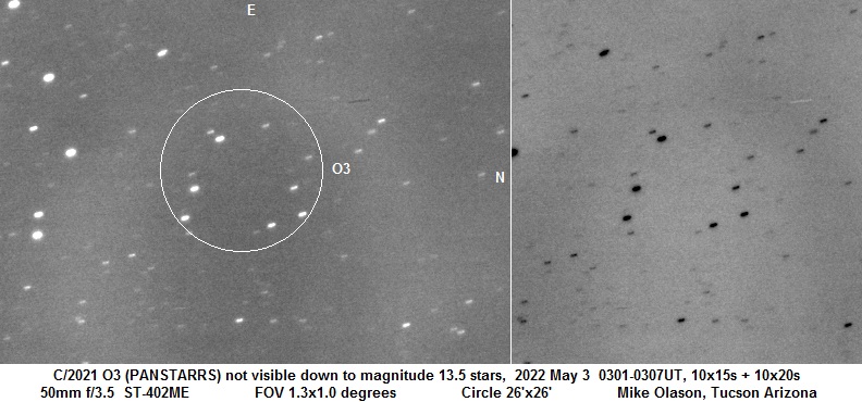

I will add to the confusion about this comet. On the evening of 2022 May 3 UT the following images did not show Comet C/2021 O3 (PANSTARRS) or any bright debris in the area where the comet should be located with stars visible down to magnitude 13.3 and 13.5 respectively. The circled area is 26'x26' centered on where the comet should be located. From Thomas's report it is evident that a large telescope is required to now observe this object with low surface brightness, I was imaging with a 50mm f/3.5 lens. Thomas, is the comet about where the MPC ephemeris predicts it should be located and does it have a brighter area in the center of the coma? I have not looked at images collected on 2022 May 5 yet, maybe there is hope for those images.
2021O3_20220503_0313_molason.jpg [ 136.88 KiB | 51233 mal betrachtet ]
2021O3_20220503_0301_molason.jpg [ 112.07 KiB | 51233 mal betrachtet ]
Cheers, Mike

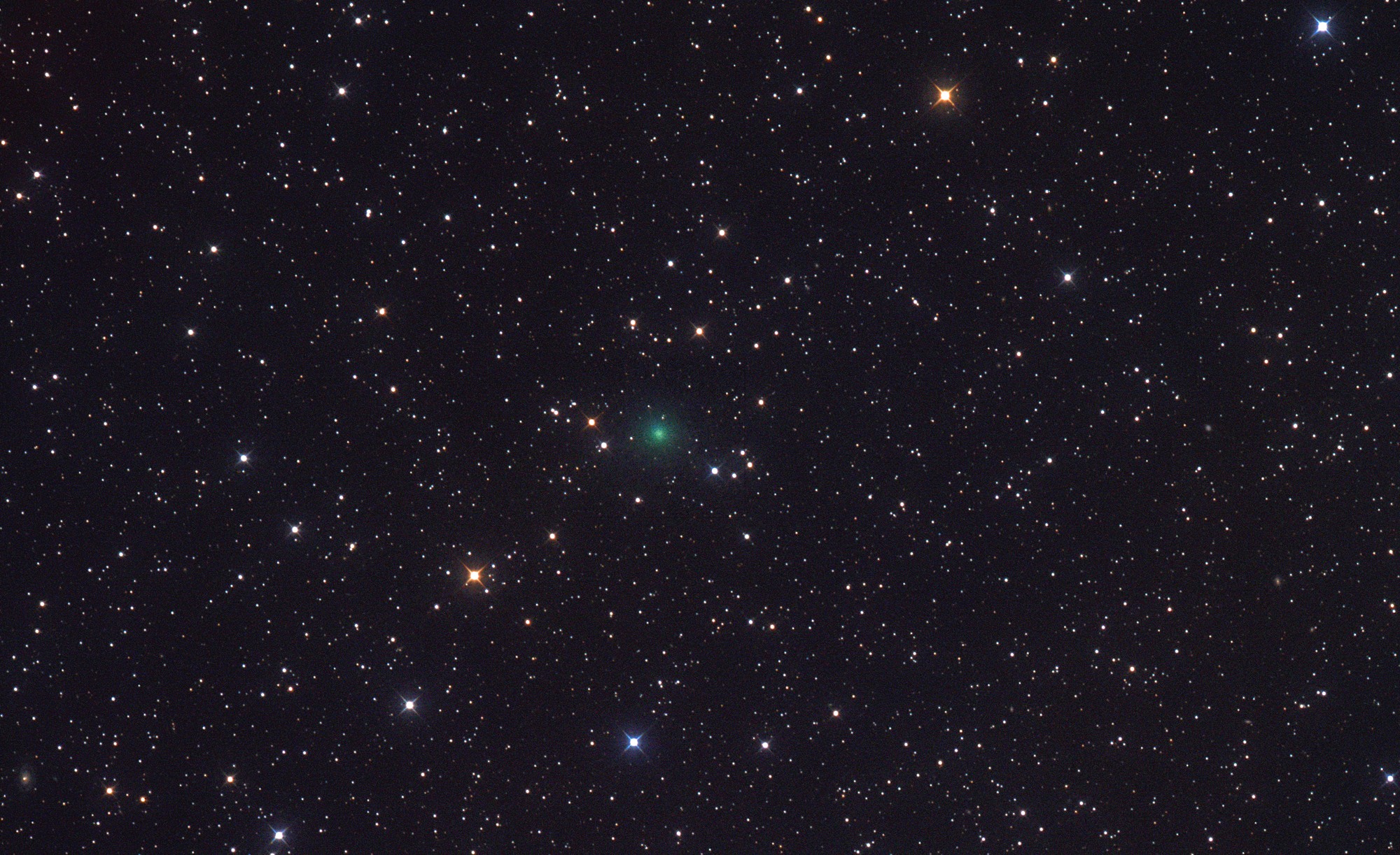

Hier sind zwei Bilder (in unterschiedlichen Bearbeitungsständen) , die den Kometen am gestrigen Abend zeigen.
Ich habe die Helligkeit im Grünen bestimmt zu:
2022-05-08.88 UT, m1=12.3, coma d=3.3'
Die Bilder sind aus 21x 1min Aufnahmen aus der Innenstadt von Weimar heraus entstanden (Mond im ersten Viertel). Der Komet ist halbwegs kondensiert und schaut morphologisch eher normal aus. Im Farbbild fällt der Komet durch seine grüne Gaskoma auf, also auch hier kein Anzeichen einer sich auflösenden Staubwolke.
Die Position ist gegenüber der Ephemeride um ca. 25" in etwa östlicher Richtung versetzt.
Unter guten Himmels- und Atmosphärenbedingungen sollte der Komet (mit angedeutetem Schweif in Verlängerung des Versatzes seiner Position) deutlich besser zur Geltung kommen (ich denke da an Michael ...).
Viel Erfolg bei weiteren Beobachtungen,

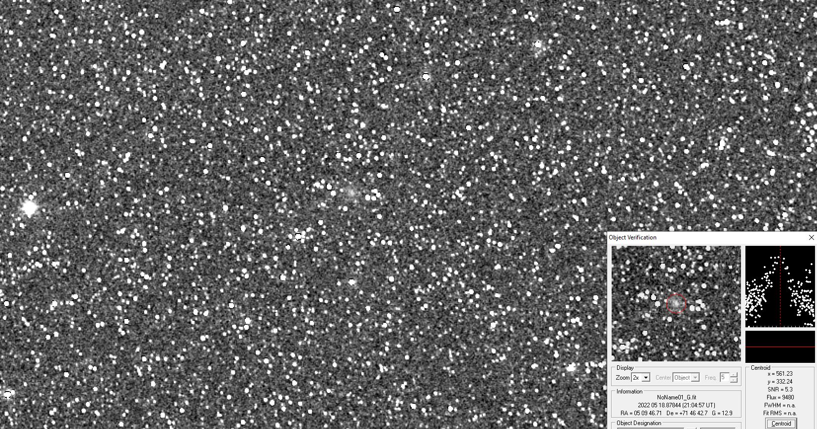

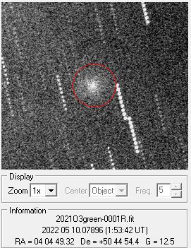

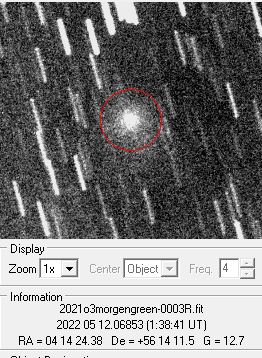

Hallo Nach einer Woche Regenpause konnte ich heute früh Komet C/2021 O3 erfassen. Der Komet zeigt auf Aufnahmen mit dem 14"/4.2 und der QHY600 (16x60sec mit Klarfilter und 9x100sec mit Grünfilter) eine innere diffuse Kondensation von 45" und eine äußere Koma von knapp 3', ein schwacher Schweif von 5' in Pa 110 ist angedeutet. Ein klares Zentrum ist nicht auszumachen. Aufnahmen mit Grünfilter zeigen einen Gesamthelligkeit von 12m5. Die Astrometrie ist in diesem Fall nicht sehr genau.
Gruß Michael
COD G00
OBS M. Jaeger, E. Prosperi, S. Prosperi
MEA M. Jaeger
TEL 0.35-m f/4.2 reflector + CCD
ACK MPCReport file updated 2022.05.10 10:43:42
AC2 michaeljaeger@gmx.at
NET Gaia DR2
    CK21O030 KC2022 05 10.06208 04 04 44.63 +50 42 00.0          16.7 G      G00
    CK21O030 KC2022 05 10.06594 04 04 45.52 +50 42 40.3          16.6 G      G00
    CK21O030 KC2022 05 10.06982 04 04 46.77 +50 43 21.1          16.7 G      G00
----- end -----
2021O320220510UT127sec15x60.JPG [ 430.51 KiB | 51052 mal betrachtet ]
20210320220510green.JPG [ 43.63 KiB | 51052 mal betrachtet ]
2021O320220510UT126sec16x60.JPG [ 599.95 KiB | 51052 mal betrachtet ]

Der Komet wird schwächer - unter besseren Bedingungen als am 10.5. konnte ich am Abend des 11. und Morgen des 12.5. den Kometen länger fotografieren.
Er ist kaum noch heller als 13m0, die Koma ist unverändert 2'45" groß und zeigt eine zentrale Verdichtung von 15" ohne klares Zentrum. Gruß Michael
2021O320220511.gif [ 1.69 MiB | 50842 mal betrachtet ]
2021O320220511UT2029sec10x60.jpg [ 1.85 MiB | 50842 mal betrachtet ]

Nachtrag - die Aufnahme vom Morgen des 12.6. mit Grünfilter ergibt eine Gesamthelligkeit von 12m7
Gruß Michael
Unbenannt.JPG [ 46.24 KiB | 50795 mal betrachtet ]
 Betreff des Beitrags: Re: C/2021 O3 (PANSTARRS)
BeitragVerfasst: 12. Mai 2022, 22:18:41 PM
Beiträge: 728
das ist die Grünfilteraufnahme
2021O320220512UT132sec9x75green.JPG [ 43.85 KiB | 50794 mal betrachtet ]

Am Samstag konnte ich den Kometen erneut fotografieren. Er steht jetzt deutlich höher (30 Grad), allerdings war der Himmel extrem hell (fast Vollmond, etwas dunstig am Stadthimmel). Belichtet habe ich wieder mit dem 11" RASA, ASI6200MC, diesmal jedoch länger: 42x 1min. Deshalb gibt es hier einen farbigen Ausschnitt aus dem Kometen-Stack (keine Glättung oder andere Nachbearbeitung). Die Helligkeitsmessung ergab:
2021O3 2022-05-14.88 UT, m1=12.2, coma d=4.5'
CS
2021O3_220514_costack_color.jpg [ 333.11 KiB | 50556 mal betrachtet ]

Der Komet wird kaum schwächer. Gestern habe ich ihn mit Teleobjektiven aufgespürt. Im 135/2.8 ist er auf Einzelaufnahmen gerade so sichtbar. Die Astrometrie des Grünkanals ergibt 12m9. Gruß Michael
2021O320220518UT2101sec3x130secgreen.jpg [ 466.53 KiB | 50323 mal betrachtet ]
2021O320220518f136sec6x120.gif [ 4.38 MiB | 50323 mal betrachtet ]

da haben wir fast gleichzeitig aufgenommen. Aber mein Bild zeigt natürlich nicht so viel.
Die Helligkeit nimmt stark ab - gestern kam ich auf 13.5mag.
Wer will, darf den Kometen in meiner Aufnahme suchen...
C2021O3_2022_05_24_2054_2151UT_21x1min_ISO3200_580mm_NGC2336.jpg [ 1.02 MiB | 49709 mal betrachtet ]
