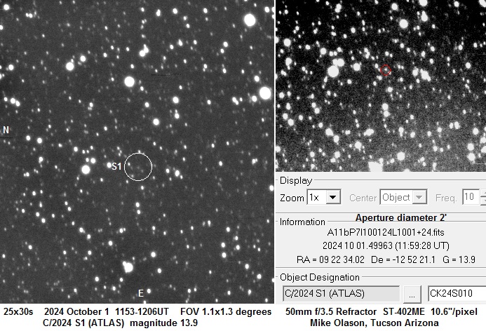

Comet C/2024 S1 on the morning of 2024 October 1 was magnitude G=13.9 as calculated from 25x30 second images in an aperture diameter of 2'. When I took the images this morning using all the ephemeris updates I assumed that I was not in the correct area because nothing appeared that suggested an impressive comet, it was not until Michael posted this topic that I could verify in that little circle that is drawn in the image that this was the comet C/2024 S1, let us hope it gets brighter! Time to go farming and when I get back this comet should be almost one million times brighter!
2024S1_20241001_1159_molason.jpg [ 162.23 KiB | 10667 mal betrachtet ]
Cheers, Mike
