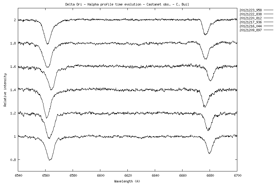

Hi all,
The plots below shows Halpha + He profile for the date Dec. 23.958
and change in the yellow He line between 19H58M UT and 22H59M UT,
the Dec 23.
In only 2 hours the radial velocity change of the system
can be detected (here the He line the shift represent nearly 0.2 A, i.e. 10 km/s) !
Note that interstellar Na lines are not concerned.
Christian Buil
Dateikommentar: Two hours evolution of the spectrum
_deltaori_20121223_plot2.png [ 5.54 KiB | 19180 mal betrachtet ]
Dateikommentar: Halpha + red helium lines the 23.958 dec.
comparison.png [ 13.04 KiB | 19180 mal betrachtet ]

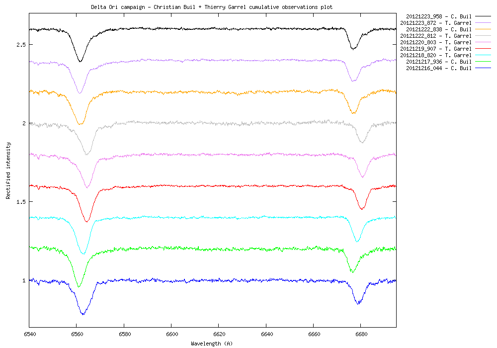

Below, I put on the same graph data available from C. Buil and T. Garrel. It is very
instructive because we can better track the live evolution and this is also
(note periodic radial effect). It is also possible to better detect
potential problems and increase reactivity...
This analysis is possible because Thierry Garrel data are public on his blog:
http://gabalou.canalblog.com/archives/2 ... 54217.html
I also have also a public page with the journal of observations:
http://www.astrosurf.com/buil/campaign/deltaori/obs.htm
This is a good and important thing and effort, but the ideal solution is to collect all the observations
in the same database. See for example the actual ARAS AZ Cas campaign:
http://www.astrosurf.com/aras/surveys/a ... as_tab.htm
This is fundamental for collaborative work between amateurs (amateurs are not competitors!), for common motivation, for implicate
more observers, for a direct and fast check of observations with similar protocol...
(remember that the spectrography is a young discipline for many observers).
The example of the AAVSO in the variable stars domain is excellent. It is a key for
the development of amateur spectroscopy and an effective proam collaboration.
Without a doubt, the scientific analysis is a matter for professionals.
But amateurs are not more than observers - they can make themselves
preliminary analyzes, for example by a simple data comparison (for the present
and also for the future, by adding more observations - that is one of the interest
of a common database or common and public campaign page).
These first analyzes can also help professionals.
I propose to consider this for future campaigns.
Christian Buil

 Betreff des Beitrags: 26.8 dec. observation
BeitragVerfasst: 28. Dezember 2012, 13:52:54 PM
Registriert: 11. Dezember 2012, 19:53:03 PM
Beiträge: 29
Hi all,
Attached, aspect of Halpha region for the date Dec. 26.82 + cumulative plot.
_deltaori_20121226_947.png [ 6.11 KiB | 18900 mal betrachtet ]
comparison3.png [ 17.24 KiB | 18900 mal betrachtet ]
BeitragVerfasst: 28. Dezember 2012, 16:00:00 PM
Beiträge: 29
Hi Tony and all,
Attached a tentative of comparison between photometry and available
spectrograpy material.
The spectroscopic data used are for the date:
Dec. 17.936 (C. Buil)
Dec. 18.820 (T. Garrel)
Dec. 19.907 (T. Garrel)
Dec. 20.803 (T. Garrel)
Dec. 22.838 (C. Buil)
Dec. 23.958 (C. Buil)
Dec. 26.821 (C. Buil)
The radial velocies are corrected from a mean radial shift of 16.0 km/s (source SIMBAD)
and from computed heliocentric RV for the date.
The zero velocity correspond to wavelength 6562.80 A.
More data are needed for densifier the plot !!!
If you want, you can send me your spectra (before rectification of the continuum and telluric lines removal) to try to complete the graph. If possible FITS format clearly specifying UT date and instrument description.
My email: christian.buil_at_wanadoo.fr
Indicate is you are OK for an archive on a future ARAS page about
delta Ori (It is possible to extend the observation beyond the current campaign of course!).
Tony, what about the color used for photometry?
Do not hesitate to provide the light curve, it is very exiting to follow system activity in direct !
Christian B
phot_spectro.png [ 53.55 KiB | 18889 mal betrachtet ]

From: Christian Buil (fg-spek-convento@vds-astro.de)
Sent: Friday, December 28, 2012 9:00 AM
Subject: [fg-spek] Re: Request for observations of the 2mag star delta Orionis
Hi Tony and all,
Christian B

BeitragVerfasst: 29. Dezember 2012, 14:28:17 PM
Beiträge: 639
Wohnort: Schulberg
Hello,
3 more profiles of the last (-5deg-cold) night.
Interesting are the widths wings on the red side!
Siegfried
delta-Ori_28122012.gif [ 23.28 KiB | 18821 mal betrachtet ]
delta01_nor.fits [16.88 KiB]
490-mal heruntergeladen
delta02_nor.fits [16.88 KiB]
492-mal heruntergeladen
delta03_nor.fits [16.88 KiB]
502-mal heruntergeladen
