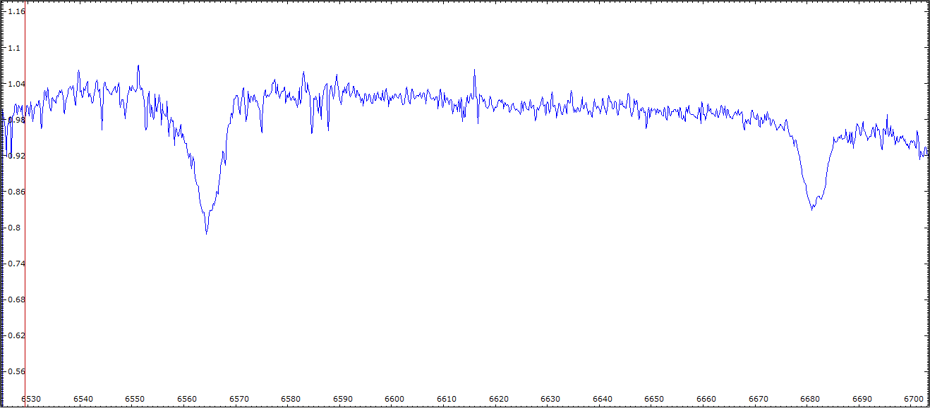

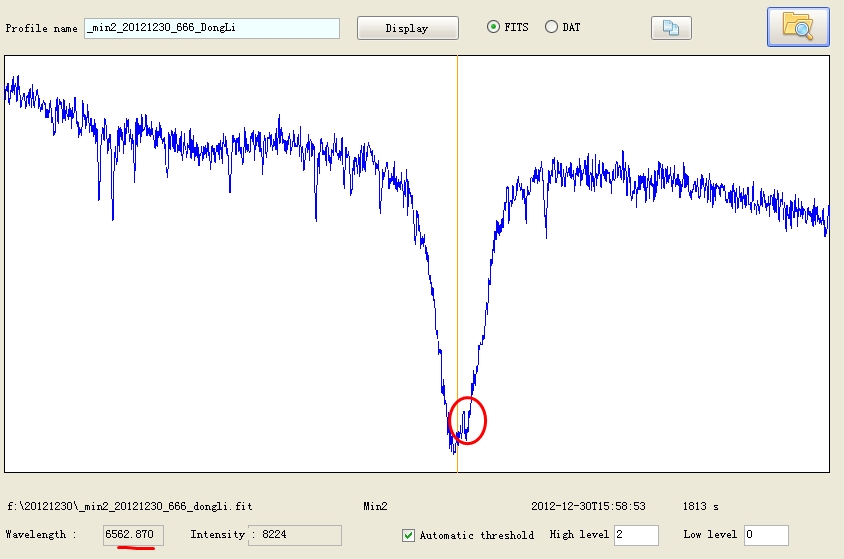

Hi all:
I am not sure if maybe I also catch the little hump in the Ha. Please see the following fresh spectra.
PS. the setup is : C11; Lhires3 with 2400l; 23um slit; 285CCD set to -45℃
Dong

BeitragVerfasst: 31. Dezember 2012, 01:11:49 AM
Beiträge: 265
Wohnort: Maienfeld, Schweiz
Hi Dong,
very nice spectra. Congratulations! The hump you see on H-alpha looks to me like a water line. Try to remove the water lines from your spectra (easily done with ISIS) and see if the hump disappears. Depending on the radial velocity of the H-alpha (and the humidity and elevation of the star) the water lines are more or less prominent.
Best wishes for the New Year to everybody,
Martin

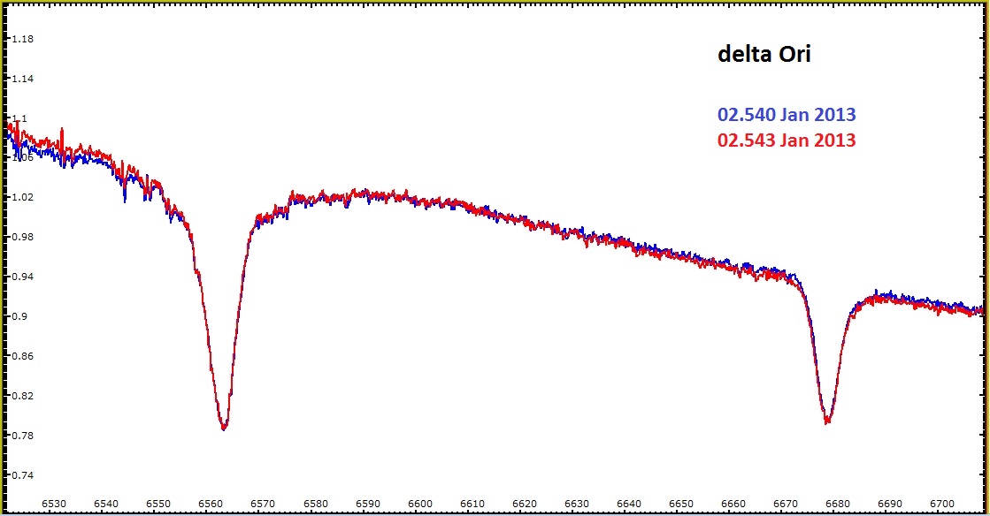

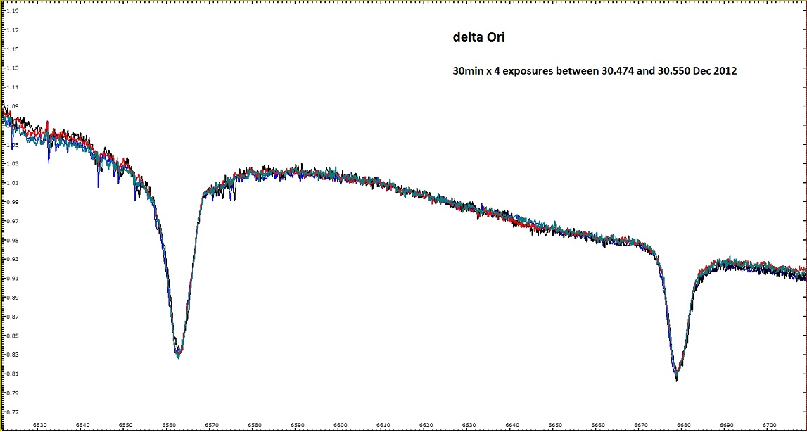

BeitragVerfasst: 31. Dezember 2012, 10:25:09 AM
Beiträge: 178
Wohnort: Melbourne, Australia

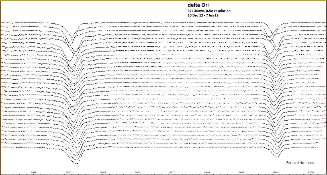

My dried spectra, 4 x30min, on 30 December.
Cheers, Bernard
delta Ori 301212.jpg [ 96.53 KiB | 20616 mal betrachtet ]

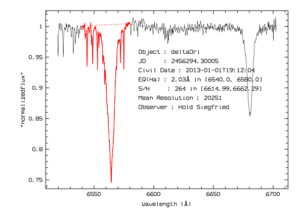

Hello,
here a first elaboration of the profile from yesterday. I am however still
are not satisfied.
Siegfried

Hi Martin:
Happy New Year~ :)
Yes, you are right, Sunday's night when I took spectra, Orion was located at meridian, but the humidity was 103%. But ago when it comes to the meridian, usually the humidity is very little. Maybe this is the reason why there is a little water-hump appearing in the Ha.
I have taken your advice to try to remove water by ISIS, but it seems that I can not get it. Could you try my data on your PC to see what it will be?
Cheers,
Dong

I wrongly labelled my blue spectra time (just to confuse the enemy ;)) as 2.540, while it should have been 2.520 .. sorry, but apparently I can't edit the image I posted.
Bernard

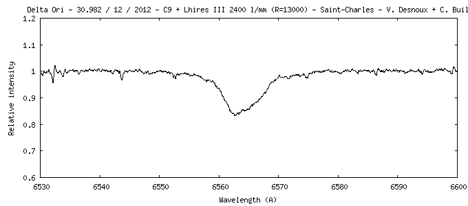

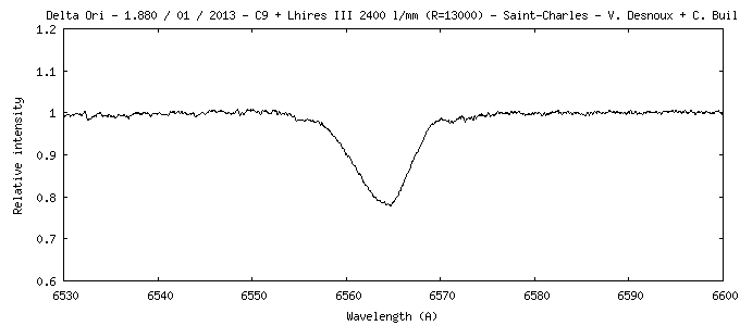

New observations of delta Ori by using Lhires III 2400 l/mm spectrographs.
December 30.98 from Valérie Desnoux observatory on its
observatory in Paris city (very near Eiffel tower!). Celestron 9 telescope, Lhires III 35 microns slit and
Atik460EX CCD camera. Not an ideal nigth (clouds) bu sufficient for
detect a peculiar Halpha shape.
January 1.88 from Valérie Desnoux observatory (better conditions).
January 2.83 from my observatory (Castanet, near Toulouse large city south of France). Note the high signal
to noise, measured at 500. The setup is a Celestron 11 + Lhires III
2400 l/mm 35 microns slit and excellent Atik460EX camera
used in bin 2x2 mode. 9 x 300 sec. exposure. The spectral
calibration error is evaluated to +/- 400 m/s only.
Amateurs AND professionnels can download FITS data from
my public campaign page:
http://www.astrosurf.com/buil/campaign/deltaori/obs.htm
(two forms are proposed for FITS spectra files)
I am very motivated to participate in this type of campaign, but I am also a pure amateur,
I do not work for any institute / observatory in particular :wink: For me it is logical and
normal to make public and visible yours amateurs observations as soon as possible for a max. reactivity. My goal is to motivate a maximum
of observers and facilitate exchanges between experts and non-experts, not participate in a private operations, less open, more confidential.
I am sure that a spectral database, at the image of AAVSO, is the ideal form for the future, also for professionals (ideally professionnals suggest campaigns idea, propose observational protocol, define observation
period, but take formated data in
a global (ideally) and public spectro database).
Of course professionals can name in their paper the main amateurs contributors. It is the suggested policy for user of BeSS database and for ARAS campaign (a large campaign concerning GAIA space mission in support of
RVS spectrograph car be offered to amateurs in the future...., for example).
_deltaori_20130102_827_recti_h2o_cbuil.png [ 3.63 KiB | 20422 mal betrachtet ]
_deltaori_20130101_880_recti_h2o_vdesnoux.png [ 3.59 KiB | 20422 mal betrachtet ]
_deltaori_20121230_982_recti_h2o_vdesnoux.png [ 3.71 KiB | 20422 mal betrachtet ]
 Betreff des Beitrags: Re: Lhires III observations
BeitragVerfasst: 04. Januar 2013, 08:49:52 AM
Registriert: 23. Oktober 2012, 07:17:54 AM
Beiträge: 11
Wohnort: Baltimore, MD, USA
Here is a confirmation of the odd H-alpha shape seen in Valerie's trace. It was clear that night here in Baltimore and I captured this spectrum just an hour or two after Valerie's. Note the plot label is incorrect - the camera was an ST8xme, not ST9!
Mike Potter
Baltimore, MD
BeitragVerfasst: 04. Januar 2013, 11:33:22 AM
Registriert: 11. Dezember 2012, 19:53:03 PM
Beiträge: 29
Mike,
You confirm also the small depth of Halpha line for the date. Excelllent!
BeitragVerfasst: 05. Januar 2013, 15:55:55 PM

Here are my 3x 30min spectra from earlier tonight, 5 Jan, with a resolution of 0.52A (R=12,600). No sign of the earlier reported Ha distortion.
Cheers, Bernard

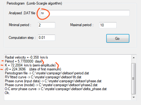

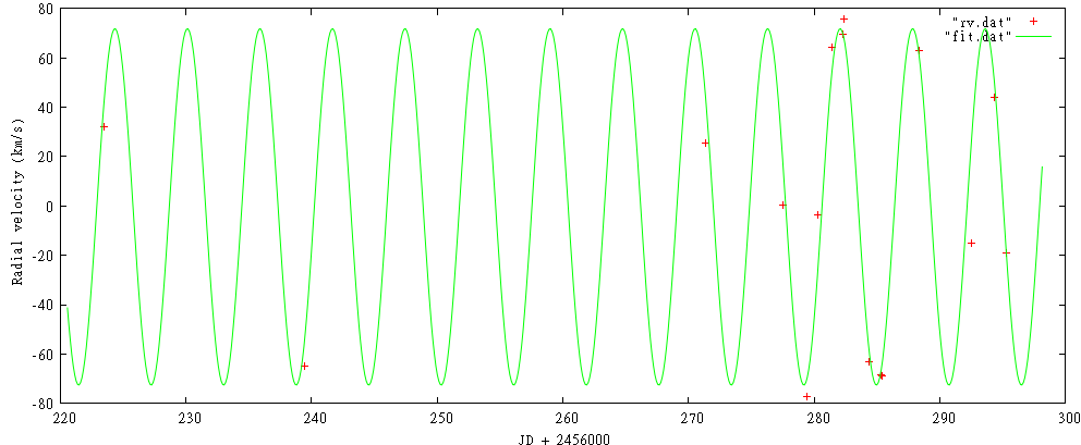

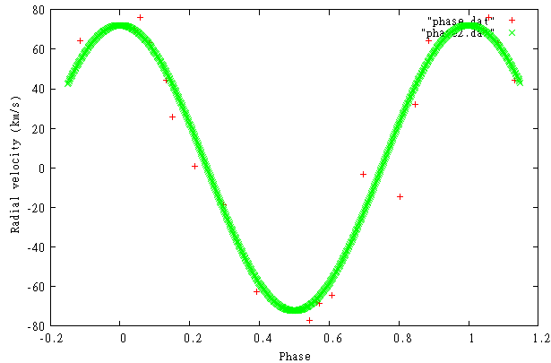

User of ISIS software can also compute period, radial velocity or
JD0 date of periodic phenomena by using a simple and
efficient tools accessible from Misc/Radial velicity tabs (see screen copy
below).
Here the contain of actual input RV.DAT file:
223.481 31.89
239.425 -64.80
271.397 25.57
277.544 0.347
279.436 -77.34
280.325 -3.52
281.412 64.15
282.312 69.57
282.407 75.80
284.338 -63.18
285.332 -68.49
285.377 -68.89
288.321 62.93
292.482 -15.03
294.380 44.12
295.327 -18.86
First column is JD date minus 2456000, the second column is the
measured radial velocity in km/s (relative to rest 6562.8 A wavelength).
The data are extracted from spectra taken by C. Buil, V. Desnoux and T. Garrel.
The heliocentric velocity is corrected.
Mike, a good idea is to publish your measure for increase points density
(note also the interest of a public data base for nearly real time and exiting common analysis :wink: ) ?
I measure only on the base of Halpha line a period of 5.77 days,
a Vsin i value (K parameters) of 72.2 km/s and a reference
JD epoch of 2456224.37 (max RV arbitrary point). The observation duration is
short and spectral profile is affected non-orbital distorsion. All this
seem affect precision.
Below also, graphical output of ISIS :
curve_fit = comparison of observed points - red cross- and experimental computed ephemeris (green line)
curve_phase = the phase curve (red cross -> observed point).

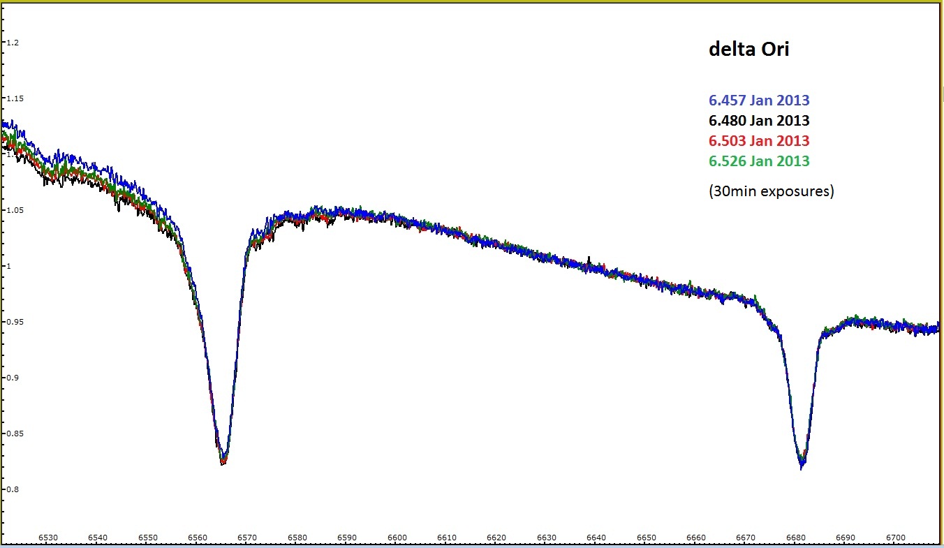

Here are my 4x 30min spectra from 6 Jan, with a resolution of 0.50A (R=13,000).
Only one night of this campaign left!
Cheers, Bernard

BeitragVerfasst: 08. Januar 2013, 00:34:46 AM
Beiträge: 639
Wohnort: Schulberg
Hello,
this is an analysis of my results of this campain. Only on 01/01/2013 I had good conditions , otherwise always fog or clouds. But I'm happy with the result.
The next days more, it's late!
regards
Siegfried
Mintaka_2012.GIF [ 10.52 KiB | 20195 mal betrachtet ]

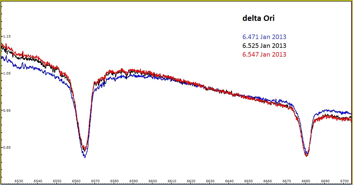

Here are my 3x 30min spectra from 7 Jan, with a resolution of 0.50A (R=13,000), which I believe is the last night of this campaign. Can the 'powers that be' confirm this?
I'm not sure if the continuum profile change between the first (blue) spectrum and the other two is genuine. There was a time gap of over an hour between them, due to a mount tracking problem, so it wasn't a sudden change.
Cheers, Bernard

BeitragVerfasst: 13. Januar 2013, 03:34:37 AM
Beiträge: 178
Now that the 'field' campaign has ended I have made a quick (dried and rectified) plot of the spectra I recorded between 10 Dec and 7 Jan.
Cheers, Bernard
del Ori comp plot.jpg [ 353.92 KiB | 19964 mal betrachtet ]
Quicquid Nitet Notandum

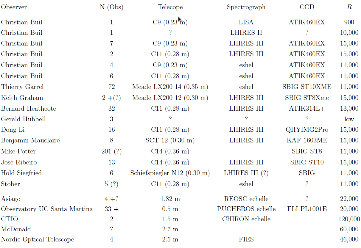

Wow, we have a LOT of great data from the campaign. Here's the stats (of what I have/know of) right now. If you are missing, or I have bad information, please let me know so I can fix it or we can find the source of the problem.
The table is as fairly self-explanatory. If you have questions, let me know. There are a lot of data to process and analyze now. (more than 400 spectra!)

Based on the number of spectra the campaign is certainly looking like a great success, but reporting the number of observations can be a bit meaningless. Some may submit every single order spectra while others only the resulting stacked spectra, and eShel spectra are even more misleading as every 'exposure' typically results in over 30 spectra.
Congratulations to all those that took part ... a great effort.

Hi Bernard (and others),
These numbers represent the number of spectra where one eshel spectrum with all orders is counted once, and one Cassegrain spectrum is counted once. I have started the task of trying to merge them together, but I expect that will take a while. Perhaps I will have a fun plot of the data next week.
I certainly agree that the campaign was a great succes, largely because of the dedication by "amateurs" like yourself. The data are really great.
Cheers,

Noel:
Since the item is missing in your table, the spectrograph I used was a LHiRes III.
Mike

Hello Noel,
I see a "?" in the second columne and I don't what it means.....:-) I used I CCD with an KAF 3200 . ( NOVACCD....a german product).
Is it enough for you, what you have to know about my spectra?
Have I to send you the original not reduced frames. In this case, I need a ftp acount. But I think you have about 400 spectra, so my spectra are not so important......
cheers
berthold (stober)
