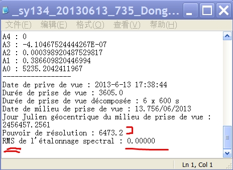

BeitragVerfasst: 14. Juni 2013, 18:46:35 PM
Beiträge: 49
Wohnort: Tianjin, CHINA
Hi Bernard,
Here is my 1st experimental result. Something are not clear to me, so I'd like to ask your help. I use "File Mode".
1> whatever I use 2 order(5 Ne lines) or 3 order(4 Ne lines) in the G1200.LST, the final spectrum is always left-low & right-high. Why?
The same situation exists with/without instrument response in the General Tab. The procedure to make instrument response is:
Tab Profile → database → MILES → select HD003369 display → click Save button as REF
2> Tab Normalize. when I click "compute"button, nothing happens.
3> when use 2 order, RMS=0.735; 3 order RMS=0.000. In the ISIS tutorial, for 1200L, RMS≥0.1A, it means the result is not good enough. Mr. Leadbeater has used 2 degre + 5 Ne lines, so do I, but both sides of contuum are the same high in his spectrum of WR134. WHY?
Regards,
Dong
spectrum.jpg [ 182.71 KiB | 26673 mal betrachtet ]

Hi Bernard,
Tab Profile ? database ? MILES ? select HD003369 display ? click Save button as REF
3> when use 2 order, RMS=0.735; 3 order RMS=0.000. In the ISIS tutorial, for 1200L, RMS?0.1A, it means the result is not good enough. Mr. Leadbeater has used 2 degre + 5 Ne lines, so do I, but both sides of contuum are the same high in his spectrum of WR134. WHY?
Regards,
Dong

Hi Dong,
The raw reference spectra I am refering to is the star spectra you recorded for making your instrument response (IR) ... Vega, Regulus, or another.
Looking at your neon images I see you do need to put your WR star spectra in a better position, because where it is now the neon lines are very weak, so the target spectra will also not be in the best place. Usually the spectra is located at the part of the image where the response is near maximum, which you can find from your flat field.
The process of deriving the IR is well described by Christian in various places, specifically in English at http://www.astrosurf.com/buil/isis/guid ... to1_en.htm for the Lhires. Also, in French, a new more detailed description including the atmospheric correction at http://www.astrosurf.com/buil/isis/guid ... method.htm. Please have a look at these and, if you still have questions, I will try and answer them.
Cheers, Bernard

Beiträge: 178
Wohnort: Melbourne, Australia
Hi Dong,
I agree with Martin that you should first concentrate on getting the reference star spectra and then a good wavelength calibration ... which is more important than the instrumental response. I am away from home, and my documentation, but when I return I will see if you have the correct neon line values. I am confident that if you place your spectral line on the CCD near where the flat image response is high you will get both a better neon spectra and a higher S/N target spectra.
Once you have achieved a good wavelength calibration, with a low coefficient rms value, you then use ISIS to:
a) process the reference star spectra (without an instrument response correction). We will also, for simpicity, ignore any atmospheric corrections.
b) use the Profile/Compare function to derive the raw instrumental response (IR), which is done by dividing your reference spectra by the selected Miles spectra.
c) save this raw IR
d) use the Profile/Continuum function to fit a smooth line to the raw IR (above). You do this by first removing all large lines and then adjusting the smoothing value to get a good fit to the raw IR. I find one of the automatic fits works reasonably well ... it then just needs fine adjustments.
e) save the above result as your final instrumental response (IR).
f) you can check the quality of the IR curve by reprocessing the reference spectra but now using the IR curve for the instrumental response, and then comparing the result with the Miles spectra.
g) make sure you record the reference and target stars with exactly the same optical settings ... same scope, same grating and same micrometer position.
h) use ISIS to process the target spectra the same way you did for the reference spectra, but now using the instrumental response correction.
If you do all the above you should have a well calibrated spectra. If the reference and target spectra were recorded at significantly different altitudes and/or sky conditions then you would also need to correct for atmospheric effects ... but we can discuss that later ;)
Cheers, Bernard
