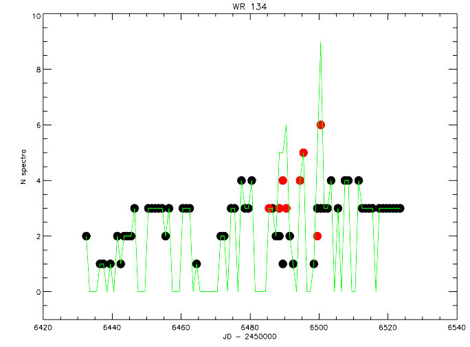

Hi ConVento members!
I got a preliminary data statistics for WR 134 from Noel (attached) which covers Teide (black) and Mont Megantic (red) observations. It is the number of spectra (30 minutes each) against Julian date. We obviously have been lucky during our mechanical problems at Teide because OMM covered it pretty well. Note that all other amateur observations are not yet included.
Noel also checked the most recent data and confirmed the result from Martin about their very good quality (excellent job by team 7). I now see no reason to expect a reduced data number and quality during the final period at Teide. When running without major time gaps we even can compensate for our one week stop.
Cherio, Thomas

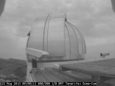

BeitragVerfasst: 22. August 2013, 09:47:59 AM
Hellohoho,
bad weather at Teide! No observation at August 20. 21. and also today the weather is still bad...
Your clouded Team 7 :-(

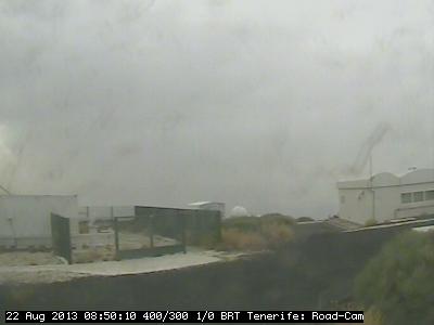

BeitragVerfasst: 22. August 2013, 09:52:41 AM
This is it...... :(
webcam-tn-domecam-i.php.jpg [ 12 KiB | 28406 mal betrachtet ]
webcam-tn-roadcam-i.php.jpg [ 12 KiB | 28409 mal betrachtet ]

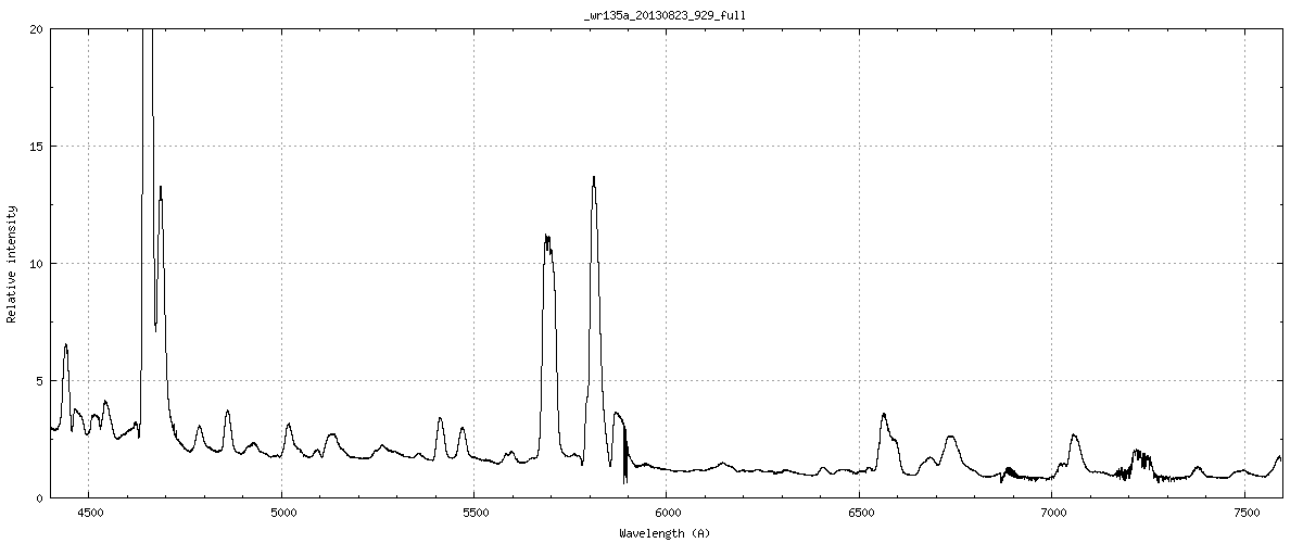

Hallo Thomas and Heidi,
I looked at the latest spectra from Aug. 23. Everything looks fine, the usual bad 10% of shifted spectra from the sample I have seen. The rest looks very good, only a small shift of a few pixel since Aug. 11, no problem for the software. Below some examples. Instrument response corrected with zet Aql, but no correction for atmospheric transmission. As usual, the actual spectra and the configuration for processing in ISIS I will upload on the server in the folder 20130823.
Hope you have good weather and can produce more spectra like this.
Regards, Martin

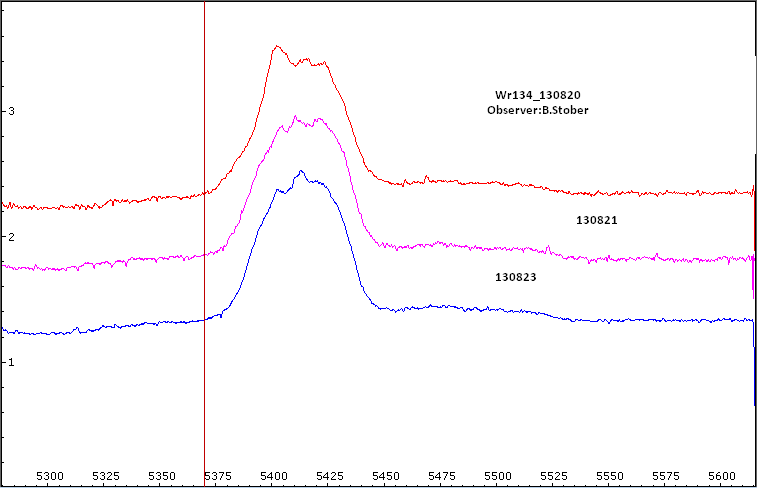

BeitragVerfasst: 26. August 2013, 20:08:21 PM
Hi Thomas and Heidi,
glad to hear now those statements!
Plaese couldt you write the position of this Nova here? Perhaps I'll find time tomorrow to reduce the novaspectrum. I did not use the eshelreduction mode of isis for a longer time, becaucse I used it to reduce my lhires spectra. So I have to look from the beginning how to use eShel mode of isis. But I think it could be rather easy concerning the newest *xml from Martin Dubs.
In the last few nights , I have taken WR134 at 5400 Angströms reagion. Please see the results.
cheers berthold

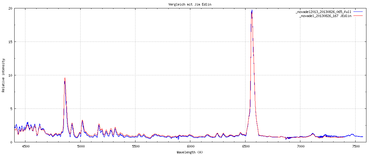

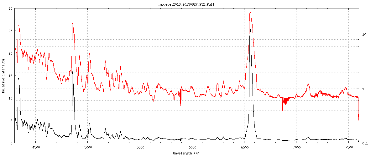

Hello everybody,
as already announced, here are the some spectra from last night. I checked the WR spectra and also the spectrum from Nova Del 2013. As usual I upload the spectra on the Montreal server for those interested in the details.
Here only two examples:
A comparison with a lower resolution spectrum of Jim Edlin shows that the many lines in the Nova spectrum are not noise but real. Remarkable is the fast evolution of the H-alpha emission during the last days, it is easily overexposed if one does not pay attentiion.
With the bad weather over much of Europe, these spectra from IAC80 are very valuable.
Keep going, Thomas,
Regards, Martin

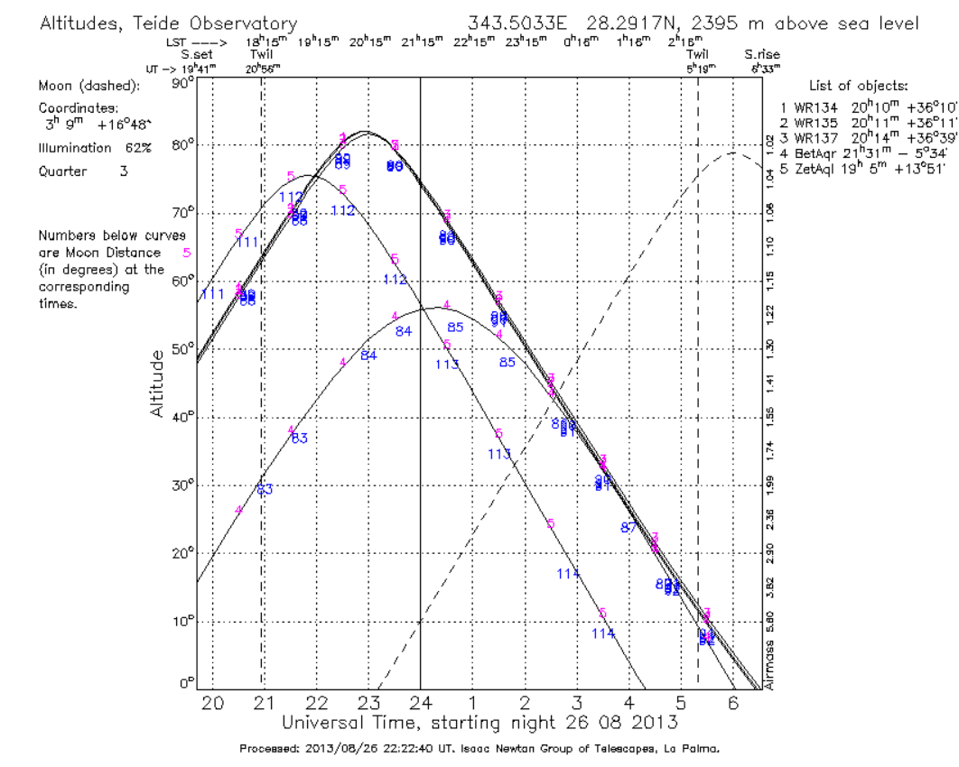

Hi Tony,
Good to know - not clear to me up to now! We spent effort in rearranging the WR sequence in a certain random manner - exactly opposite to what is needed. We immediately go over to a rolling sequence.

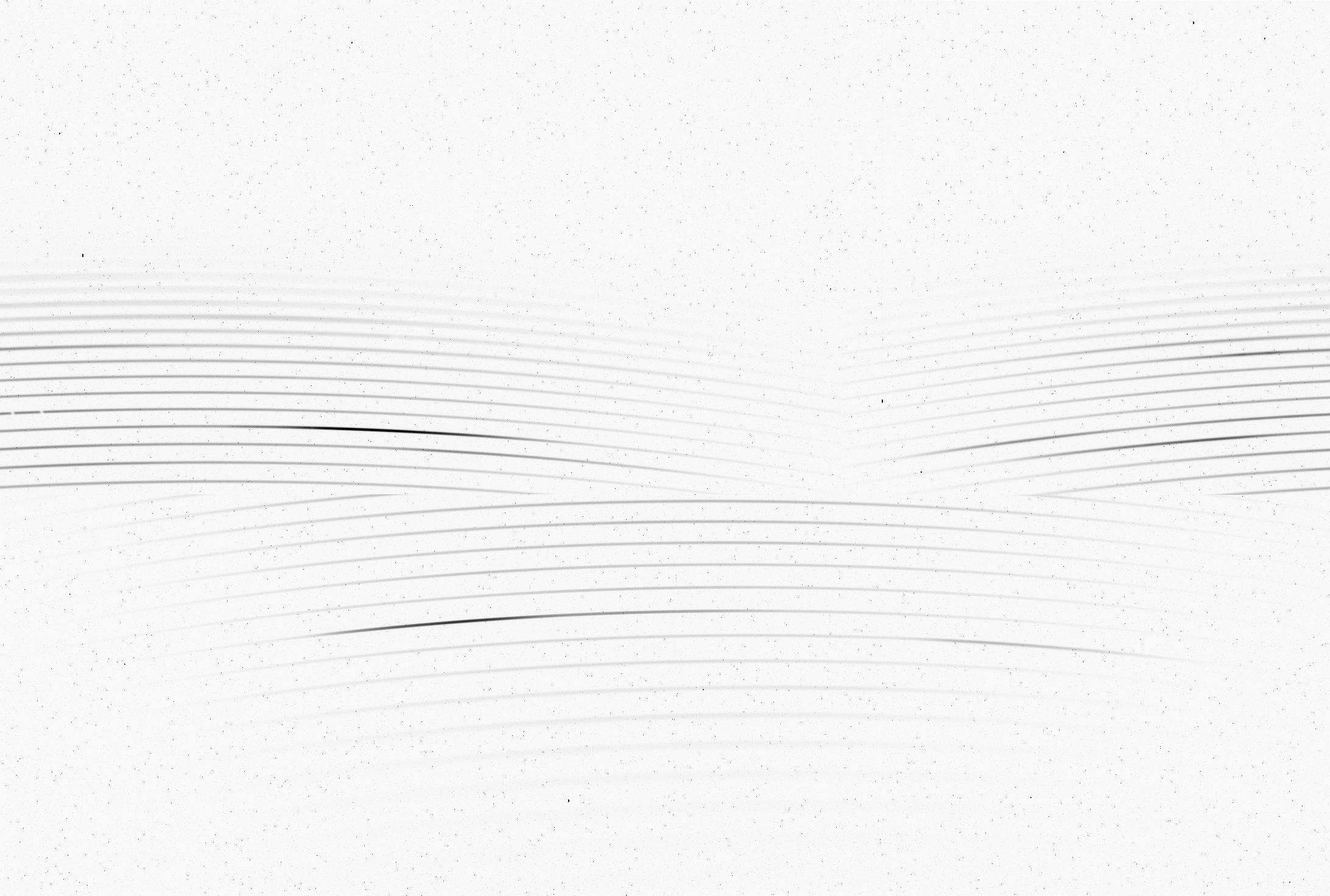

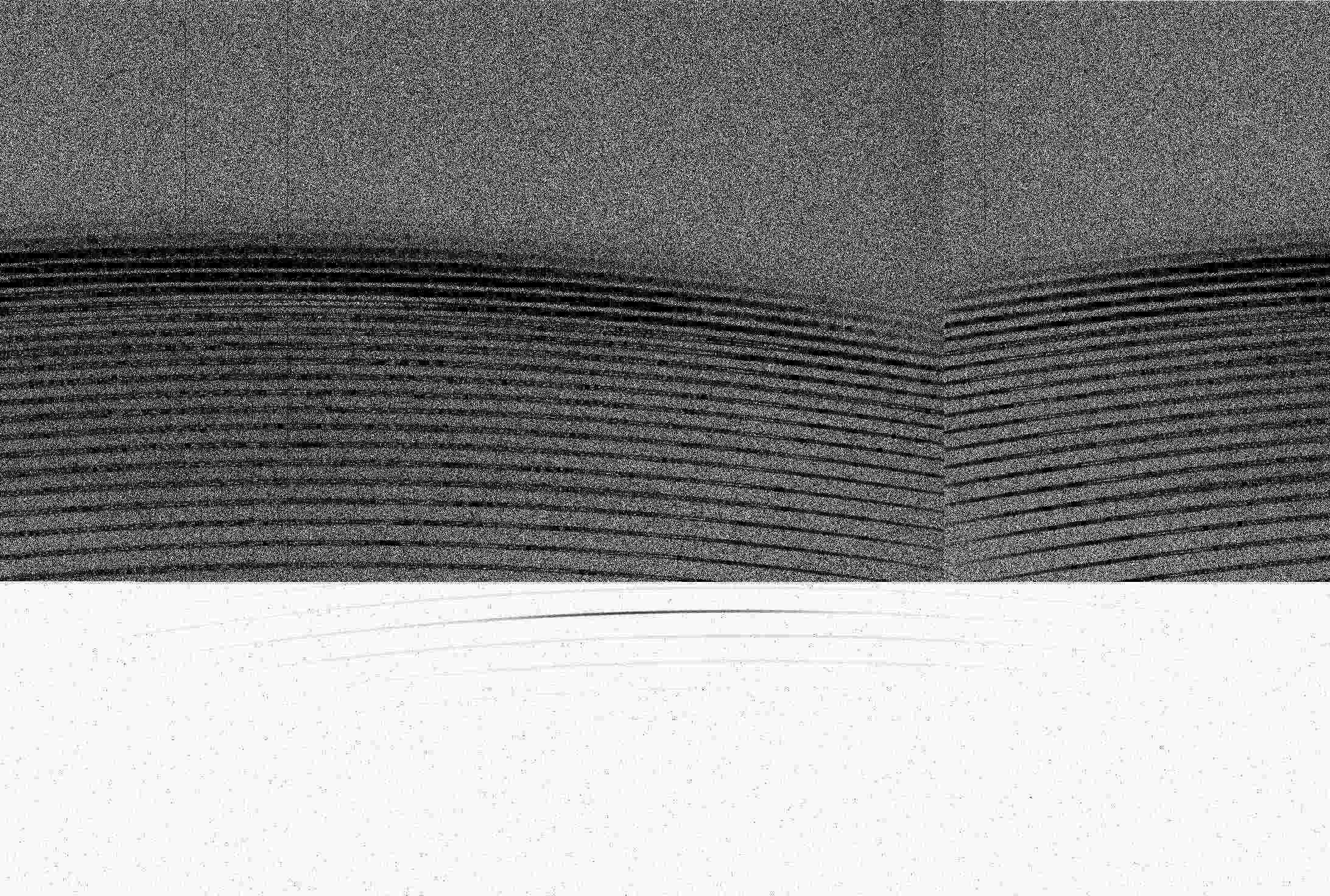

Another "problem" or even a fact: early culmination of WR in late summer. Attached you find the current visibiliy chart. WR ends for IAC80 at around 3:30 UT due to increased safety margin of telescope limit. Twilight is not an option. In fact, it will be hard (may be impossible) to get three spectra of each WR.
By the way, we have increased readout problems this night with really corrupt images (not the shift problem), lost 2 spectra so far...

Hello Team,
Update from IAC80:
Yesterday's observation:
WR137, WR135, WR134, NovDel, WR137, WR135, WR134, BetAqr, ZetaAql,
WR137, WR135
Loss of two object spectra due to corrupted images. What is meant is attached. Don't be confussed, I like inverted images because I have the feeling to recognize readout failures easier (especially for ThAr)
Regards,
WR137_accepted.jpg [ 264.54 KiB | 28162 mal betrachtet ]
WR134_OK.jpg [ 256.61 KiB | 28162 mal betrachtet ]
WR134_corrupt.jpg [ 385.87 KiB | 28162 mal betrachtet ]
BeitragVerfasst: 27. August 2013, 18:38:27 PM
Beiträge: 65
Wohnort: Montreal, QC
Those "corrupted" images are ok, and will be easy to fix with software we have at UdeM.
Cheers,
Noel
BeitragVerfasst: 27. August 2013, 19:06:15 PM
Beiträge: 399
Wohnort: Dresden
Good to know! So far we simply scrapped it...
Cheers,
Thomas & Heidi

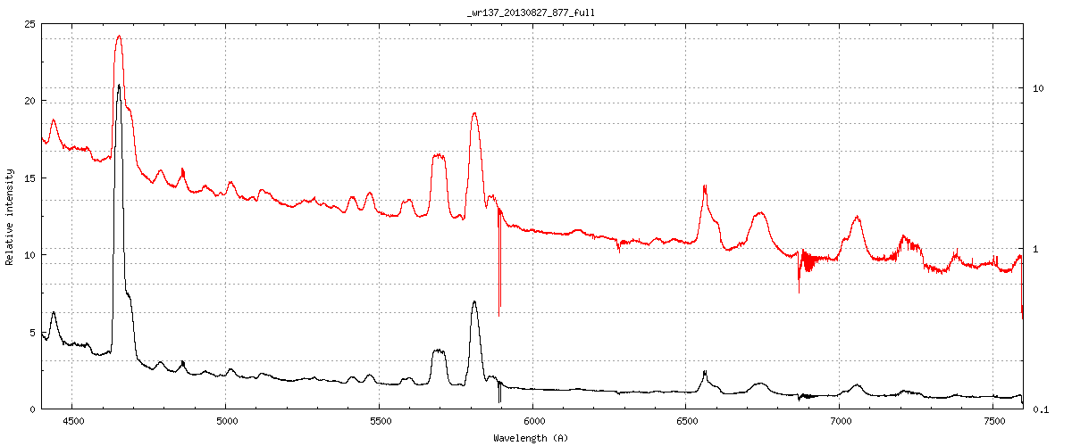

Beiträge: 265
Wohnort: Maienfeld, Schweiz
Hi Thomas,
here the latest results, including WR1! The FITS files can be found on the Montreal server.
Now I will take a break for a few days. More next week.
Cheers, Martin
Dateikommentar: Nova Del 2013
_novadel2013_20130827_932_fullg3.png [ 13.58 KiB | 28119 mal betrachtet ]
Dateikommentar: WR137, red curve: log scale right hand side
_wr137_20130827_877_fullg3.png [ 10.95 KiB | 28119 mal betrachtet ]
Dateikommentar: WR1
_wr1_20130828_194_fullg3.png [ 7.66 KiB | 28119 mal betrachtet ]

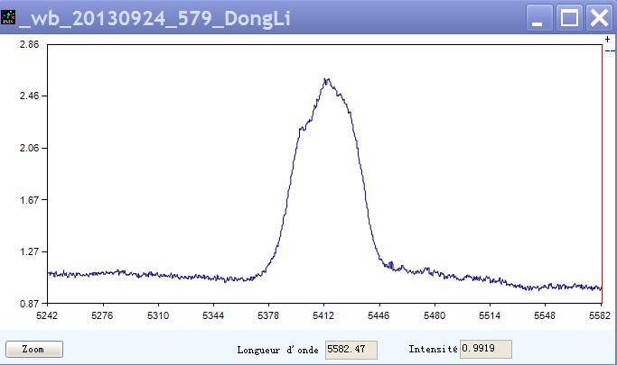

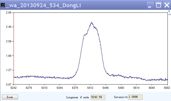

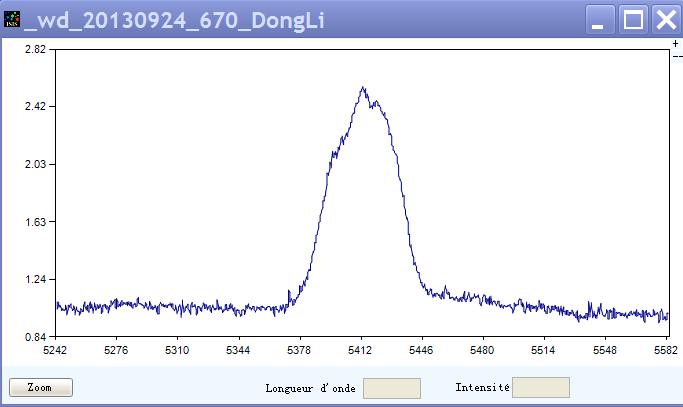

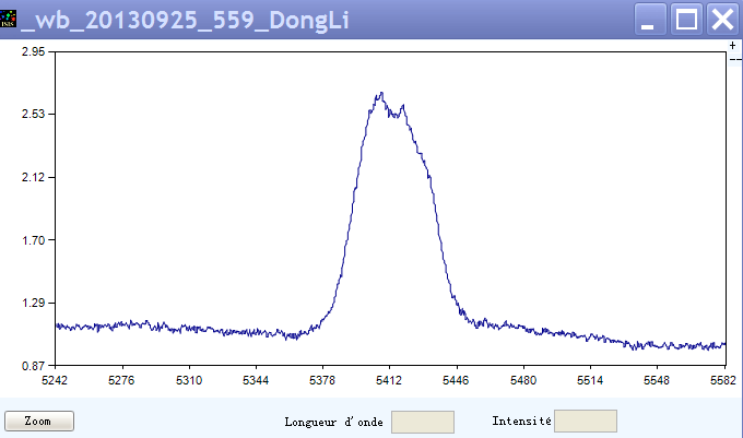

Hi all:
here are some results. To observe continuously for 4 hours. The last hour's result shows more noise, as WR134 located near the west part of the sky which has much more water vapour and light pollution.
zet-Aql.jpg [ 26.2 KiB | 27456 mal betrachtet ]
134-4.jpg [ 28.53 KiB | 27456 mal betrachtet ]
134-3.jpg [ 28.7 KiB | 27456 mal betrachtet ]
134-2.jpg [ 28.25 KiB | 27456 mal betrachtet ]
134-1.jpg [ 27.29 KiB | 27456 mal betrachtet ]

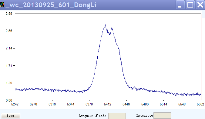

BeitragVerfasst: 26. September 2013, 04:04:49 AM
Beiträge: 49
Wohnort: Tianjin, CHINA
2013-09-25:
there are some obvious changes.
134-3.png [ 25.19 KiB | 27422 mal betrachtet ]
134-2.png [ 25.61 KiB | 27422 mal betrachtet ]
134-1.png [ 25.17 KiB | 27422 mal betrachtet ]

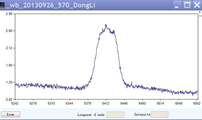

BeitragVerfasst: 27. September 2013, 03:57:21 AM
Beiträge: 49
data of 20130926 of WR134.
TIME: 2 hours continuously; a little wind
134-2.png [ 28.15 KiB | 27376 mal betrachtet ]
134-1.png [ 27.42 KiB | 27376 mal betrachtet ]

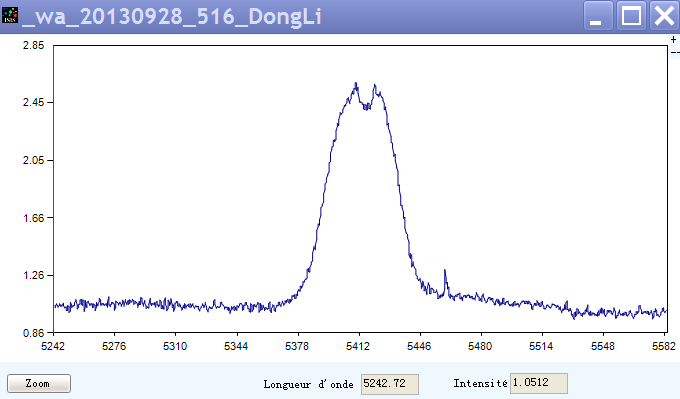

BeitragVerfasst: 29. September 2013, 03:48:09 AM
Beiträge: 49
data of 2013-09-28 of WR134
TIME: 3 hours continuously
134-3.png [ 28.58 KiB | 27332 mal betrachtet ]
134-2.png [ 27.96 KiB | 27332 mal betrachtet ]
134-1.png [ 27.25 KiB | 27332 mal betrachtet ]
