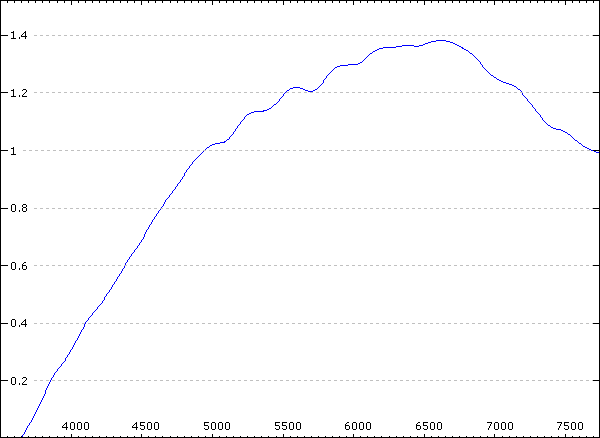

I tried calculating the instrument response using the spectrum of Sirius. It looks similar to the waves in the ICX254 response.
Dateikommentar: instrument response calculated from Sirius spectrum
typ_b_m_s__207_response.png [ 4.07 KiB | 3499 mal betrachtet ]

Hello Robin and Lothar,
yes, I agree with Robin that the "bands" are caused by the CCD-sensivity of the ICX254AL. They exist in nearly all my spectra corresponding to the spectral sensitivity plot.
Thank You Robin for calculating the sensivity respose. I haven´t done it so far. It shows the "bands" very good. But I fear the response curve may be falsified because of sharpening and increasing the contrast.
Hi Roland,
Yes, I think you are right. (Also the background has to be subtracted). I tried correcting the Pollux spectrum but I had to use a different response curve. The corrected result is very good though compared with the standard Pickles spectrum. Once the broad bands are removed, all the other lines are real :-)
