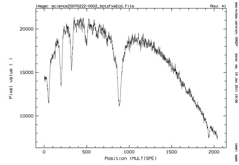

BeitragVerfasst: 19. Januar 2011, 20:10:57 PM
Hello Robin,
with MIDAS there is no problem to read and to work with that file.
It's the spectrum of eps Aur.
See annex.
It's a echelle spectrum, no calibration. 2043 Pixels and 83 orders. All details in the header.
You can also open the file with
fv: FITS Viewer and Editor (version 5.2.1)
and see the file, its header and the 83 orders.
RobinsFile.gif [ 33.45 KiB | 4400 mal betrachtet ]
BeitragVerfasst: 19. Januar 2011, 23:36:52 PM
muß mich korrigieren.
Im header des files steht für jede Ordnung die Anfangswellenlänge drin und die Dispersion (A/pix). Also lassen sich die Spektren auch in kalibrierter Form darstellen.
spec23 = "23 8' WAT2_103= '7 2 6500.7926287096 0.041059415680497 2043 0. 725.91 730.59 0.966365'........
Das Spektrum ist unten zu sehen (Halpha-Linie), in nicht kalibrierter Form. Aber die Kalibrierung ist aus den Angaben rekonstruierbar (und mit dem richtigen MIDAS-Befehl wahrscheinlich auch direkt darstellbar).
order23.gif [ 29.41 KiB | 4376 mal betrachtet ]
BeitragVerfasst: 20. Januar 2011, 01:16:11 AM
Ah, now we are making progress. But what are the other numbers for each order in the header? Also the file has three layers, not just the flux What are the other layers? Also why is the blaze still in the spectrum and how can I remove it without a flat? I think I need to go back to the STELLA team for more help and get a definition for the file.
Thanks for your help
BeitragVerfasst: 20. Januar 2011, 15:29:39 PM
Hello Robin,
Otmar has made a script for the reading and extraktion of the normalized spectra of all orders.
Flats and so on, the complete data reduction procedure is made in the data. Also the normalized spectra are written in.
The Midas procedure of otmar is running on my laptop and gives the orders spectra (calibrated and calibrated + normalized) as fits. Very fine script.
Are you able to run MIDAS? If not, then I can reduce the spectra for you. The 83 spectra, extracted of your file, I will send you by E-mail.
