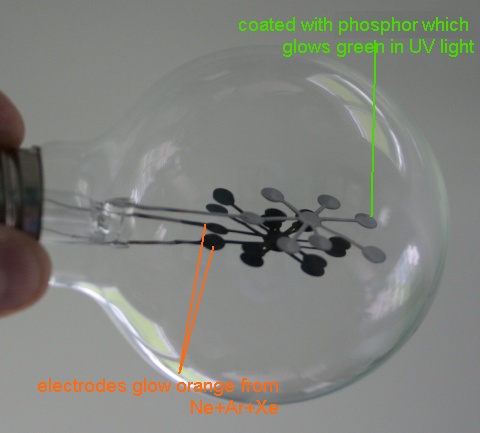

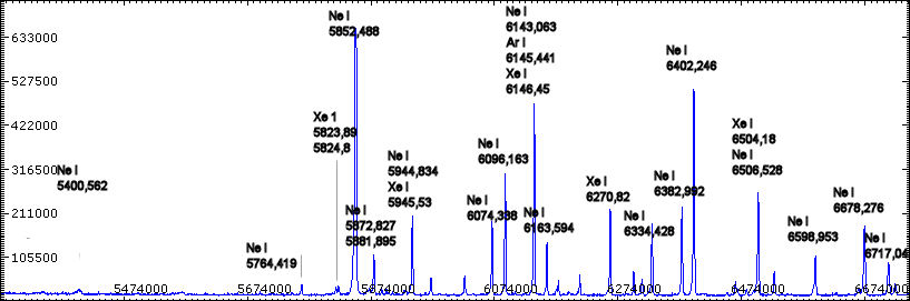

Hello Fil,
My Filly lamp has now arrived so I can answer the questions.
Neon lamps have a resistor in series to limit the current. The resistor is larger for 250V compared with 110V. The brightness can still be the same. The glass of the filly lamp is cold of course but the base is quite hot. The resistor must be in the base.
There are three electrodes in the filly lamp. Two are are close together and are connected to the electrical supply. These produce an orange glow when the electricity flows through the gas between them. The third electode is coated with a phosphor chemical which glows green when the uv light from the glowing gas excites it. It is not connected to the electricity. The green light from this electrode is not useful for calibration because it is a broad continuum.
The lamps are not expensive because they are quite simple and are made in China in large quantities.

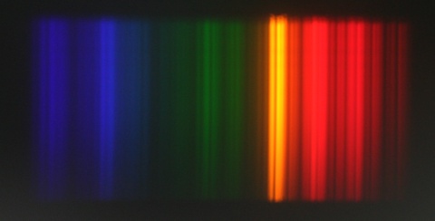

I have attached a quick badly focussed spectrum taken with my hand held spectroscope showing the wide range of lines (Ne is strongest but the other lines in the blue and green from Ar and Xe are also useful)
filly_lamp.jpg [ 46.08 KiB | 64107 mal betrachtet ]
Filly_dot_lamp_spectrum.jpg [ 20 KiB | 64107 mal betrachtet ]

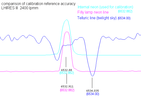

BeitragVerfasst: 22. Juni 2011, 12:58:24 PM
Beiträge: 178
Wohnort: Melbourne, Australia
I can confirm what Robin said, the Filly bulb lines are very narrow, and not very intense. Attached is a recent 200A wide simultaneous exposure of del Sco in the HeII (4686A) region with the Filly (argon only) bulb in front of my C11 corrector plate. The total exposure is one hour and the argon lines are still narrow and there is certainly no sign of saturation.

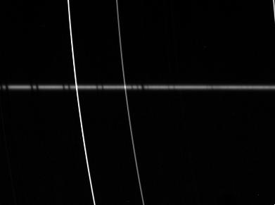

My Filly lamp has arrived and I was a bit disappointed that the intensity is so low.
It is just a glow around the electrodes. Can be used for direct illumination, but not with a diffuser (to get homogeneous slit illumination).
As a workaround one may move the lamp over the aperture during the long exposure, to get some sort of complete slit filling.
For me this is not critical, since I'm slitless on stars, but for accurate radial velocity determination this may be an issue.
Attached some pics from the echellette prototype spectrograph to illustrate what I measured. I used 2x3 binning (so sharpness cannot be judged) to keep integration times lower.
From top to bottom:
- 60s neon fluorescence tube (car tuning part :-) )
- 60s filly lamp
- 300s filly lamp, 5x contrast enhanced (factor 25 w.r.t. 60s image)
As comparison for the wavelengths:
- Sky light (unbinned) 2nd order from bottom shows H-alpha and O2-B, 4th order from bottom H-beta at left and MgI triplet at right, upper order has at left the G-band and H-gamma
Sander
smette_P7_sky_20s_full_max1925adu.jpg [ 168.5 KiB | 63983 mal betrachtet ]
smette_P7_filly_300s_max385adu.jpg [ 77.35 KiB | 63983 mal betrachtet ]
smette_P7_filly_60s_max1925adu.jpg [ 15.96 KiB | 63983 mal betrachtet ]
smette_P7_neon_60s_max1925adu.jpg [ 17.6 KiB | 63983 mal betrachtet ]

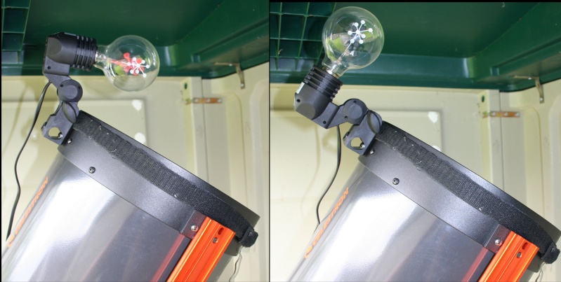

BeitragVerfasst: 25. Juni 2011, 14:49:09 PM
Hello Sander,
There is no need to move it around the aperture, just mount it in line with the slit. (see a attached. My slit is orientated in the Dec direction) My checks compared with Tellurics show Kr lines near 7699A it to be correct within the measurement error (1km/s)
You can even leave it in place during the exposure. The loss of light is only about 0.1 mag on a 280mm aperture. See also Buil's tests here.
http://astrosurf.com/buil/isis/He_calib ... method.htm
Dateikommentar: Filly dot lamp mounted on C11
Filly_lamp_mounting.jpg [ 106.6 KiB | 63973 mal betrachtet ]

It would be nice when you place your 2D-spectrum obtained with this configuration in this forum.
I have already made some comparisons of the accuracy of the Ne lines near H alpha and Kr lines near 7699A with the telluric lines. The lamp lines agree with the telluric lines to better than 0.03A (1.5km/s)
Attached is the result for epsilon Aurigae at 7699A (the range is 7670-7720A at 0.3A resolution) the two lines are Kr from the Filly lamp. The exposure is 6 x 600 sec. There is also a double Ne line just to the right of the field which could be used by moving the wavelength a bit.
epsaur_ki_27jun11.jpg [ 4.32 KiB | 63858 mal betrachtet ]
BeitragVerfasst: 30. Juni 2011, 16:57:40 PM
Here is a comparison of the accuracy of the LHIRES internal neon, telluric line (twilight sky) and filly lamp near H alpha.
The calibration was made with the internal neon amd the filly lamp and telluric lines were compared with this. The differences are small but in this case the telluric line wavelength would have been closer to the publiahsed value if the filly lamp had been used instead of the internal neon.
bl-skytelluric_pnk-fillylamp_cy-intenalneonrefcal.png [ 6.79 KiB | 63856 mal betrachtet ]

hier ist das Spektrum der Filly-Lampe. Leider konnte ich nicht alle Linien zuordnen. Ich bin mir auch nicht sicher, ob meine Angaben immer richtig sind. Insbesondere bei den Ionen Xe II und Xe III bin ich mir unsicher, da besonders letztere bei Glimmentladungen nur sehr selten vorkommen dürften. Vielleicht kann mir jemand von Euch weiterhelfen. Die mm-Angaben im Dateinamen beziehen sich auf die Einstellung der Mikrometerschraube. Verwendet wurde ein Lhires III mit 600 L/mm. Kalibriert habe nur mit zwei Linien, daher können zwischen der Skala auf der x-Achse und den Wellenlängen der einzelnen Linien leichte Unterschiede auftreten.
filly_5mm_spektr_2.jpg [ 49.55 KiB | 63437 mal betrachtet ]
filly_5_5mm_spektr_2.jpg [ 48.05 KiB | 63437 mal betrachtet ]
filly_6mm_spektr_2.jpg [ 51.03 KiB | 63437 mal betrachtet ]
