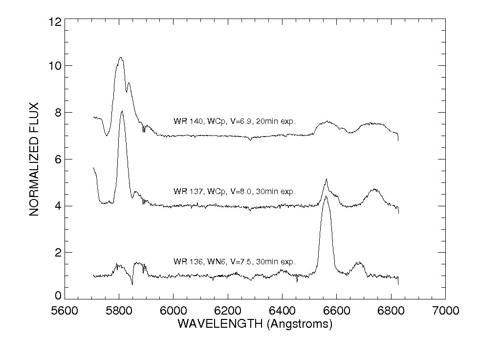

Hello Thomas and all other friends,
this campaign seems to me very interesting. So I would like to join it....and thanks for your efforts to create a new ProAm campaign !
But the measurements on such faint stars ( 8.3 mag) are a big challenge for me and my optical set (C14, Lhires III slit littrow).
But there is a chance (and Robert Trambley realized it). Taking the 1200 or the 1800 g/mm grating and a slit with of 35 to 50 micrometers there should be possible S/N > 100 in 1 h observation time (R ~ 4,000 to 5,000 ~ 1.2 A resolution, dispersion 0.2 A/Pix, see annexe).
Because my ThAr-calibration unit (light injected over a fiber) I can deliver also calibration spectra in the spectral region < 550 nm.
I'll take first exposures in the next time to test my set. Then we can decide if my contribution is of interest.

BeitragVerfasst: 10. Dezember 2011, 17:02:42 PM
A big challenge for me also. I could perhaps get SNR >100 at 2.5A resolution with my 280mm aperture C11 and LHIRES with a 600l/mm grating.
I think there are not many amateur spectroscopists who have enough aperture (>=0.5m?) to meet the target of 1A resolution at 200 SNR in 1 hour on these targets.

Hi all,
Here is an example of WR140 taken by Christian Buil using an eShel echelle spectrograph (native resolution ~0.6A) filtered to ~0.8A resolution (red line)
http://astrosurf.com/buil/eshel3/wr140_2.png
from this page
http://astrosurf.com/buil/eshel3/review.htm
This was a 35 min exposure using 280mm aperture
Vmag are: WR140 6.9 WR134 8.0 WR135 8.1

Also on the same page A0p star HD215441 at Vmag 8.6 using 90min exposure uisng the same equipment
http://astrosurf.com/buil/eshel3/hd215441.png
The SNR at this magnitude is clearly < 100 though

Yes, ok Robin, but you must see, that shelyak' s echelle cannot be considered as an echellespek made by amateurs.....
cheers berthold

 Betreff des Beitrags: WR 136, 137, 140 with LHIRES III
BeitragVerfasst: 13. Dezember 2011, 23:34:38 PM
Beiträge: 65
Wohnort: Montreal, QC
We have a new LHIRES III spectrograph at our observatory. This summer, we obtained spectra of 3 WR stars (136, 137, and 140) with a 600 g/mm grating and an SBIG ST-8 camera. The dispersion (in the red) was ~0.75A/pix and the spectra are shown below. These were obtained with the instrument on a 20-in, f/8 telescope. Exposure times are given in the figure. These are not an ideal set-up for this campaign, but are good test exposures.
I would be willing to share these files with people that were interested in seeing the data quality during these initial planning steps.
I will also post another idea I had about using Hubble.

 Betreff des Beitrags: Technical meeting point
BeitragVerfasst: 14. Dezember 2011, 01:34:21 AM
Hi Noel,
What slit width did you use? Did you measure the resolution? (The FWHM of the neon lines). I suspect that the resolution is well short of the 1A specified for this project. An 1800 line grating with a 50um slit width like Lothar is proposing with his C14 might give a good result with a 20 inch aperture though, provided your seeing is good (What is your typical star FWHM at your observatory?)

 Betreff des Beitrags: Re: New ProAm campaign in 2013
BeitragVerfasst: 14. Dezember 2011, 01:42:33 AM
Registriert: 03. August 2011, 00:07:22 AM
Beiträge: 10
Wohnort: Vina del Mar, Chile
A 1.5 magnitudes difference is a factor ~4 in flux (hence a factor 2 in S/N). If you could reach a S/N of 200 in one hour with WR140, you will reach a S/N of ~100 for WR134,5,7 with the same exposure time. If it is the case, it is time to explore deeper space 8-) !!!
