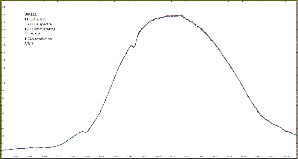

BeitragVerfasst: 13. Oktober 2012, 05:06:03 AM
Beiträge: 178
Wohnort: Melbourne, Australia
Hi Tony,
I have switched to a 1200 grating, giving a 1.24A resolution and 345A window and have used it to monitor the CIV 5805 line on WR111, a test target. The attached series of three 800s exposures shows some, presumably wind, variability of CIV, a line so strong that I have to limit exposures to 400s to avoid saturation! Is there any value in trying to detect such short variations? If not, what is the shortest cadence we should aim for, or is it as long as it takes to have SNR=200?
Cheers, Bernard

BeitragVerfasst: 14. Oktober 2012, 01:25:25 AM
Beiträge: 101
Wohnort: Montreal
Hi Bernard:
Yes, CIV is VERY strong in this star. But it is a doublet (5802/5812) and does not vary (% wise) nearly as much as its neighbour CIII 5696, which is THE line to observe, even if it?s a lot weaker! Try it and you?ll see relatively much larger variations over timescales of several hours (full timescale is about 10h). Normally, observations shorter than about an hour do not show much variability, although that does depend on the details (e.g. which star).
Best, Tony
