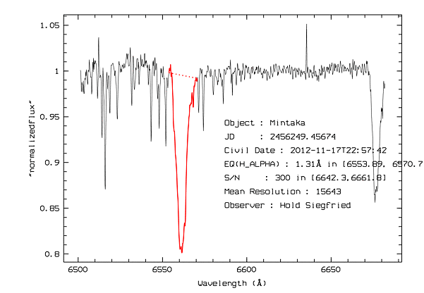

BeitragVerfasst: 19. November 2012, 22:02:53 PM
Beiträge: 639
Wohnort: Schulberg
Hello,
Mintaka from Saturday exposure with 30 minutes! He 6678 is unfortunately outside the area but the next time should fit better.
greetigs
Siegfried

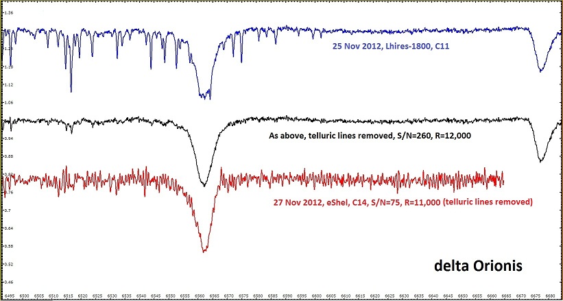

I made a couple of tests this week to see which is my best option for obtaining del Ori spectra and the results are shown below.
The first test was with a Lhires with 1800 grating on a C11 with an Atik 314L+ CCD. After telluric line removel (using a synthetic H2O profile) and continuum removal the S/N=260. As R=12,000 this setup meets the campaign requirements for S/N, R and the the basic H-alpha 6263 and HeI 6678 requirements.
The second test, with a fibre-fed echelle (shown in red, after telluric line removal) on a C14, doesn't meet a campaign requirement, with S/N=73 only. This is despite using a larger scope, so the poorer performance is probably due to fibre losses. So the trade-off is broad spectrum coverage with a lower noise or a narrow band spectra with low noise.
Cheers, Bernard

Hi Bernard,
Wow that is a big loss. (73/260)^2 x (11/14)^2 = ~5% I dont think that much difference between LHIRES and eShel is normal.

Hi Robin,
I fully agree with you and this large discrepancy has been a concern since I've had the eShel. I was about to contact Christian on this problem, using the del Ori data as an example, but would be interested to hear from any other eShel owners on this. One possible explanation, which I've not yet checked, it that there may be a poor fibre cable connection (I've already had to replace one due to breakage). One indicator that the link may be the reason is that my calibrations require longer exposures (for a given SNR) than the norm. Any other possible suggestions welcome, from all.

Hi Bernard,
can you exclude autoguiding problems as an additional reason? It is much more difficult to keep the star at the small entrance of a fibre than on a long slit.
What kind of fibre is used by your echelle, single or multimode?

Hi Bernard,Robin is right the difference cannot be a fiber loss. Fiber feed spectroscope are less efficent than a slit spectrograph but not so. If we consider only hardware problem here are some tracks to help you:
-Check you F ratio, it is better to be at f4 to f5, best fit with eshell f ratio and  it can compense the fiber loss.
-You said that it take more exposure time for calibration lamp then you may have two problems: Fiber injury. Check with a brand new one. Or misalignment of the hole in the guiding mirror with the fiber head. It is very common, you can loose easely 2/3 of the flux without loosing signal. I used to check it first when i have a poorest signal. The procedure is undocumented but i can explained it to you.
 I have a snr of 250 on gam cas in 30mm, with a st10 and a C14 under optimal conditions. Well you cannot check on this star and i didn't make any test on delta orionis. I will give a try this week end for comparing both result but these star are in same range of magnitude.

Hi Bernard:
The high S/N spectra look fine. Maybe you could shift the wavelength a bit, though, to include well both lines, H-alpha 6562 and HeI 6678.

My responses to the last postings from Christian, Thierry and Tony:
Christian,
I am confident that autoguiding is not the problem and the fibres are multimode silica.
Thierry,
I agree that normal fibre losses are unlikely to be the problem and that an 'injury' might be the cause. Not so easy to check by swapping with a brand new Shelyak fibre as these are expensive and I don't have a spare. I do have a cheap (not armoured) Chinese fibre that I can check with. Thanks for the suggestion on the alignment testing. Based on guide camera FOV measurements I believe the FR is ok. I would be interested to see what results you can get with del Ori!
Tony,
I have already shifted the spectra to better include both H-alpha and the HeI lines but have been unable to make more tests due to our unstable weather ... we just had our hottest November day on record, which leads to stormy skies. If I can improve my echelle's performance I will make further tests with that setup.

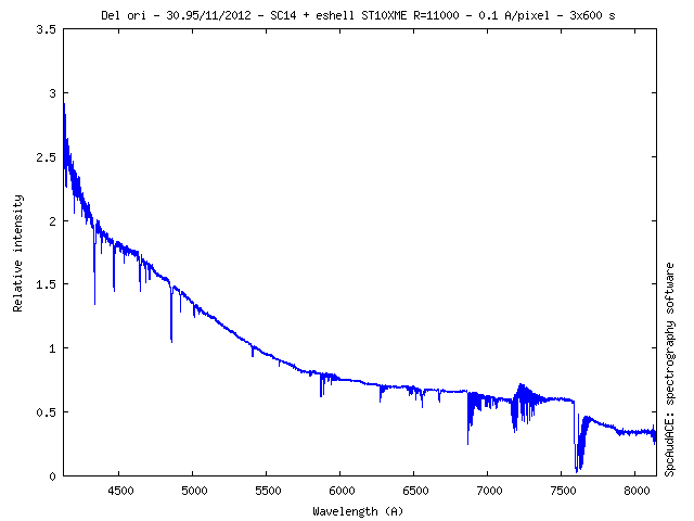

BeitragVerfasst: 01. Dezember 2012, 19:58:52 PM
Beiträge: 63
Wohnort: Montpellier

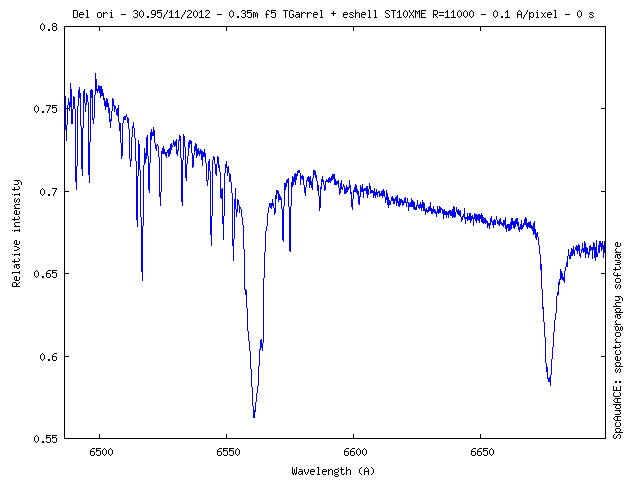

Hello,finally had a clear and frozen sky over my head to make a test. Prefer to observe Orion from Australia for sure.
Transparency was perfect, seeing very bad, i took a spectra of delta orionis at 40° altitude with my eshell setup, 0.35m f5 telescope, Sbig ST10XME camera. In half an hour SNR is of 260 as expected. It could be better with a better seeing, around 300. Instrumental response was done on vega, i did not make a normalization around h alpha.
Thierry

BeitragVerfasst: 01. Dezember 2012, 21:15:21 PM
Beiträge: 101
Wohnort: Montreal
Dear Thierry:
Very nice ? congratulations! But I hope you can also make occasional observations of a telluric standard star, e.g. any fast-rotating A-type star, at similar airmass. Once the campaign officially starts on Dec 17 (lasting until Jan 7) I hope you can get many spectra over many hours on all clear nights of delta Ori during that period!
Best regards, Tony

BeitragVerfasst: 01. Dezember 2012, 22:49:35 PM
Beiträge: 63
Thanks Tony;Attached is a merged spectrum of 27 échelle orders spanning 4130 to 8150A at 0.1A/pix. Could you comment which lines beside h alpha and heI6678 (he5876 seems saturate ?) are of interest ?
Ok for a telluric star at same airmass.  At witch cadence we have to take spectra during the campaign.
Thierry
Thierry

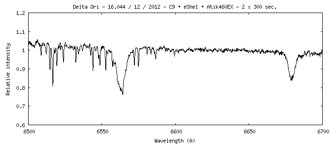

Here a part of a typical eShel spectrum (R=11000) of Delta Ori taken with
a medium sized telescope - Celestron 9 D = 235 mm (under not ideal atmospheric and seeing
conditions):
and now detail of Halpha line extracted from the same spectrogram:
For discussion, my prefered option concerning H2O telluric lines pollution is the division by a synthetic spectrum for removal. Here the result
(processed by using ISIS, but many software implement similar function, Vspec, proprietary application, ...):
The efficiency of the method is proved by many here of experience (I use GEISA atmospheric model).
Also, the procedure is
- less time consuming (because the very bad weather, observation of
target objet + calibration object in the same run is not always evident)
- less noisy (the synthetic spectrum is clean of noise)
- excellent method for ultimate spectral calibration precision and check (superposition
of synthetic H2O and observed H2O lines).

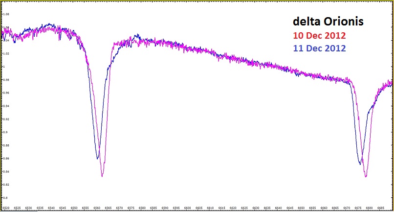

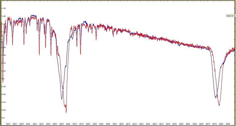

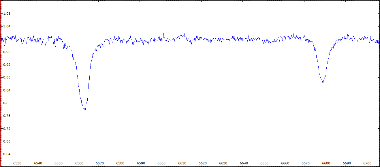

I was interested by the profile and velocity variation of the H-alpha and HeI lines over two consecutive nights (10th and 11th December). The RV shift is about 90 km/s, so is this the behavior we should expect to see for delta Ori?
I've included the 'raw' spectra with the telluric lines, to show that the wavelength calibration is ok.
Cheers, Bernard

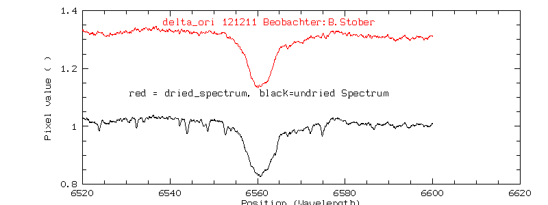

BeitragVerfasst: 12. Dezember 2012, 22:05:50 PM
Hello,
here you see the result from delta ori 121211 from 6520 - 6620 dried and undried!
I used the very comfortable program from Peter Schlatter to dry the spectrum.....
Cheers, Bernard

Hello,
now there you see my spectrum frm beta ori_121211.
Christian:how do you proceed te remove the waterlines with isis? I load the full spektrum , normelize it, and then I look with 0.25 and play with the reglage but don't see a good result. I think, I do something wrong.....Bild

Hello,
Here's a profile from 12.12.2012
exp. time = 30 min
S / N = 218 (6620-6650)
R = 13000
greeting
Siegfried
Mintaka-12122012.png [ 24.6 KiB | 32483 mal betrachtet ]

Your spectra from 10-11 Dec are great! It looks like you are picking up signs of the secondary! (the indentations on the red side of the lines in the blue spectrum.
 Betreff des Beitrags: 16.044 / 12 / 2012 obs.

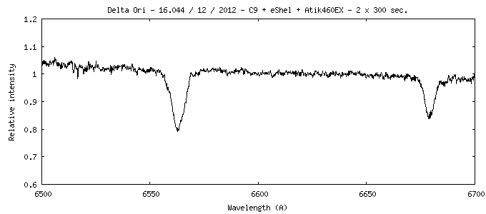

Part of an eShel delta Ori spectrum taken the 16.044 / 12 / 2012 during
a very short ten minutes weather windows (!).
Note relatively modest SNR of 175 because bad weather conditions...
Christian Buil
Dateikommentar: Detail of Halpha line.
_deltaori_20121216_044_h2o_cbuil.png [ 3.73 KiB | 32395 mal betrachtet ]
Dateikommentar: Halpha + He II after H20 telluric lines removed (synthetic telluric spectum method under ISIS)
_deltaori_20121216_044_h2o_cbuil_2.png [ 4.06 KiB | 32395 mal betrachtet ]
Dateikommentar: Observed spectrum (during a cloudy night - only 2 x 300 sec equivalent exposure).
_deltaori_20121216_044_cbuil.png [ 4.33 KiB | 32395 mal betrachtet ]
