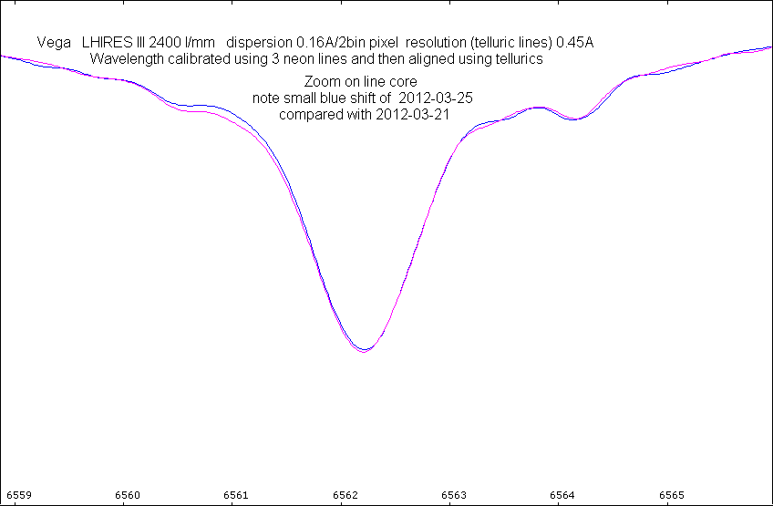

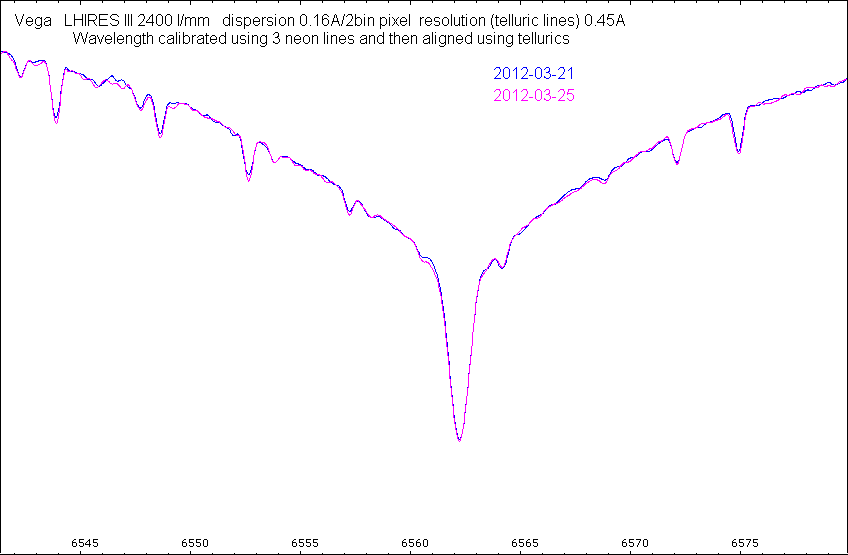

BeitragVerfasst: 09. April 2012, 16:35:25 PM
Hi Thomas,
Here is a practical example.
Fig 1 shows 2 spectra of Vega H alpha taken 4 days apart (The spectra are not special. They are controls for some measurements of CH Cyg.) the spectrograph was used at other wavelengths and refocussed between these two dates. (I would not recommend this when planet hunting :lol: )
The spectra were calibrated using the internal neon and then offset to align them using the clear telluric lines (Vega was at quite a low elevation)
Fig 2 zooms in on the line core. We can see a small blueshift offset of the pink line.
Fig shows this offset removed (0.007A or 0.36km/s)
We of course also need to do a heliocentric correection. This is 0.005A (0.22km/s) between these two dates so the residual error between the two measurement of the Vega H alpha line core is just 0.002A or 0.1km/s

BeitragVerfasst: 10. April 2012, 13:06:54 PM
Very well! Resolving power about 40.000. What is your pixel sampling?
BeitragVerfasst: 11. April 2012, 14:40:26 PM
Hi Thomas
Not resolving power but line centroid measurement. These two are very different problems. The resolution and bin size are on the spectra (resolution 0.45A or R~15000 and the bin size is 0.16A/bin (2 pixels). I cannot resolve 2 lines closer than 0.45A but I can detect a much smaller change in the centroid of a line.
In the examples I showed, the spectra have been upsampled to 0.02A/bin to make it easier to see the small sub bin size shift.
There is no need to upsample do the centroid calculation though. In the original spectrum, this small shift is seen as a change in ratio between the flux in adjacent bins.
A simple example:
take a rectangular shape line exactly 2 bins wide with a value of 1 in each bin. If the line shifts in wavelength by 0.1 bin, the values in the bins become 0.9,1.0,0.1 and we easily detect the shift.
BeitragVerfasst: 11. April 2012, 17:03:52 PM
Very well, Robin, now I understand the approach. Thanks for the explanation.
The present work obviously did not use that idea. Instead, it uses a "fit" of the H line (well, not a fit but an "adjustment" via FWHM) of a Gaussian and using the Gaussian center for the radial velocity. Now I understand the reason for the obvious shift between the "fit" and the line in fig. 15. :!:
As a result I presume that even your assumed maximum accuracy of about 1 km/s is not achieved there. Figure 15 gives an idea of about, say, 0.2 Angstroms shift between the "fit" and the line. That would be about 10 km/s.
Cheers, Thomas
