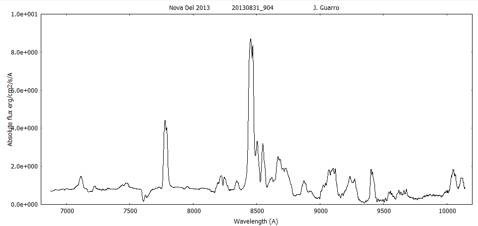

Franck Boubault
IR from Joan Guaro : up to 10 000 A !
*Absolute flux calibration : two methods*
