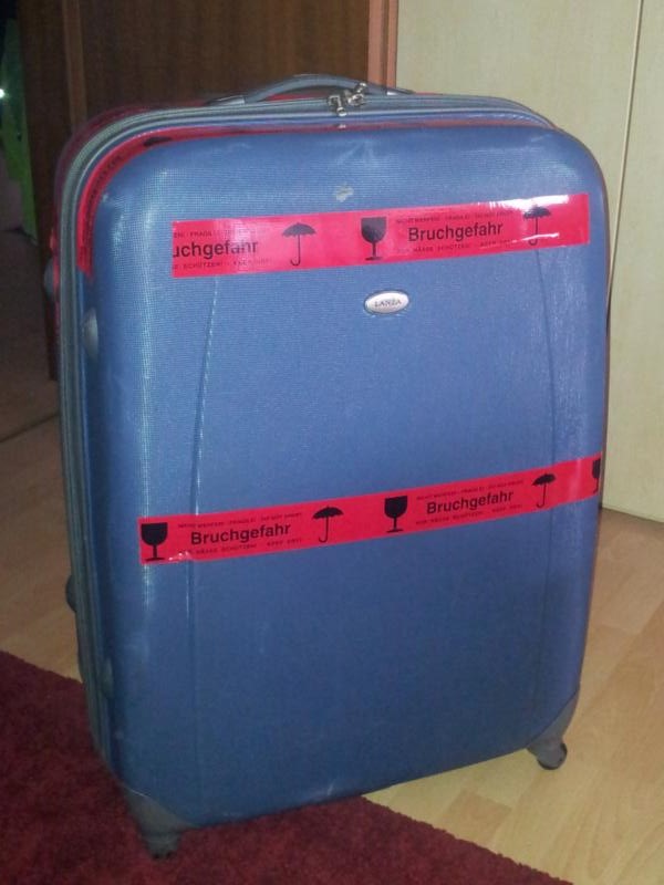

Hello together,
here our instrumental luggage waiting for transportation.
The coming night we are going to Tenerife. Perhaps we'll give first signals from Teide tomorrow in the evening, I hope so.
K800_20130516_150306.JPG [ 91.92 KiB | 59480 mal betrachtet ]

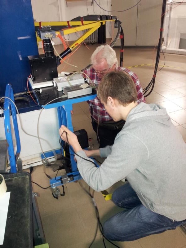

BeitragVerfasst: 18. Mai 2013, 17:13:32 PM
Hello,

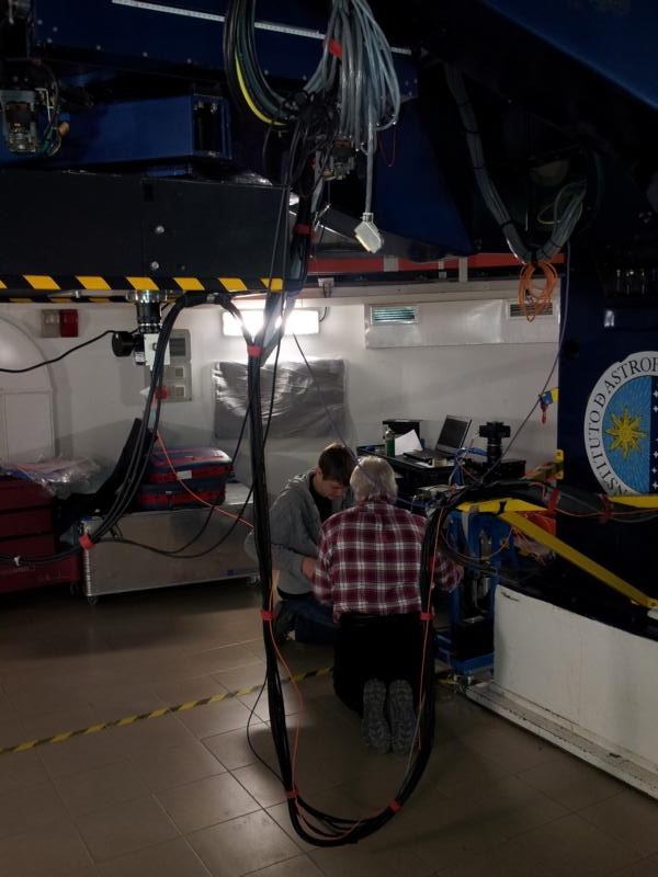

Lothar, Daniel Weiss, Dalila, my wife and I we arrived today at the Inzana Observatory . We have absolute clear and very dark sky. Tomorow we Start the installation of my eShel Spe trograph Form Shelyak at the IAC 80. I hope, we can deliver Fiat eShelspecta at sunday...for the first, I shall take spectra from dela scorpii and 66 ophiuchi . Which other stars are proposed, for first tests except the program stars?
18.5 2013
We were odered to be at 9:00 am at the observatory, at 10:00 arrived someone and we could start the installation of the eShel The aluplate I machined is perfect. But we have mo tungsten light in the calibration unit. We have had much to do, to find out the reason. The very,very friendly staff of the IAC 80 helped us some hours(!!). The reason: the tungstenlamp is defect. So we can not make tungsten flats.......a big problem. Thomas please contact Olivier or François . They must send us so fast as possible such a lamp to the Teide. I think you can organize this.
The next problem is, Lothars laptop and the software on it will not Match with my NovaCCD. I installed the correct program to drive the NOVACCD but there was some problems with Administrator rights and so on. In my hands the NOVACCD was working with se software I installed. After this Lothar took the laptop bck to Mannheim and has done some changes with this laptop . The effect : the Nova will not run with the software on Lothars laptop. I have no installation CCD with me. So we have to contact Gerhard Fischer, I have done this by email already but perhaps, Thomas, could you try to phone with ihm? He have to send us the installion files per email for my NOVACCD 3200 . That is very urgend! If we have no running pc software and no callibration unit....the campaign is in danger.
BeitragVerfasst: 18. Mai 2013, 17:20:10 PM
First big problem :
The tungsten filament in the halogen lamp of the calibration unit is broken during the travel. So we are not able to take flats.
The technical stuff is very kindly. He has opened the unit and has changed the broken lamp by a normal tungsten lamp we have organized at VLT. so we are able to work but only for tests.

BeitragVerfasst: 19. Mai 2013, 03:14:04 AM
Like anytime the first day and night was very interesting :roll:
Broken halogen lamp, repairing and improvisation....
Then broken calibration light fiber, very surprising :wink:
But we have a second one (manufactured by Daniel Sablowski, Daniel, thank you !).
Treiber problems with the CCD, but we use a other Laptop :D
And problems with the adapter and integrated Shapley lens: but we remove the distance pieces (for focusing)...and it works.
Improvisation is the word of the day.... and we got the first spectra..but not with the FOVIA-system...only by manual guiding...we are so happy :shock:
An unforgettable day and a wonderful sky (Daniel looks continously with the binoculars into the sky...).

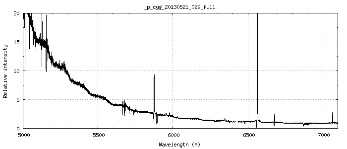

BeitragVerfasst: 19. Mai 2013, 20:17:37 PM
Beiträge: 265
Wohnort: Maienfeld, Schweiz
Hello all,

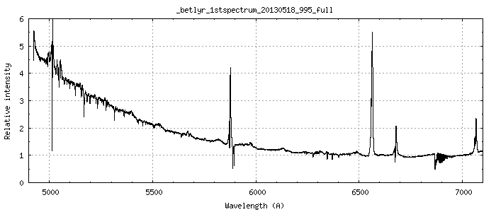

I have downloaded the first data and processed the first test spectrum. Needs some fine tuning but in principle it works. I am in contact with Lothar for the details. Without Instrument response.
The campaign has started successfully, despite some initial problems.
Data transfer works.
Spectrometer works.
Data can be analyzed.
Wait for the first WR spectrum!
More to follow.
Martin
Dateikommentar: erstes Spektrum vom IAC! Beta Lyrae zum testen
betLyr_first_Spectrum.png [ 4.68 KiB | 59270 mal betrachtet ]

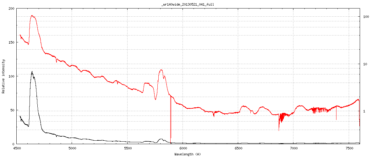

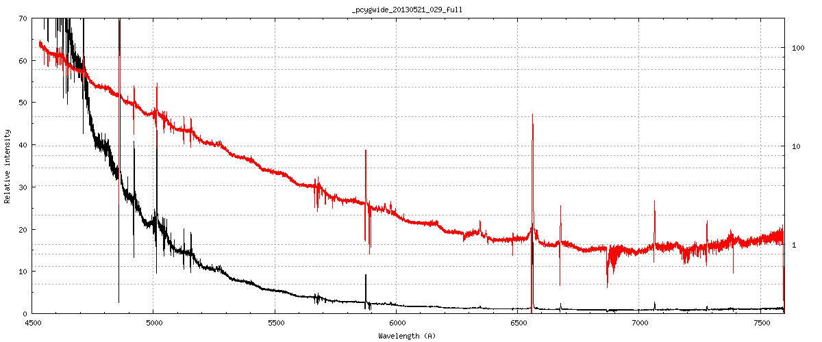

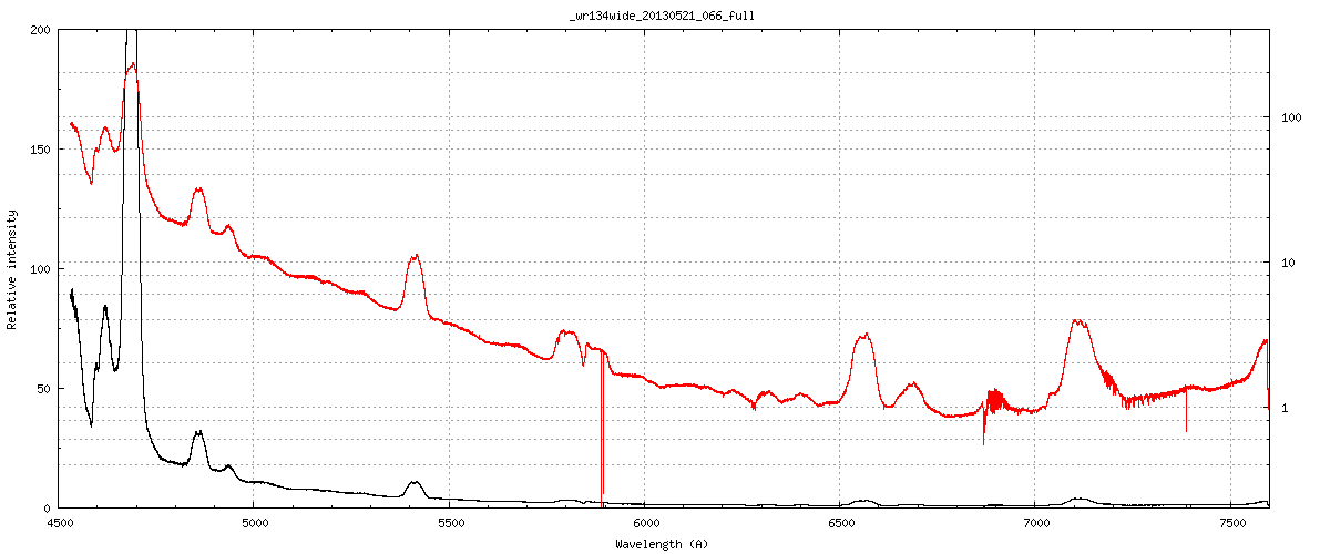

This night we spectroscopied WR 140 and some other stars and later in the morning also our target stars WR 134, WR 135 and WR 137 (each 4 x 600s). All by manual guiding ( :roll: ). The HD 160529 and HD 316285 were not observable with the IAC80 (outside the geometric suitable range of the telescope).
The next 3 days the IAC80 is occupied by an other project team (Friday we can work). We have therefore to uninstall our fiberinjection unit at the end of this night.
To do:
* Change of the Tungsten bulb in the calibration unit when the new bulb is arrived.
* Writing instructions and docus.
* Matching of FOVIA and telescope focus range for autoguiding (to do by the maintenance).

BeitragVerfasst: 21. Mai 2013, 23:47:07 PM
Beiträge: 265
Hi all,
I have started analyzing the data with ISIS.
Some comments:
- The spectra look much better than two days ago, well centered and correct intensities. Because of the centering some parameters had to be adjusted (X, Y, alpha, def_lambda). I will put the new values on the FTP server
- For analysis with ISIS the camera should be rotated somewhat (about 1 degree) so that the ThAr lines line up with the precalculated values, see the image below:
The circle should align with the spectral line!
- I cannot make an instrument response since I have no data on Mizar e.g.
- All the test spectra mentioned in the monday protocol are missing on the FTP server but necessary for the checks if the spectra can be analyzed properly. P Cyg and bet Lyr are not suitable for the determination of the response.
- It would be nice to have a spectrum of zet Aql for checking the instrument response. Should not take too long to make!
- There are still some problems with the ripple after merging the orders, as seen in a spectrum of P Cyg.
- There is a small problem with ISIS when averaging 10 bias frames, so I used only 9. I will check with Christian about this.
Apart from this the analysis of the spectra works well.
To finish a preliminary spectrum of WR140, again without instrument response corrected
Keep going and clear skies,
Martin
check2 rotation test.PNG [ 126.19 KiB | 59073 mal betrachtet ]
Dateikommentar: P Cyg without instrument response
_p_cyg_20130521_029_full.png [ 4.4 KiB | 59073 mal betrachtet ]
Dateikommentar: corresponding fit file
_p_cyg_20130521_029_full.fit [182.81 KiB]
527-mal heruntergeladen
Dateikommentar: first spectrum of WR140
_wr140_20130521_041_part.png [ 4.55 KiB | 59073 mal betrachtet ]

Is P cyg is a single 30s exposure as write in the Fit header ?
On both spectra, WR140 and P cyg there is discrepancy of the snr in the blue region, HeII 4686 is out of range. It may came from low exposure, but may come from focus centered on the low orders.
Thierry
2013/5/21 Martin Dubs <fg-spek-convento@vds-astro.de (fg-spek-convento@vds-astro.de)>
Hi all,
Some comments:
Martin

BeitragVerfasst: 22. Mai 2013, 15:49:29 PM
Beiträge: 265
Hello everybody,
I tweaked the ISIS analysis procedure somewhat, so higher orders are extracted as well.
Thierry and Berthold: due to the rotation of the camera, calibration above order 49 did not work. This can be corrected with the next spectra. About S/N at low wavelength, this comes probably from the missing instrument response and a weak halogen flat lamp which multiplies the signal and noise at low wavelength.
For the instrument response I still need some reference test spectra!
This should be fixed as well. In the meantime I plot the data on a logscale, which allows an easier estimate of S/N.
By focusing the camera to the lower and higher orders the spectral range could extended somewhat, with a small reduction of R in the midrange.
As far as I can see, P Cyg is a single 30sec exposure.
For the lowest orders (30 and 31) I had to extend the lines.lst to larger wavelengths.
As mentioned by Berthold, my job is to check the performance of the instrument and to make a quick data analysis possible. This works quite well now.
Still visible is the ripple of the orders, this should be improved if possible.
But for those interested in the science I also add some spectra:
As noted above these are test only, but science should follow soon.
The merged spectra .fit I load on the server, cannot attach them here.
Regards, Martin

_pcygwide_20130521_029_full.png [ 12.23 KiB | 59018 mal betrachtet ]
BeitragVerfasst: 22. Mai 2013, 17:02:46 PM
hello Martin,
thank you so much for your vital work, which is extremly important for this compagne. As far as the ripples are concerned, you expected that the F-numbers of calibrationlight and starlight are not identical. Now I like to confirm this asumption:
Calibration light comes with F=~5 , star light in the configuration of these first spectra came with F~7.3. This situation will improve due to a further modification which underway now. The shapley will be moved closer to the secondary morror, which should give a faster F-number i.e.closer to F=5
cheers berthold and Norbert
