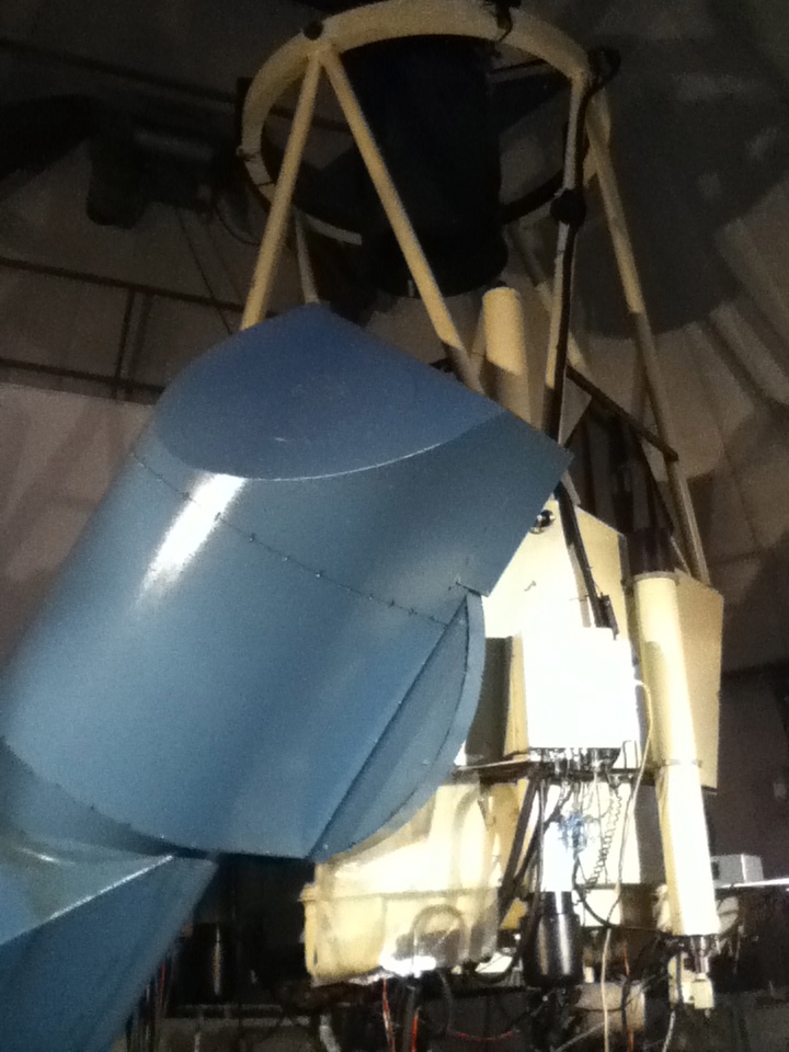

Hi, Nicole,
nice spectrum , indeed, but the telescope , you use is more than the factor 5 larger then the telescope, I can use at time........Do you have pictures from this eqipment ?

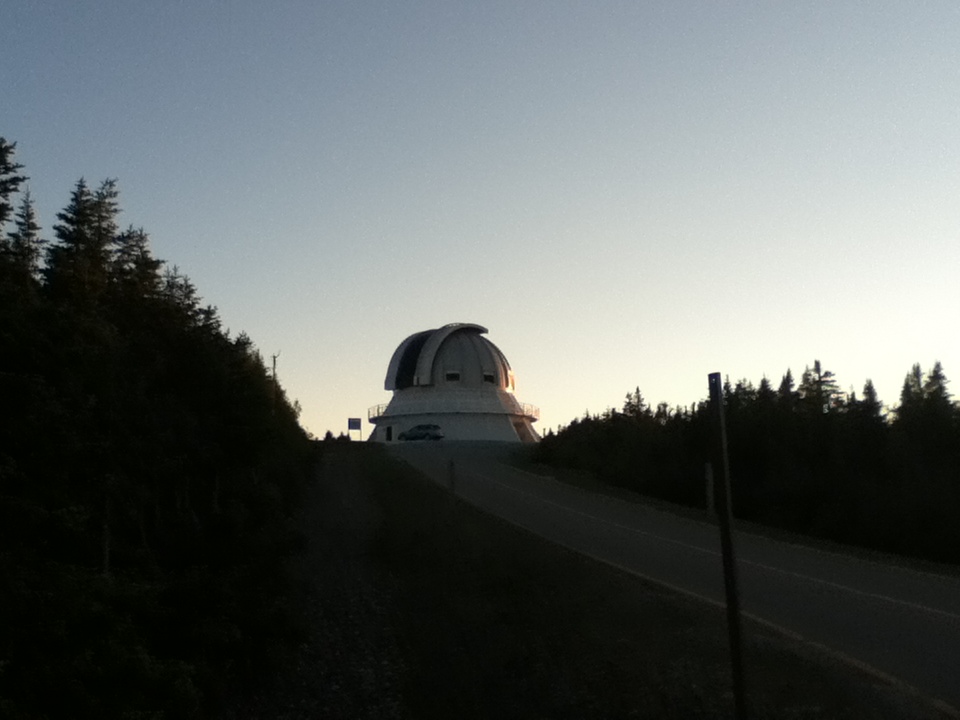

Berthold -
We're just happy it cleared off for tonight. We have more time from Sunday - the 28th of the month.
Here's an ipod picture of the telescope.
Dateikommentar: OMM telescope
IMG_5982.jpg [ 219.37 KiB | 5406 mal betrachtet ]
Dateikommentar: OMM, outside
IMG_5981.JPG [ 145.46 KiB | 5406 mal betrachtet ]

BeitragVerfasst: 12. Juli 2013, 10:04:22 AM
Hello Nicole, hello Noel,
many thanks for so fast reply and also thanks for the pictures, thus I can better fancy how are your working conditions.....:-) nice instrument, indeed! Interesting to hear, that you need only 2 minutes for these bright spectra....great!
cheers berthold
