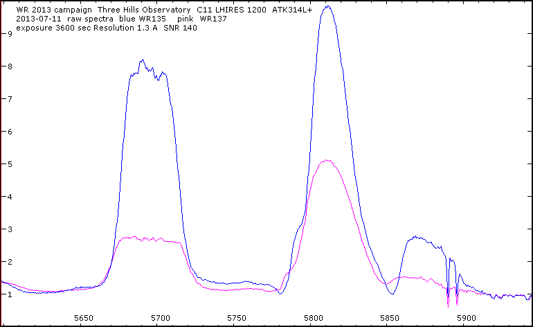

There is enough darkness here now to take two 1 hour spectra so here are my first campaign observations (raw neon calibrated spectra) from last night for WR 135, 137. The quality confirms the test results from last year (SNR 140 in an hour exposure at 1.3A resolution with a 280mm aperture C11, LHIRES with 1200 l/mm grating and ATIK 314L+ camera)

Very nice, Robin! Can you also get WR134?
Best, Tony

Potentially yes, though the logistics of wavelength changes and flats make it tricky to get more than one observation of each per night
