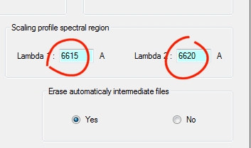

Hello all:
I have encountered some questions that I am not very clear about them. Hope to get your great advice & explanation.
<my ISIS is version 5.1.2>
1). Predefined mode. it has 1200L [6 lines], if this mode can ONLY be used to calibrate Ha zone?
2). For WR134, what should I fill in the "scaling profile spectral region " in the "Settings" Tab? I know that its fuction is to normalize the continuum by selecting a region where there is no spectra, no emission or absorption lines. Could you please explain deeply about it?
In addition, in "Profile" Tab there is a button "Normalize", too. what is the difference between them? How to use them correctly?
3). I know that I must redo new Instrument Response for Lhires3 after I change grating, slit,etc.. mechanical parts of it. I have read through the tutorial, but all exampls and contents are for Ha. And all data in the database and libraries in ISIS seem to be used for Ha. Then when we take spectra from other spectral ranges, i.e. 540nm, how to make the instrument response? What are the correct procedures?
Cheers,
Dong
PIC.jpg [ 34.43 KiB | 4334 mal betrachtet ]

for a region different from H-alpha you have to make your own dispersion equation with the Profile - Dispersion window. For that you have to enter the wavelength and pixel position of at least two (better a few more) known calibration lines (Ne Ar etc), which you have to identify first.
For details look here:
http://www.astrosurf.com/buil/isis/tuto ... ion_us.htm
For scaling you choose a region of the continuum where there are no absorption or emission lines. By normalizing the spectrum is multiplied by a factor so that the average in the normalizing region is equal to one. The difference in the scaling in the settings and the normalize button is that the value in the settings is used when a spectrum is reduced from a CCD image, the normalize button can be applied to any spectrum for rescaling later on.
For the response function you can use the spectra from the MILES database in ISIS, which are of lower resolution but should work or you can download spectra from the UVES database
http://www.eso.org/sci/observing/tools/ ... tonow.html
This however is quite difficult because the data cannot be read directly with ISIS, so I would stay with the MILES database for a start.
Load a file from the database and save it as e.g. HDxxxxref.fit for further use.
Hope this helps and clear skies,
Martin
