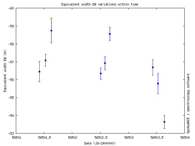

After a cloudy weekend it cleared on Monday :0) Results of last nights 4 spectra attached showing gradual filling in on blue side of the peak
WR134-130729.PNG [ 17.49 KiB | 11760 mal betrachtet ]
 Betreff des Beitrags: My attempt at WR134
BeitragVerfasst: 31. Juli 2013, 04:22:16 AM
Beiträge: 63
Wohnort: Montpellier
Hi all, John,some report from the Teide on 5411.
Short terms variations are observed too with a high confident. But no periodic behavior has been observed so far, only three nights. We can suspect such from Ew evolution but we need more observations.
Something to follow
Thierry

Hi Thierry,
The 2D intensity plot is going to be interesting to see when we get to combine all our data. Would we expect the EW to change periodically? I thought the total flux stayed pretty constant in these systems and the main effect is changes in the shape at ~constant EW due to velocity changes. Morel et al for example used changes in skewness and the centroid to measure CIR in this star using the HeII 4686 line
http://www.stsci.de/wr134/pdf/morel1999.pdf
Robin.

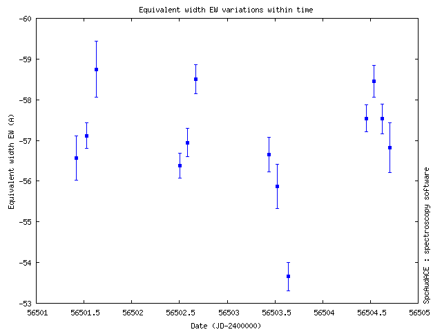

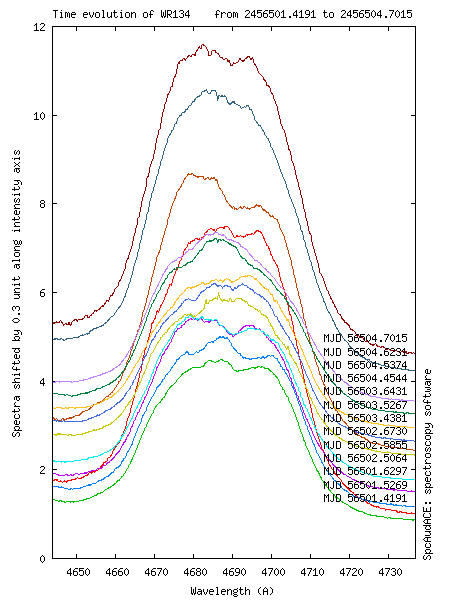

Hi,
last four WR134 spectra of the night showed a new increasing hump on the red part of the line. It should have disappeared this night.. Robin, thanks for the paper, but i'm still monitoring the line with Ew,  an easy to do approximation of the behavior of this now complex line, thanks John, my neihghbor (!), to have warn us.
 Observing sessions are quite long but exiting with such surprise., Yesterday we lost again 2H with a declination problem, now recurrent, and still no autoguiding. Our night assistant, Pedro, is very experienced, a good observer too with the 1.5m TCS in infrared photometry and has finally succeed to restart the telescope.
Attached is also the active 4686 line profile variation of our 4 nights here. I have reduced all night profiles of others WR stars, available if some wants to compared, but have no time to analyze it. We are about to send raw data to Montréal. Running with multilingual Audela for acqusition and real time reduction would have gave to the Teide teams here a good appreciation of their work and some exiting moments like the one we live. I have corrected some bad things in the data acquisition guidelines, specially Thar overexposition, led flat leading to memory effect and error in the continuum.
Thierry

Hi Thierry,
I don't think the current behaviour is particularly unusual. Here are a couple more examples of the variability in this line as reported in my test spectra from last year and one of yours from 2011
http://spektroskopieforum.vdsastro.de/f ... 65_579.png
http://spektroskopieforum.vdsastro.de/f ... 12_206.png

Beautiful observations, Thierry. There is a lot going on in the spectra: quasi-periodic CIRs and stochastic clumping, so the 2.3d periodicity may not be obvious. Only when we look at all the data over 4 months will we really know what?s going on. Just keep up the good work!
Thanks, Tony
Thierry

: Beautiful observations, Thierry! But don?t expect a strict periodicity. Despite a strict rotation period, we suspect that the bright spots that form on the hydrostatic surface of the star come and go on timescales of a few rotations, introducing a scatter in the phasings of the light curve variations, which can partly hide the underlying periodicity of 2.3d. This period was found previously through intense monitoring, but never for as long as we are doing in this campaign. Keep it up!
Thanks, Tony
