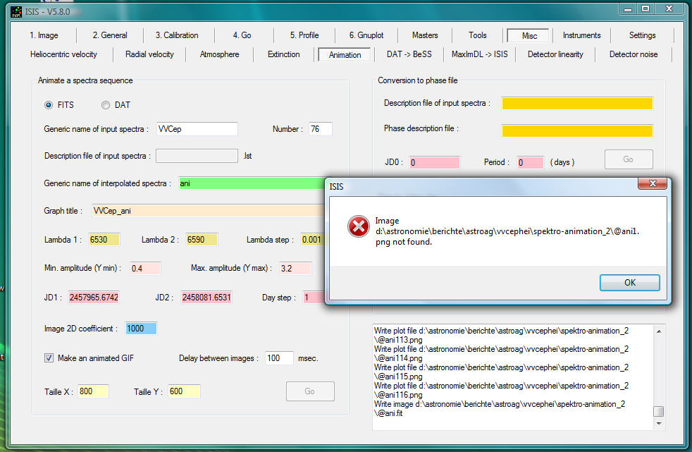

thank you for the hint. Now it works, but not till the end. The programm comes to a halt and gives out the error that it cannot find the file @ani1.png (see attached jpg). And indeed the file and the following png-files are not on the harddisk. I have no idea what might have happened to the files. Do you know the answer?

Hello Jörg,
It's difficult to answer your question "at distance", maybe check if you have the right start and end Jullian day ?
First, did you check to generate a simple spectrum graph with ISIS ?

Hello Olivier,
well, both programs work fine, but unfortunately not together. So I wrote my own script for gnuplot and use the @ani....dat files of ISIS. This has the advatange that I can create a layout of my own.

Hello Jörg,
I try to use the animation fonction in ISIS with some old data and it work find
What version of Gnuplot you use ? I think ISIS is very sensitive with the version of Gniplot (don't hesitate to use an old version).

Hello Olivier,
thank you for the example. I've tried it with gnuplot 4.00 and gnuplot 4.44 so far. Which version did you use?

Hello Jörg,
My Gnuplot version is 4.6 patch level 5

Hello Olivier,
the problem is solved. ISIS couldn't address gnuplot as long as gnuplot was in the program files directory. So I've changed the location. Now everything works fine. Thank you for your comments.
