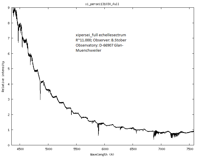

BeitragVerfasst: 02. November 2013, 19:42:38 PM
Hi,
there is a new spec of xi_persei from 131030. I am at time not able, to eliminate the waves along the continuum.
cheers
XI_persei_131030red131024.fit [258.75 KiB]
273-mal heruntergeladen
_xi_persei2_131030_full.png [ 11.79 KiB | 15972 mal betrachtet ]
_xi_persei2_131030_halpha3.png [ 17.38 KiB | 15972 mal betrachtet ]

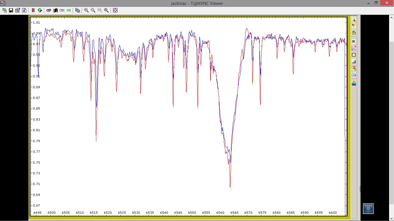

 Betreff des Beitrags: Menkib spectra
BeitragVerfasst: 05. November 2013, 00:47:48 AM
Registriert: 29. Juni 2011, 10:35:51 AM
Beiträge: 22
Wohnort: Hampton Wick UK / Villeveyrac France
Here are two spectra of Menkib from 19th Oct (red line ) and tonight 4th Nov (blue line). There appear to be clear differences at the edge of the wings of the Halpha line especially the red side. Anyone else see this?
John
menkibred19octblue4thnov.jpg [ 171.42 KiB | 15881 mal betrachtet ]
 Betreff des Beitrags: Re: Menkib spectra
BeitragVerfasst: 05. November 2013, 19:10:48 PM
John
Hello John,
excuse me, but I'm not able to see this changes. The red spectrum has stronger H2O-lines.
I think the spectra have to bee dried. The water lines disturb the judging of profile variations.
BeitragVerfasst: 05. November 2013, 20:19:32 PM
Hi,
Lothar says what I think also. The spectra in this region should be dried. Otherwise it is not possible to see any changes
Berthold.
BeitragVerfasst: 06. November 2013, 02:29:10 AM
Beiträge: 22
Ok Lothar and Berthold I have started removing the telluric lines from my spectra. Here are the first two I have done from 16th Oct (blue line) and 19th Oct (green line). Can you spot any differences?
If you have any spectra of the Halpha line for Menkib I would interested in seeing them
cheers
John
MenkibHAlphaDetailBlue16OctGreen19Oct.png [ 8.88 KiB | 15836 mal betrachtet ]

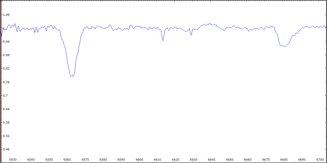

BeitragVerfasst: 09. November 2013, 14:23:06 PM
Beiträge: 639
Wohnort: Schulberg
Hi John,
there's my last profile for comparison.
R = 12600 in 6678
S/N = 180 in 6570-6610
cheers
Siegfried
xi_persei_20131107.png [ 12.54 KiB | 15692 mal betrachtet ]

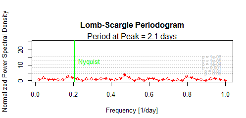

 Betreff des Beitrags: Periodic behaviour in Halpha line
BeitragVerfasst: 10. November 2013, 18:59:23 PM
Beiträge: 22
Even with data from a small number of spectra am picking up the periodic behaviour in the blue side of the Halpha line. See chart for lomb-scargle analysis of Equivalent Widths - giving a 2.1day peak, and a chart for EW versus phase assuming period 2.1 days
menkhibLomb-ScarglePeriodogram.png [ 9.04 KiB | 15653 mal betrachtet ]
menkib-200to-500kmperhourEquivalentWidthGraph.png [ 8.34 KiB | 15653 mal betrachtet ]
