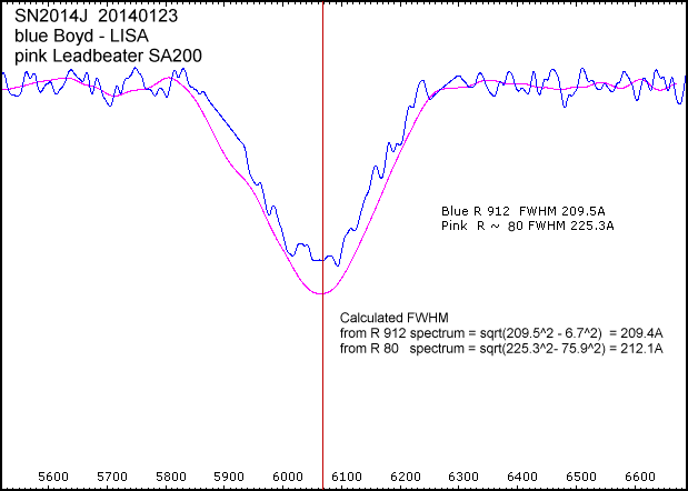

BeitragVerfasst: 20. Februar 2014, 22:39:03 PM
Hello Torsten,
If you are just interested in the effect of the instrument on line width then you could perhaps try a geometric sum as an approximation.
For example if the measured line FWHM in the spectrum is 60A and the instrument resolution (measured on narrow lines) is 30A
then the actual line width would be approximated by sqrt ( 60^2-30^2) = 52A.
It could be interesting to compare this approximation using spectra
taken at higher resolution here
http://www.astrosurf.com/aras/Aras_Data ... 4J_M82.htm
BeitragVerfasst: 20. Februar 2014, 23:29:14 PM
I tried it with my spectrum at R ~80 using an SA200 and David Boyd's taken the same night at R ~900 using a LISA.
The FWHM estimate seems to have worked quite well (see attached) but a narrower line would be a better test.
instrument_resolution_correction_.png [ 15.09 KiB | 4634 mal betrachtet ]
