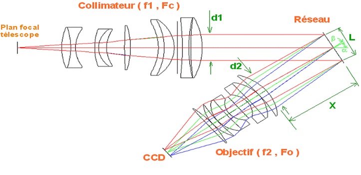

Hi everyone,
I hope I can ask for some guidance regarding building a custom spetrograph for my telescope; a 36"f4.5?
I had found Buil's website with an article titled "Design a classical spectrograph", http://www.astrosurf.com/buil/us/spe2/hresol.htm. This design has many attributes I'd like to take advantage of;
1. R=3000
2. no entrance slit will be used, thus avoiding the difficult problem of positioning the star's image in the middle of a slit a few microns in width.
3. (F/D=4)
As for item #1, if R=3000 is not achievable, the goal, as stated to me, is the resolution to be near 0.5A/pixel. For item #2, no entrance slit is almost a requirement as I'll have alt-az tracking with field rotation. For item #3 my scope is F/D=4.5.
However, this document had an upgrade, http://www.astrosurf.com/buil/us/stage/ ... ign_us.htm, named "Design a spectrograph", in which now a slit is employed. But I'd still prefer not to have a slit....
Could you comment on the slit-less design with regard to my scope so the system resolution is near 0.5A/pixel to useful in the Pro-Am Campaign for Summer 2013, Wolf-Rayet stars WR 134 and WR 135 in Cygnus?
Using SIMSPEC V2.2 and adding my details, the R value appears to be ~1250 using an SBIG ST-8300M with its 3326 x 2504 pixels at 5.4 x 5.4 microns square. The lens details appear to be: f1=120mmf4 collimator and s' - distance between the collimator and the grating - is 158.7mm derived from using the original "Design a classical spectrograph" document. When using a 1200 Groove, 500nm Ruled Diffraction Grating, which is 30mm square, the effective diameter for the beam, d1, is 26.22mm and the 120mmf4 collimator lens seems to allow this.
In the second document, "Design a spectrograph", the collimator camera lens has been replaced with a simple achromat. Is this an acceptable replacement? Some cost savings would be nice.
Any other comments are most welcome and I hope to hear back regarding the questions....

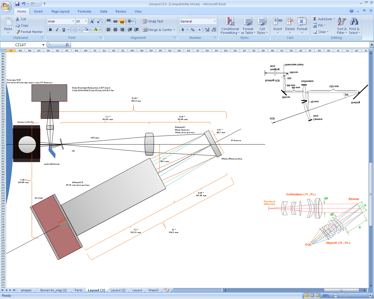

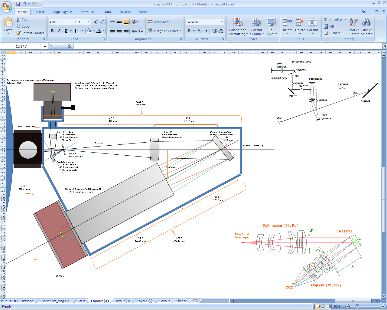

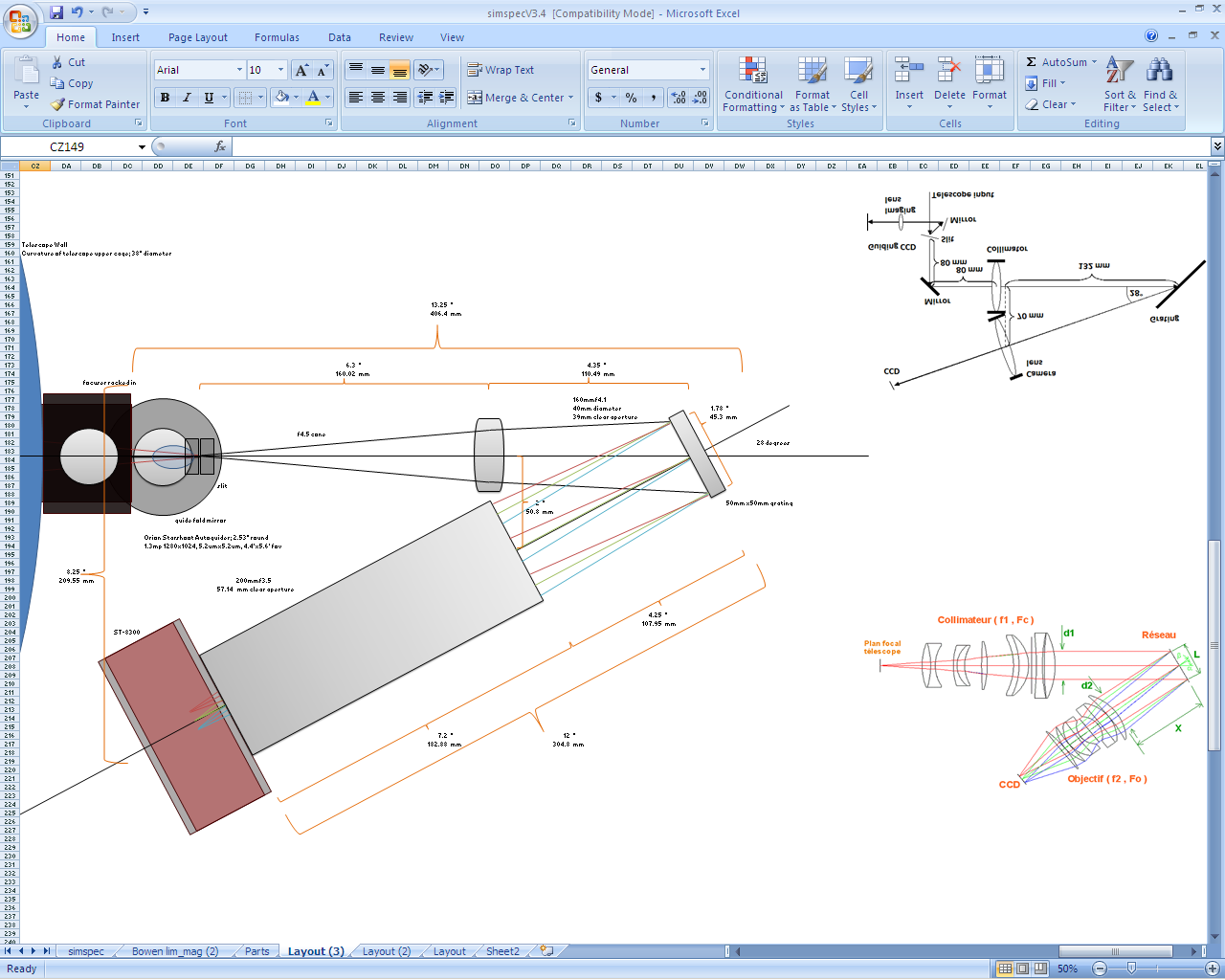

Thanks Robin and Thomas,
I had played with SimSpec before posting the first time but I'm glad there is an english version.... My German is really bad, my French is worse.
I had started to customize my copy by including an optical layout diagram to help me better understand. I could also then put real values there since optics rarely come in the calaculated values.
The V2.2 copy attached is titled: simspec_slit_e for 36 inch.
Please look it over and comment? There's bound to be errors that you may find them long before I would.... The third and fourth tabs contain the optical layout relative to the scope, with and without a slit. My preference for slitless is due to the potential of using the Zero Order for finding/positioning with the use of a degree-scribed optical base I have.
The V3.3 copy attached is titled: simspecV3.3 for 36 inch.
I transferred all the pertinent information to it to see the differences, if any, compared to V2.2 with regard to SNR, Resolving power, Dispersion. Is my understanding correct, when using a cylinder slit, in needing yet another camera for finding/positioning? The slit function does improve R. What value could change to improve R to the point of usability for the Pro-Am Campaign for Summer 2013, Wolf-Rayet stars WR 134 an,d WR 135 in Cygnus, without resorting to a slit?
I understand Robin's list of drawbacks and why they would occur in a slitless version.
*To include a reflective cylinder requires some other method then, of finding the right star and positioning it correctly. Some comments on how would help. The scope should have good pointing to within a few arc-minutes of center, more or less, during the GoTo, then there is a need for fine positioning
*Tracking would have field rotation and then only keep that star on the cylinder it it happen to be the one chosen for tracking purposes. The ST-i is envisioned as the tracker using the 100mm FL f/2.8 lens that can come with it for a stand-alone system. The 35.7mm diameter optics may not always reach my spectroscopic target star's magnitude.
So how far off am I in this spectroscopic endevor, the spectrograph design I've shown, and systems integration in the method of finding/positioning/tracking?
Thanks, Steven

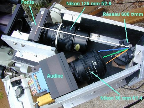

Hi Steven,
Not a reflective cylinder virtual slit (very inefficient) but a slit in a mirror. See here for an example of a spectrograph using a mirror slit system.
http://astrosurf.com/thizy/lhires3/index-en.html
(The LHIRES III littrow spectrograph designed by Christian Buil). The slit is conventional but with reflective jaws (or in the latest design in a mirror) so you can guide on the surrounding field or on the overspill on the slit. The slit be built into the spectrograph or as a hole for a fibre optic guide head. Similar systems are used on all the Shelyak spectrographs (Shelyak will sell the reflectve slit on its own to self builders) and in the Baader DADOS and SBig SGS. It works very well as the guide camera sees exactly what the spectrograph sees without the flexure or alignment issues of a separate guidescope for example.

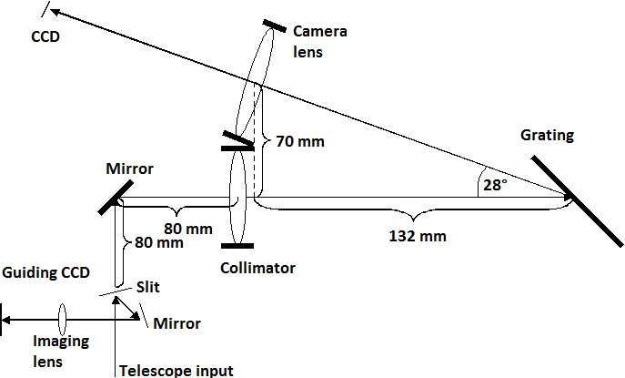

BeitragVerfasst: 23. Dezember 2011, 14:45:51 PM
Hi Steven, I took a quick look on the sheets. They both give more or less the same output. Only minor negligible differences occur.
You have two basic choices:
1. Without slit: Then you could use a collimator of 300mm focal length and a camera of 200mm. An f/4.5 300mm collimator is big and, hence, expensive. And you need a 83mm grating - expensive. The camera would be bigger, as well. So, for about 1 Angstrom 2 pixel resolution you would spend some (a lot of?) money.
2. With slit: You could use a 180mm collimator and could then use a standard photo lens size and a 50mm grating. The collimator and camera could also both have 200mm (Littrow configuration) and you would still lose little light at the grating. With a slit of 20-25 microns you would match the 1 Angstrom resolution requirements for the campaign.
2x2 Binning is essential for both choices. And the calculation is for 2" seeing, which means a 40 micron disk. You told me that you can count on 1" at you site. So, if you have 1" then you almost get full light throughput. Your site is fantastic! Please check that out in detail, especially the loss potential of light and check if I made a mistake (Robin and others?).
Cheers and all the best for Christmas to all, Thomas

Thanks again Robin and Thomas!
The links to a Shelyak reflective slit, and views through the guider, are most helpful to know what I can expect in my eventual system. The Orion Starshooter with its 1280x1024, with 5.2um pixels, would give me a 4.5'x5.6' fov, more than enough to find, position, and then track (though I don't know if tracking is possible with it on the halo remnant of the target star surrounding the slit).
The option of the slit really is a requirement.... The additional autoguider and slit increase the costs but the R-value is much better. The lens selection increased as well, with reduced lens costs by going to 180mmf4.5.
I had originally discounted the 180mmf4.5 collimator camera lenses because they violated the f1 rule causing a larger exit pupil than the 50mm grating could accomodate, but after plugging in that value, using a 20um slit value in V3.3, I noticed the R value increased by 38% by exceeding the grating by only 0.1mm. Not a bad trade off.... In essence, I think this would only affect the outer edges of the spectrum swath as seen by the ST8300. The pivotable grating means any portion of the spectrum is viewable, just not at that time. With the 20um slit, the R is ~6554 at 6563A with an angle of 26.3975 and an R of ~5252 at 5500A at an angle of 24.6359. I see the Neon lamp is used for the Ha line calibration, but for the 5500 range is a sodium source better for dialing in the range containing the HeII 5411A line in WR134 and the CIII 5696A line in WR135 by using the D lines?

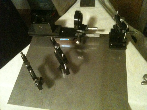

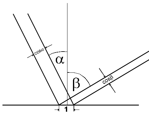

Thanks Ken. I found one SNR formula in Buil's pages but it's not as complex as what's in the .xls spreadsheet. I'll just leave that alone for now.... I did change the atmosheric transmission value from 0.8 to a scaled value. Looking online at some graphs it's only 0.8 at ~1um, but closer to 0.66 at 6563A and lower at shorter wavelengths. I did notice that the spreadsheet starts to give negative collimator values as you get more blue. I will be able to rotate the grating to view the blue end and it's only an artifact of the spreadsheet, yes?
Regarding grating mechanical mounting, I have a micrometer rotational stage. I'd like to attach the thick grating to it, much like Buil did with an optic clamp, but can it be put on its edge and still stay perpendicular to the incoming beam or does that require a tip/tilt behind the grating on top of the stage? Like what's seen on 'Grating Holder' jpg.
Looking at the angle Alpha when plugging in different reference wavelengths, the angle decreases when decreasing the wavelength. However, the two diagrams are different on Buil's site. The picture Dispersion1 is correct, yes, (and not Dispersion2)? I ask because my micrometer stage increases its value as it rotates clockwise (apparently decreasing Alpha) when looking down on it but I'd prefer the value to increase as I dial in a longer wavelength segment. It seems I would only need to mount it and the optics on the 'roof-plate' that isn't shown on Buil's pic where he's attached them to the 'floor-plate'. On my scope it'd all be on the left plate closer to the primary not on the right plate.
Would anyone have a good picture of the Shelyak Instruments 4-Position Slit (15/19/23/35µm) support? This device is at a 45 degree angle to reflect all but the slit to the guider and slit passes through to the collimator? Does it then move along the plane of the 45 for each slit width to be in place as needed? With a good picture I could ask far better questions. With ~1.5" of back-focus available and the need for a 1.25" focucser for the guider, the possible need for a micrometer linear bearing to move the slit along the 45-plane, I've got to make it all fit....
I also have a couple of matched optics holders that may work well for the collimator, plus I have that rotational stage, but the plan for the 200mmf3.5 camera lens is a couple of custom lens holder rings so the bayonnett mount protrudes out of the enclosure to be able to attach the ST-8300. This way I can detach the main camera and do other things with it. Besides the obvious caviat that the lens can't move during the twisting action, is there something I'm missing that I should be aware of? As long as it's set to infinity and locked in place at the prescribed distance of 255.42mm from front lens to the grating, I'm good, yes?
Hopefully the descriptions are understandable. If I've understood and the descriptions are correct I'll make fewer mistakes resulting in many unused holes....
Thanks,
Steven

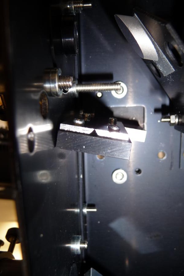

Hello Steven,
The slit has a angle of about 10 to 15° compared with the focus plane of the telescope, not more ! When the angle is too big then one of the edges of the slit ist not more in the foci of the collimator, telescope and guiding camera. Then you see the star on the slit unsharply.
You can see in the picture the slit in the first version of Lhires III. The slit has to be oriented perpendicular to the gradient of its inclination.
You use 2 foto lenses. I think, that makes the spectrograph havy. Better it would be to install an achromat for collimator.
Hello Steven,
You use 2 foto lenses. I think, that makes the spectrograph heavy. Better it would be to install an achromat for collimator.
Thanks Lothar, that is most helpful!

I started to change V3.3's static values in some of the boxes to formulas I found in Buil's site, even adding a box in the telescope system section for the distance between the secondary and the focal point which affects:. "Distance from Camera lens to grating(T) :", which in V3.3 was a 30mm static number but according to Buil it's this formula s'=(f1*s)/(s-f1), where he states "s is the distance between the telescope secondary and the collimator, if f1 is the focal length of the collimator lens, then the distance s' between the collimator and the grating must be approximately" so I changed it. With 609mm as 's' and the value spit out for 'f1' I'm looking at ~255mm..., where T=s’ (and the optical diagram shows this as ‘X’ because they didn’t always use the same names between Word and Excel (and pictures). So, too, for the camera values (Camera lens-FWHMc) and others, those are static too. I think there’s a need for V3.4…, no static values except for like I did surrounding the optical diagram with real-world values because a lens might not come in a 172.935mm but I have to choose between a 120mm or 180mm in a f4.5 cone.
So, I made a V3.4 and attached it. It has some conditional formatting in the “Applied Results” where one has to enter the real-world collimator lens value, specifically with regard to the grating size, because of how the collimator lens affects the grating size required (you’ll see it red because 50.1mm grating is required whereas I don’t want to buy anything larger than 50mm so it’s highlighted in red as a point of reference to accept or correct. I think that overflow of light past the grating creates a slight loss of primary mirror but the R value increases by having that lens type. The other formatting added, is the minimum required camera lens diameter. The 200mmf3.5 works whereas a 120mmf1.8 does not. User Inputs are also clearly marked as well as a different color coding for the provided input data and calculated outputs. One should only have to put proper values in the yellow boxes.
Could another pair of eyes look it over? My goal was to not miss some important input that needs to be relative to the input scope design. There is still an outstanding question of the grating angle and its affect on making the grating size negative when calculated for 4500A, and the collimator lens value goes to -180mm too but stays positive for 5500A and 6563A.
Wavelength: Grating Angle, Grating Size, R Value, Collimator FL
6563A: 26.3975d, 50.15mm, 7027, 180mm
5500A: 24.6359d, 47.2mm, 5754, 180mm
4500A: 23.2591d, -45.15mm, 4615, -180mm
I adjusted the grating angle to maximize the 180mmf4.5 collimator and therefore R-factor. Is there a way to know that I’m actually at the max R-factor grating angle (like 6563A is centered in the ccd?)?
Thanks, Steven

Hi Steven!
The total angle is alpha-beta (beta being negative) = 38 degrees - this is still OK.
Ken is basically right. Just to clear up the details for you:
The total angle is always . The reason for the difference is the definition of the coordinate system. In fact we have .
The direction angle depends on the angle of incidence and the diraction angle changes by (see image attached)
If we change by , then changes by . The alteration is proportional to . The proportional factor is called the anamorphous factor A. Even would work but on the costs of lower resolution. To keep the anamorphous factor possibly independend from the grating position, should be kept small.
The distance from the grating to the imaging lens is constrained by the physical dimensions of the lenses...
This is a matter for the spectrograph designer. In practical sense I would say it vice versa. The physical dimension of the camera lens is constrained by the distance from the grating to camera.
From my point of view these consideration differences are important especially for beginners. It is easy to mix design problems up and an accurate description helps avoiding those problems.
BTW Ken, you ended up in the wrong thread.
Cheers, Thomas

Hi Steven,
a drawing of the system is attached.

Thanks guys,
So my components will be laid out on a 28 degree angle like Daniel's attachment or 28.5d like Build showed? But neither optic should block the others' light, and that's what might affect the imaging lens chosen and therefore affect the R-factor if the 200mmf3.5 can't be used. I've ordered that lens since it wasn't pricey to see what can be done. Is there anything else in the parts I described that is concerning?
One thing I've considered is placing the slit, guiding optics and collimator on a motorized micrometer linear bearing (since the collimator to grating distance is apparently not too critical) in order to have the spectrograph focus independent of the telescopes' focuser. This would alleviate having all that weight hanging on the focuser alone at various elevations/angles. To prevent flexure I'll have three mounting attachment points connecting the spectrograph to the telescope; the upper and lower cage rings and a third on the lower 2" OD aluminum cage tube (plus the focuser for four). The focuser would be racked in all the way and only provide the initial alignment point for loading the device on the scope, then the other points are attached and secured.
Steven

Hi Guys,
Here's a first attempt at an optical diagram with proportionately sized parts, dimensions, and an angle..., relative to the 36" scope. It's done in Excel because I've drawn so many things using the shapes.... The shape of the 200mmf3.5 is approximate, slightly larger than the clear aperture value. I think I've identified all components.... I used Daniel's and Buil's picture for reference.
Steven
Spectrograph Optical Layout.PNG [ 194.58 KiB | 43060 mal betrachtet ]
Apache-Sitgreaves Center for Astrophysics
http://darkskyobserving.com
 Betreff des Beitrags: Re: Custom Spectrogaph
BeitragVerfasst: 03. Januar 2012, 19:40:51 PM
Hi Steven
The collimator to grating distance isn´t critical, you could make it as big as you want.
The distance betweet collimator and slit is very critcal, because the resolution will be affected.
Do you know how to adjust a collimating system (collimator and slit)?
 Betreff des Beitrags: Custom Spectrogaph

Hi Daniel, maybe not.... Other than that I placed the collimator at the distance from the slit to fill its aperture (~39mm clear aperture according to the manufacturer) with angled light of an f4.5 cone that passed through the slit at the scopes' FP. This distance is ~215mm to fill the 39mm optic whereas the collimator's FL is 160mm, but maybe it should be set at 160mm distance. Maybe the use of an f4.1 v. a matching f4.5 collimator then spreads the light to ~45.3mm at the grating, according to Simspec, instead of the 39mm if the light were parallel from having used an actual f4.5 collimator that matches the scopes f4.5?
160mm not 215mm?
Steven
Spectrograph Optical Layout a.PNG [ 194.77 KiB | 43046 mal betrachtet ]

BeitragVerfasst: 03. Januar 2012, 22:08:51 PM
Beiträge: 265
Wohnort: Maienfeld, Schweiz
Hi Steven,
just two points. As Daniel already mentioned, the distance between slit and collimator is critical. The slit has to be at the back focal plane of the collimatot, so that light exiting from the collimator is exactly parallel. Otherwise you will have astigmatism at the focus of the camera and loose resolution. I would provide some means for focusing the collimator to compensate for temperature changes and chromatic aberration of the lens.
The slit has to run parallel to the grooves of the grating, perpendicular to the drawing plane. The guide image will therefore be projected out in the drawing plane.
The design has a nice feature. The small angle beta means that dispersion, which varies with cosine beta is almost constant over the whole wavelength range, which simplifies analysis of the spectra.
Regards, Martin

If the collimating lens is 160mm focal length....then this is the distance between the slit and the lens not the 200mm+ you show....
Thanks Ken, at this point I've misplaced or misorientated every part at least once....
In this drawing the slit is rotated on the axis of the slit opening to 15 degrees. Is this one correct? I hope so, there is no interference with the guide camera and a focuser knob.
I've added the relay lens for guiding....
Steven
Spectrograph Optical Layout b.PNG [ 195.28 KiB | 43053 mal betrachtet ]
Zuletzt geändert von Steven Aggas am 04. Januar 2012, 00:07:05 AM, insgesamt 1-mal geändert.
BeitragVerfasst: 03. Januar 2012, 23:42:22 PM
Beiträge: 265
Hi Steven,
now the slit and guide camera look ok in the last drawing. That the collimator is a bit faster than the telescope does not matter, much better than the other way round. A spectrograph is always a compromise betweeen resolution and efficiency, with your design you seem to be on a good track. Just make sure that you focus the collimator correctly. If you want to use a different grating some day (with larger dispersion) you may be happy to have chosen a slightly smaller beam hitting the more inclined grating and not losing light (I did not check your angles). If you are a perfectionist you could still extend the collimator focal length with a weak Barlow lens to get a match between telescope and collimator f-ratio, but I think your choice so far is very good.
Regards, Martin
BeitragVerfasst: 04. Januar 2012, 02:42:06 AM
Hi Steven
To reduce bending and to improve mechanical stability, it would be better to use a 90°-mirror after the slit (see my drawing).
The light after the collimator musst be parallel. To adjust the collimator: Use a smal telescope (finder scope) and focus it on a star. Then look from the direction of the grating in direction to the slit through the collimator an chance the distance slit - collimator till the image of the slit in the finder scope is perfectly focused. This distance musst be fixed for all times...

Hi Daniel, I'm not sure I can fold it, given that I would want the device to focus independent of the telescopes focuser. The telescope focuser would not be used except for insertion of the 2" nose piece of the spectrograph. The orientation of the spectrograph would then allow for a left, right, and bottom support beam from the spectrograph to both upper and lower cage rings and one of the 2" OD cage tubes. This way nothing is hanging on the focuser and the three brackets go with the spectrograph when not in use.
Thanks for the tip on adjusting the collimator! It was mentioned that the collimator should be adjustable for temperature compensation and the chromatic aberation of the lens. How critical are these to compensate for? Must it be adjusted to properly use the device on the red v. green portion of the spectra?
On a different note, one of the slit holders, the LHIRES III, is designed to hold the slit at 10 degree angle while the other, LISA, is at 15 degrees. The LISA has two 19um slits on either side of the 19um hole and the LHIRES has a 19um slit, so, 10 or 15 degrees does not seem to be ultra-critical. What is the maximum angle that a 19um slit can be placed at; 20, 25, even 30 degrees, or more, before bad effects are noticed?
The reason I ask is that I have limited space to place the mirror that would divert the slit-reflected light towards the relay lens and on to the guiding camera. My drawings are currently using the LHIRES slit with its 15 and 19um options at a 15 degree angle but a 20, 25 or 30 degree angle would surely help things out.
Thanks for any input you have.

BeitragVerfasst: 04. Januar 2012, 19:10:05 PM
Hi Steven
Aluminium has a thermal expansion coefficient of a = 2.38*10^-5/K at 20 °C, by a collimator focal length of 180 mm and a temperature difference of 40 K you will get a difference of:
2.38*10^-5 * 40 * 180 mm = 0.169 mm
This is in the range of the chromatic shift of a achromatic lens and it could be possible that the collimator has to be readjusted every summer/winter.
To adjust the collimator it is enough to have a elongated hole in the collimator holder for linear adjustment.
The inclination of the slit should not be greater than 15°. I always try to get 12 °, and this is almost possible.
Opto-Mechanical Parts.PNG [ 477.49 KiB | 42919 mal betrachtet ]

As for the complexity and difficulty, I'm only adding servo's to the mix of complexity. Do not others have to design their spectrograph like this too, with this much complexity? Is this one more complex than others?
... What thickness would you recommend for the base flooring to which all components/clamps will be attached?
Hi Steven,
you have very fine adjustment tools...but they are heavy and oversophisticated. As Daniel said a more simpler adjustment is better to save weight: Adjusting and then fixing the collimator by screws or such simple things. But mechanically stable.
As base plate you can use a Aluminium plate (5 mm) oder high density plywood (marine, 10 mm). Very fine are low density plastic plates with low thermal expansion coefficient:
http://www.obo-werke.de/index.php?optio ... &Itemid=67
They are also very easy to work.
