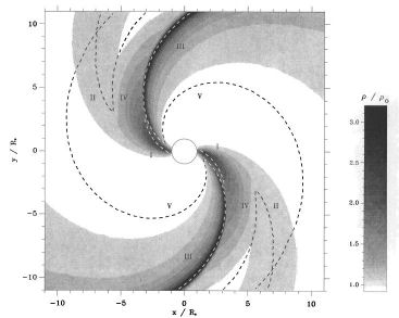

cir.jpg [ 17.54 KiB | 14319 mal betrachtet ]

The goal
As some of you remember, our last WR campaign at Tenerife had been
highly successful. Within our data Emily Aldoretta not only could
monitor Corotating Interaction Regions (CIR) in the wind but also
discovered that CIRs come and go with a period of about 40 days (about
18 cycles of the 2.1 day stellar rotational period). The respective
poster can be downloaded at http://www.astro.umontreal.ca/~emily/CA ...
er2015.pdf. sThese rotating shock-fronts (see picture) are the only
straigth-forward prope for the stellar surface being hidden behind an
optically thick stellar wind. From Emily‘s results new questions
arise. For instance:
• What is the reason for this interesting long-term behavior? Can it
be hot and bright surface spots, resonances in non-radial pulsations or
strong but local magnetic fields?
• Do other WR stars show this behaviour?
Please note that these questions can only be addressed with such a long
run. For detecting periodic variability of the order of 40 days one can
not observe the star for only three weeks. Therefore, such physics are
a real domain of amateur spectroscopy at a very good site with
excellent long-term weather conditions.
