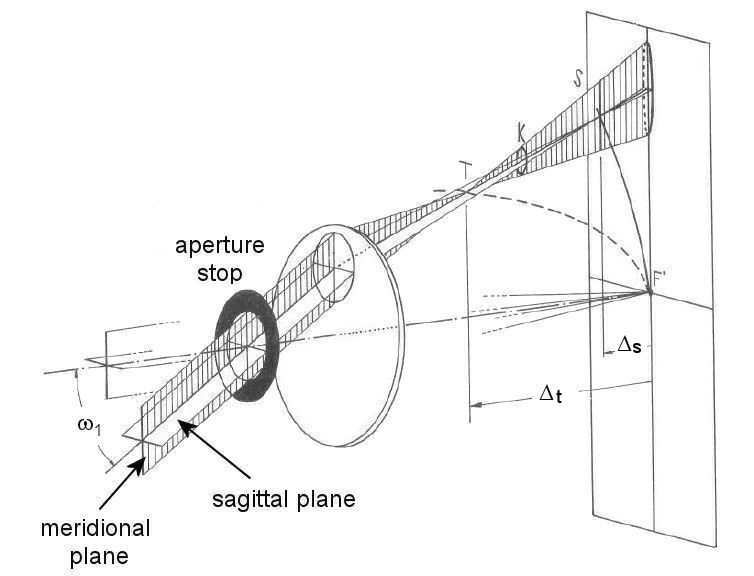

As you know, Robin, astigmatism can always be corrected by chosing the correct focal position. In our book we describe it in very detail and on page 98 you can find the attached figure for better understanding. For vertical dispersion direction in this image the focal point 'T' should be chosen. Then the focal image is only distorted perpendicular to the dispersion direction. I do not know what the manufacturer exactly acnowledges but if they use a good Rowland grating there should be no astigmatism at the correct focal position.
Cheers, Thomas
astigmatism.JPG [ 46.24 KiB | 13892 mal betrachtet ]
BeitragVerfasst: 25. August 2015, 15:26:25 PM
This makes the spectrum of a star very wide, covering many rows. You can see this the star spectra in the video 1:49-2:04
Yes, one can even see the field curvature. The strip has different widths for different wavelengths. That is one of the prices you pay for the compact lightweight design of a curved grating spaectrograph. :)
