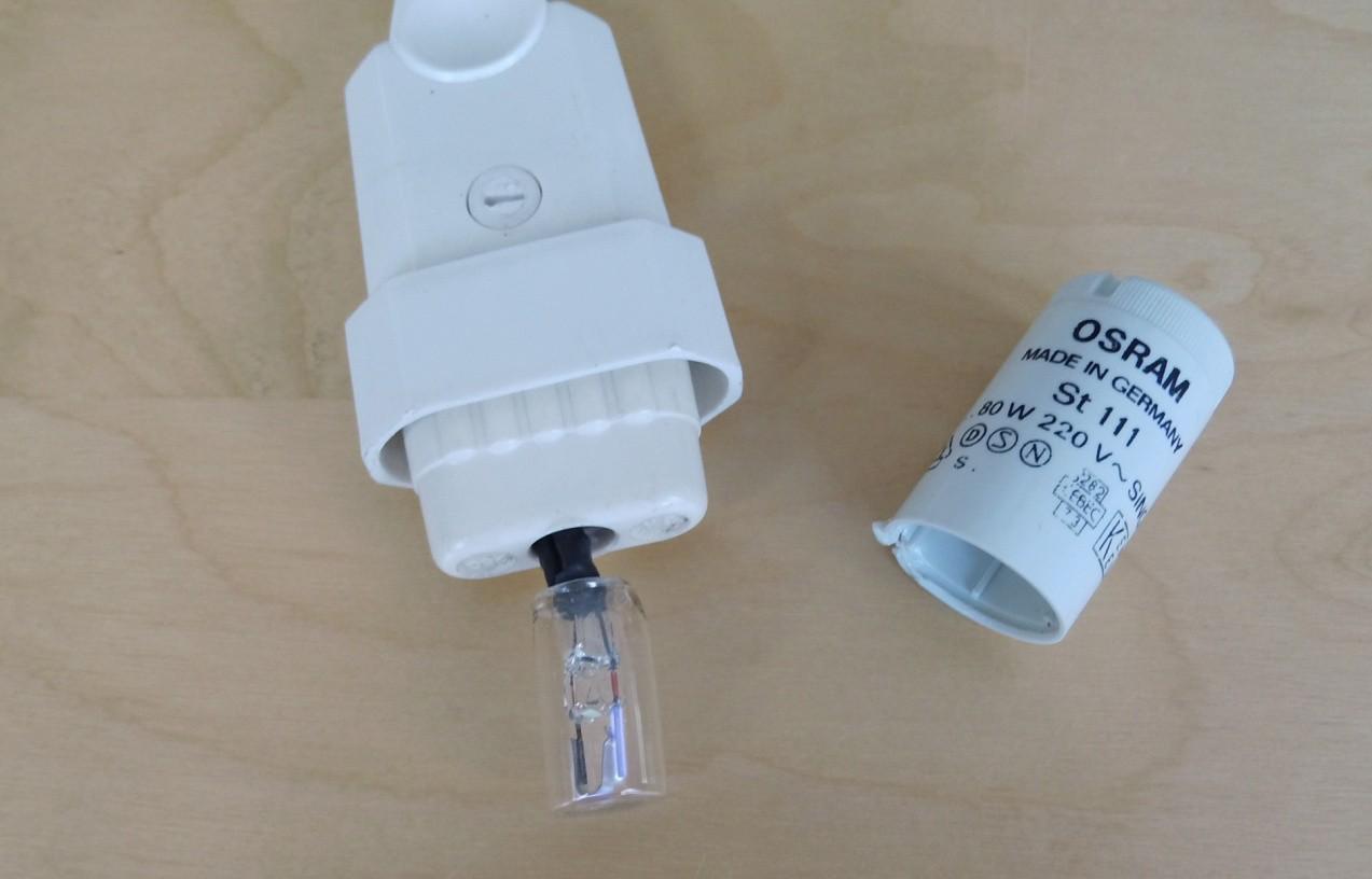

St1111.jpg [ 55.18 KiB | 3173 mal betrachtet ]

I have a question about your Osrtam ST 111 starter lamp cabling. In the photo, it seems that you run the start lamp with 220V.
What series resistor do you use?
By the way, I have measured the voltage in the LISA calibration unit for the ArNe-lamp - it's 365V.
I have expected about 90V, so I am not sure if Shelyak uses "standard starter lamp". My first plan was to swap the lamps and to use the Osram ST 111 lamp instead.

Hello Michael,
I use the unsafe method of 2 x 47 K ohm resistors in parallel on one of the phase wires of 220 Volt.
Can you tell me what is printed on the housing of your Osram starter? As you can see on the photograph, mine has just St 111 , without any suffix. Does yours have an HT suffix as described in the Osram manual (page 11) you provided?

Hello Hugo,
the print says Osram ST 111 Longlife ..
https://www.leuchtmittelmarkt.com/image ... 0487_b.jpg
You can also use the Osram ST 171 start lamp, whoch owns the same lamp, but with a security circuit that can be removed for our purposes..
http://img.elektro-wandelt.de/out/pictu ... 0b20_1.jpg
And thank you for the resistor information. I will use it to estimate the series resistor necessary in the LISA calibration unit, where the built-in inverter provides 365V. I also asked Shelyak what they think about this replacement idea.
