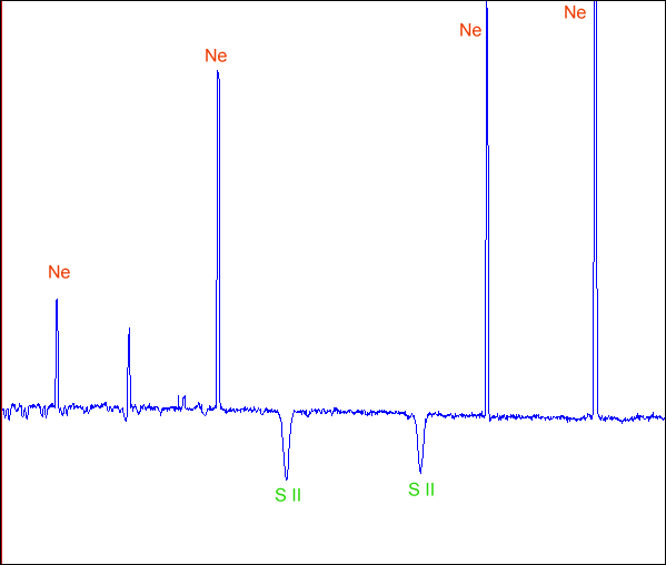

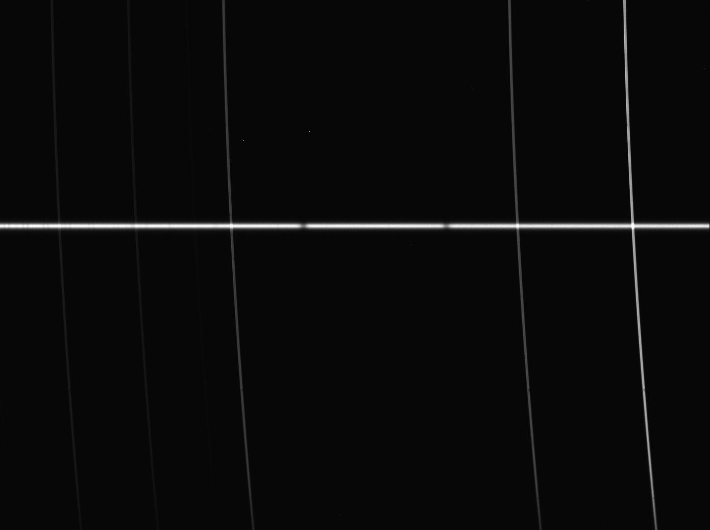

I have just started monitoring the RV of Deneb using the S II lines. To get the required (+-1km/s?) precision using the LHIRES III I am superimposing calibration lamp lines using a lamp mounted at the edge of the telescope aperture and run during the exposures (see attached example) If these are suitable for you I can upload them.
Dateikommentar: Deneb SII lines with Ne lines superimposed
deneb_001.jpg [ 29.99 KiB | 30969 mal betrachtet ]
BeitragVerfasst: 12. Juni 2014, 08:55:53 AM
Hi Robin,
nice, indeed! My english is not so good, to express what ein I want to say respectivly to ask, but I'll try this nevertheless:
I look your image on my IPad ! There I see the spectrum and the calibrationlines. These calibrationlines are not verticaly..I can move the spectrum along these lines and so I cannot get I high precision calibration!?
Ok , ISIS or IRIS they all can (and have to) compensite (?) those tilt angles! Probably this could be the solution of this question!
cheers

BeitragVerfasst: 12. Juni 2014, 11:39:43 AM
Hello Berthold,
The lamp lines are tilted/curved because of the spectrograph geometry. The star spectrum will also move in the X direction the same way if the spectrum is moved up or down. This means that where the lamp lines cross the star spectrum, the wavelengths will always be the same even if the star spectrum is moved up or down.
You reduce them in exactly the same way with geometric corrections etc but you produce 2 spectra, one as normal with the background subtracted (which removes the lamp lines) and one without background subtraction which is used for calibration. (Actually in this case because we are only interested in the wavelength of the star absorption lines and the lamp lines do not interfere with them, we can just reduce the spectrum without background subtraction, calibrate it directly using the lamp emission lines and then measure the wavelength of the S II lines on the same profile. See attached example spectrum profile.)

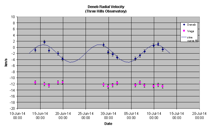

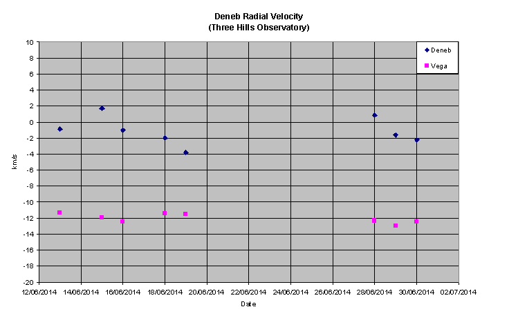

Attached are initial RV data for Deneb measured at THO. The RV variations in the SiII lines are clear. (4.5km/s range, mean -1km/s to date. The week gap is due to a holiday).
An RV precision better than 1km/s has been achieved using the LHIRES III and simultaneous recording of a calibration lamp mounted at the telescope aperture. The precision is estimated from measurements of Vega as an RV standard.
Does anyone have a reliable absolute RV figure for Vega? The figure of -20.6 km/s given in Simbad does not appear to be correct. My mean is -12.1 km/s, compared with -12.9 km/s measured by me on a spectrum taken from the ELODIE archive and -13.9 +-0.9 km/s from this reference
http://adsabs.harvard.edu/abs/1967IAUS...30...57E

BeitragVerfasst: 13. Juli 2014, 15:53:51 PM
Latest Deneb RV data attached. The quasi-periodic pulsations are clear (currently ~ 12.5 days period ~6 km/s pp).
RV Precision is ~0.5km/s sigma based on measurements of Vega but there is probably a small +1-2 km/s systematic error based on an initial comparison of lamp and solar spectra (to be confirmed).
Deneb_RV_20140713_THO.png [ 6.63 KiB | 30335 mal betrachtet ]

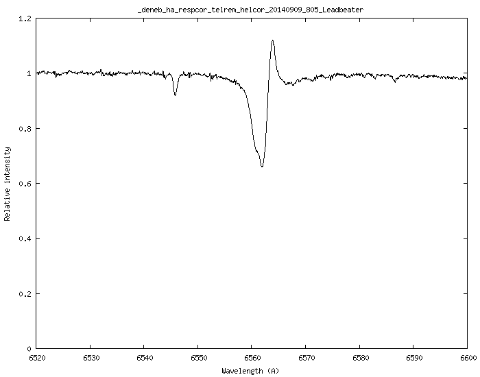

BeitragVerfasst: 29. August 2014, 16:02:09 PM
Now 80 days into the observing run on Deneb here at THO. Mean cadence has been just under 2 days (mainly weather related). I am now monitoring H alpha as well as the Si lines for RV.
The run of periodic RV variations has ceased and the trend now appears chaotic. Variations in the H alpha line are subtle but easily detectable day to day (mainly in the blue absorption edge so far)
Repeatedly changing wavelengths on the LHIRES III between Ha and Si has not increased the RV scatter but a ~1.5km/s shift was seen after remounting the calibration lamp (easily detected in the Vega reference checks so can be compensated for)
If measuring the RV from the Si lines, note there are some weak tellurics in this area which should probably be removed for best precision (to be done on a second pass calibration of the THO data). The longer wavelength line of the pair of Si lines also slightly overlaps a weak line on the blue side (at my R ~17000 resolution at least) which probably should be deblended properly before measurement (I have not attempted this yet). I have not identified the line but interestingly it does not appear in the Vega spectrum
edited 31-8-2014 to R value typo
Zuletzt geändert von Robin Leadbeater am 31. August 2014, 19:18:54 PM, insgesamt 1-mal geändert.
BeitragVerfasst: 29. August 2014, 20:18:33 PM
Beiträge: 65
Wohnort: Montreal, QC
Hi Robin,
Great work! The weak blended absorption line is an Fe II line. It is pretty weak, but we should take it into account during the final measurements.

BeitragVerfasst: 14. September 2014, 16:48:42 PM
Jack,
Here is my Deneb H alpha for 20140909 (Tellurics removed, heliocentric)
_deneb_ha_respcor_telrem_helcor_20140909_805_Leadbeater.png [ 4.8 KiB | 29479 mal betrachtet ]
