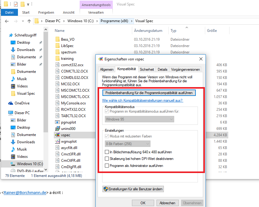

Moin,
heute Nachmittag kam ne Anfrage nach vspec und Windows 10 bei mir an.
Bei mir klappte vSpex mit 1607 auch nicht . Aber Valery Desnoux konnte mir gleich einen
Tipp geben:
---------------Schnipp------------------
Hello rainer
Try to run in display mode 8 bits. Some people tried this with success.
No clue why... windows is too opaque for me
V.Desnoux
Sent form iPad
------------------Schnapp
Jetzt schein VSpec zu laufen
Rainer
Unbenannt1.PNG [ 94.74 KiB | 1741 mal betrachtet ]
Unbenannt.PNG [ 58.83 KiB | 1741 mal betrachtet ]

Hi Bernard,
Ulrich Waldschlaeger ask me yesterday to solve a starting issue of vspec, after he updated his machine.
After a update of Windows, it wont start, wont open any vspec windows. so also didnot start
any control options ander vspec.
So i tested it under the friday upgrade (KB 3294496). It installed the build 14393.222.
And yes vspec wont started. (No reaction after klicking the icon- also under admin rights).
So i contacted Valerie and she gave me the hint that vspec can start unter the option that
the display mode 8 bits.(under Settings for the vspec.exe- right click in explorer) Now it runs fine.
It seems that this error comes only in the build 14393.222 on a 64 bit machine.
Yes my english is very poor, but i hope you can understand me.
Thank for your hint to change the config settings at start. Im sure that Windows comes
with surprises in next version, so we can need this hint.
By and best greeting to the UK
Rainer

Oh, a thousand times sorry that I had localized you to Europe.
And thank You Valerie reported the problem. Just so she could quite quickly call a workaround
bye, Rainer

Hallo Rainer,
VSpec funktioniert wie oben beschrieben, danke für den Tipp!
LG
Siegfried
