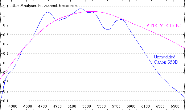

ich möchte die Werte/Daten aus einer Liniengraphik auslesen.
Aus einer Responsekurve eines Canon Chips möchte ich die Werte einer Kurve Pixel für Pixel
in eine Tabelle überführen. Das geht sicherlich per selbstgeschriebenen Programm, aber mit
entsprechendenem Aufwand. Vielleicht hat jemand eine Software in der Schublade, die sowas
machen kann? Die Grafik stammt von: http://www.threehillsobservatory.co.uk von Robin Leadbeater.
Danke
Rainer Borchmann
SA_DSLR_instresp.gif [ 6.32 KiB | 3395 mal betrachtet ]

Hallo Rainer,
Du kannst Tracer verwenden:
https://sites.google.com/site/kalypsosi ... software-1
Gruss, Martin

Hallo Martin,
großartig, das ist genau das, was ich gesucht habe.

Hello Rainer,
Note that graph is not just the camera sensor response. it is the whole instrument response (Star Analyser 100 grating + camera lens optics + atmospheric absorption + sensor response). It was just to demonstrate the difference between mono and colour sensors and will be different for different gratings and atmospheric extinction.

Rainer,
If you want the QE response of the camera sensor only, this graph by Christian Buil might be better
http://www.astrosurf.com/buil/us/digit/spectre_4.gif
from this page
http://www.astrosurf.com/buil/us/digit/spectra.htm
It is a direct measurement of the sensor response for a Canon 10D/300D

Hello Robin,
thank you for your clarification. Did you know, where can i get curve of the sensor from the Canon 350 D?
Have a nice week
Rainer

Hello Robin,

Hello Ken,
Yes, I have already searched for and was found some results.
But really reputable sources eg. From Canon or a spectroscopist i would have liked to find
And on the other hand, the response of the combination of CCD sensor and star analyzer is
also interesting to know
Thank you very much.
Rainer.
