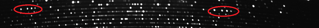

 Betreff des Beitrags: Re: Re: ISIS and my echelle
BeitragVerfasst: 19. September 2017, 15:03:27 PM
Beiträge: 101
ISIS Th Ar.png [ 127.1 KiB | 1841 mal betrachtet ]
From my own, and other's, experience the physical orientation (rotation) of
the camera is all important, and needs very fine tuning, to get everything
working. Despite published advice to set the 'four ThAr lines' horizontal I
had to set them a bit 'off' to achieve alignment.
Cheers,
Bernard
https://www.avast.com/antivirus
I think this is my problem as the 4 lines are at the extrems of the of orders 34 and 35 with my grating see attached.
 Betreff des Beitrags: Re: Re: Re: ISIS and my echelle
BeitragVerfasst: 19. September 2017, 15:30:02 PM
Beiträge: 178
Wohnort: Melbourne, Australia
Andrew,
Using way off-centre lines may indeed be the main problem. As ISIS allows
you to define a different ref line, and set of rotation lines, I suggest you
select a good line near the centre.
Cheers,
Bernard
