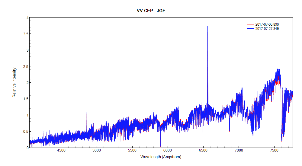

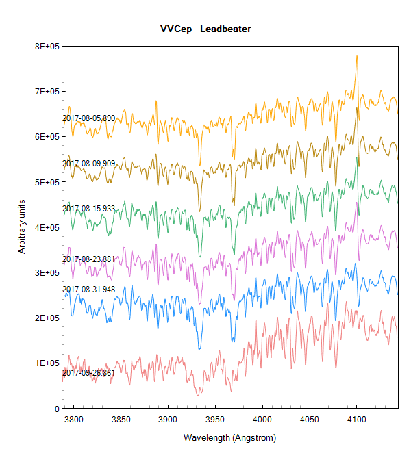

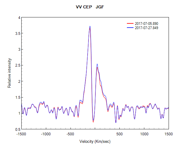

Have some graphics from the VV Cep. The changes are subtle.
A question to all observers, is there someone who has recent observations of this star?
There are currently many stars to watch and it seems that telescopes are needed.
Regards, Joan.

Hi,
How long is your exposure time? What S/N do you have?. It could be useful for others if you would provide your spectra for downloading.
Do you have any experience with crosscorelation to find radial velocities ?
Cheers Berthold

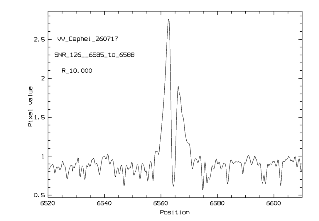

from time to time I take spectra from VV Cep. So I have a reduced (to get more practice in ESO-MIDAS) spectrum from July the 26. 2017.
6x300sec with C5, equipped with Lhires 1800 l/mm, ATIK 428.
VV_Cep_26.07.17.png [ 67 KiB | 4133 mal betrachtet ]

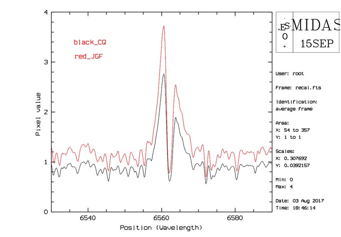

 Betreff des Beitrags: Re: VV Cep
BeitragVerfasst: 02. August 2017, 15:48:46 PM
Beiträge: 229
Joan,
there is a signifcant difference between our normalisation to 1. Your intensity is higher. Maybe too high? Or am I too low? Do you know enough about the physics of this system that you can say what would be better?
Viele Grüße und CS

The exposure time varies a lot, depending on weather conditions and seeing conditions, there are usually 8 integrations between 150 and 300 seconds. I try to get the Halpha peak to reach half the histogram.
I also send a graph, (_vvcep_20170727_849_JGF.fit), which is the closest observation to that made by Christoph.
My experience is reduced to the observation, these graphs, automatically calculated by PLOTSPECTRA, by Tim Lester, https://1drv.ms/f/s!AvXqhKI5kEGRjEhdaQ6jaj8AHx_L.

Hi,
Berthold, ja das Problem ist, dass da ja nicht wirklich ungestörtes Kontinuum vorhanden ist, um das SNR vernüfntig messen zu können.
Joan, the fits-Header of your fts say, that you used ISIS for data reduction. But there are no operations done by ISIS listed. It seems, that you dont set your zoom into Ha to 1. If you do so, our data fit.
MIDAS is a command-line driven programm, developed and used by pros. It runs in Linux. If you are willing to learn something new, I can recommend it to you! One of the advantages of this programm is that it is transparent. So you know what happend to your data.
I attached also my .fit. By the way, the forum allowed not .fts. Does anyone know why?

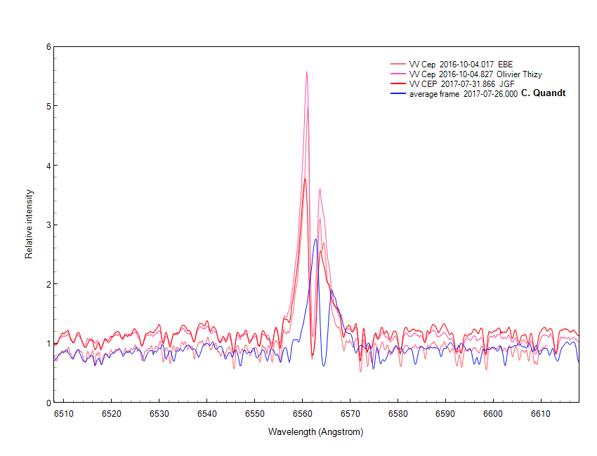

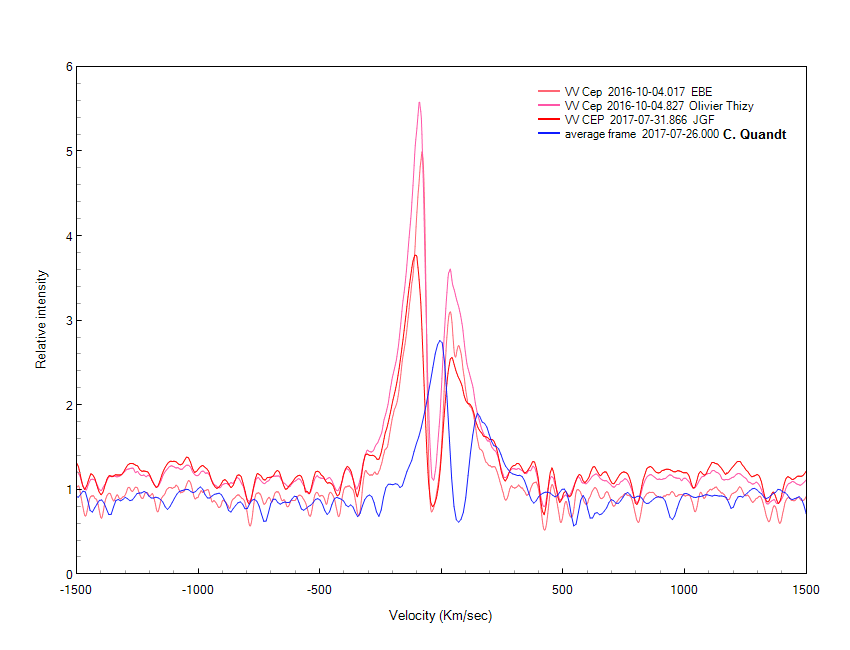

Wohnort: PIERA ( Barcelona )
Hello Christoph,

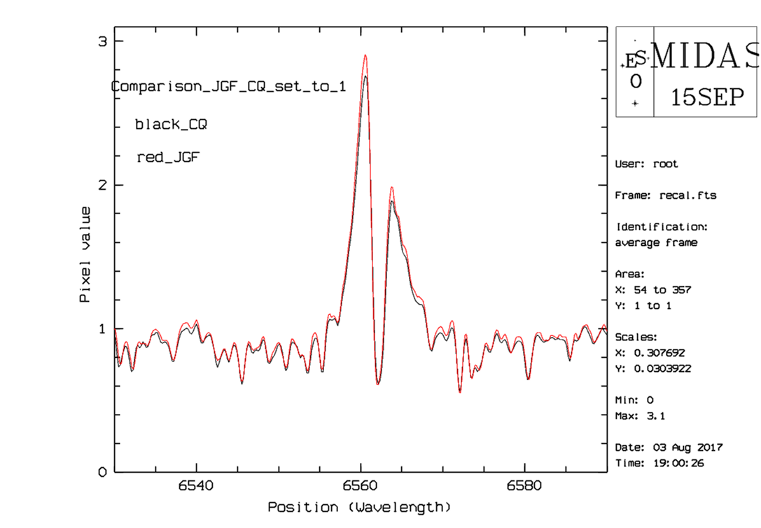

Comparing your graph with that of other observers, there is a strong shuffle in the wavelength.
Could you check your calibration data?
At the moment I have not thought of changing software, the ISIS works very well and the results are very well accepted by professional analysts. This year, as a co-author, there is an article in Icarus and another in Astronomy & Astrophysics and another one about to publish. I do not say it with a spirit of arrogance. I say this to reaffirm the good quality of ISIS.
Friendly, Joan.
vvcep_20161004_017_4GRAF.png [ 70.78 KiB | 4090 mal betrachtet ]
vvcep_20161004_017_4GRAF2.png [ 63.82 KiB | 4090 mal betrachtet ]

Hi Joan,
you are right!
My calibration wasn't good :oops: . I've corrected it. I use usually the water lines (because normally its more precise than the three neon lines) for calibration and not experienced in reduction of "late type stars". (And I'm still learning MIDAS. Mistakes are not excluded!)
Do you know, if ISIS or PLOTSPECTRA correct your data for the temperature of the star? Is there generally a difference for Echelle spectrographs?
Gratulation to your co-autorship!
Its okay if the software work fine. I think there is a good match in our data quality. For me its a problem, if the software is a black box. Therefore I decided to learn MIDAS.
I attach two graphs. The first show our spectra without setting yours to 1. And the second with normalisation of your spectrum. There is a little differnce. Maybe an error of my subjective choice of points for the spline or intrinsic origin?!
VergleichCQJGF.png [ 111.29 KiB | 4078 mal betrachtet ]
Vergleich_normiert.png [ 116.46 KiB | 4078 mal betrachtet ]

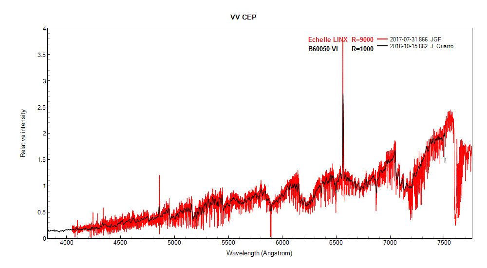

BeitragVerfasst: 04. August 2017, 21:09:31 PM
Hallo Christoph,
Do not worry about making a mistake, this comes within normality, I've done dozens, and most seriously, and I have not done the last.
In ISIS, if you can correct the data for the temperature of the star, (it can also be done with the VSPEC), as long as you have observed a pattern star on the same night. The echelles are a world apart, I have seen "terrible" graphics obtained with echelles, (both professional observatories and amateurs). In order to get good results in the curve of a star they must be single-order spectroscopes, the Lhires and those with low resolution.
See the animation of Umberto Sollecchia, Aug 01 2017 8:48 pm, http://www.spectro-aras.com/forum/viewt ... 4&start=70.
In my case, I compare the entire spectrum of the echelle with a low resolution (see graph), of course this is not useful for all stars, (RRLyr, Novas, etc.). Your second graph adjusts a lot to reality.
I really like to have this change of views with you, we must keep in touch.
BeitragVerfasst: 27. September 2017, 19:29:14 PM
Attached are a series of spectra of VV Cep covering 3800-4150A at R ~2500 (variable 3000-1500 across the range due to LHIRES chromatism)
Note the loss of H Balmer emission, broadening of the Ca II H K lines and relative drop in continuum flux below ~4000A, particularly noticeable in the latest spectrum recorded 2017-09-26
This is the same pattern as seen with AZCas (Except that there is no H alpha emission)
http://www.threehillsobservatory.co.uk/ ... tra_43.htm
vvcep_20170805-20170926_Leadbeater.png [ 94.99 KiB | 3579 mal betrachtet ]
