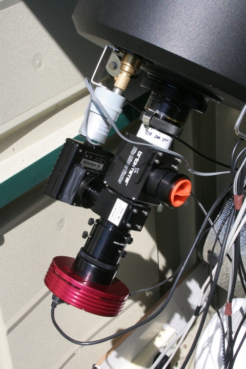

Before I bought the calibration module for my ALPY, I used a flip mirror (the wrong way round) between the telescope and the spectrograph to inject the calibration light. You can see it in this photo
http://spectro-aras.com/forum/download/file.php?id=887
