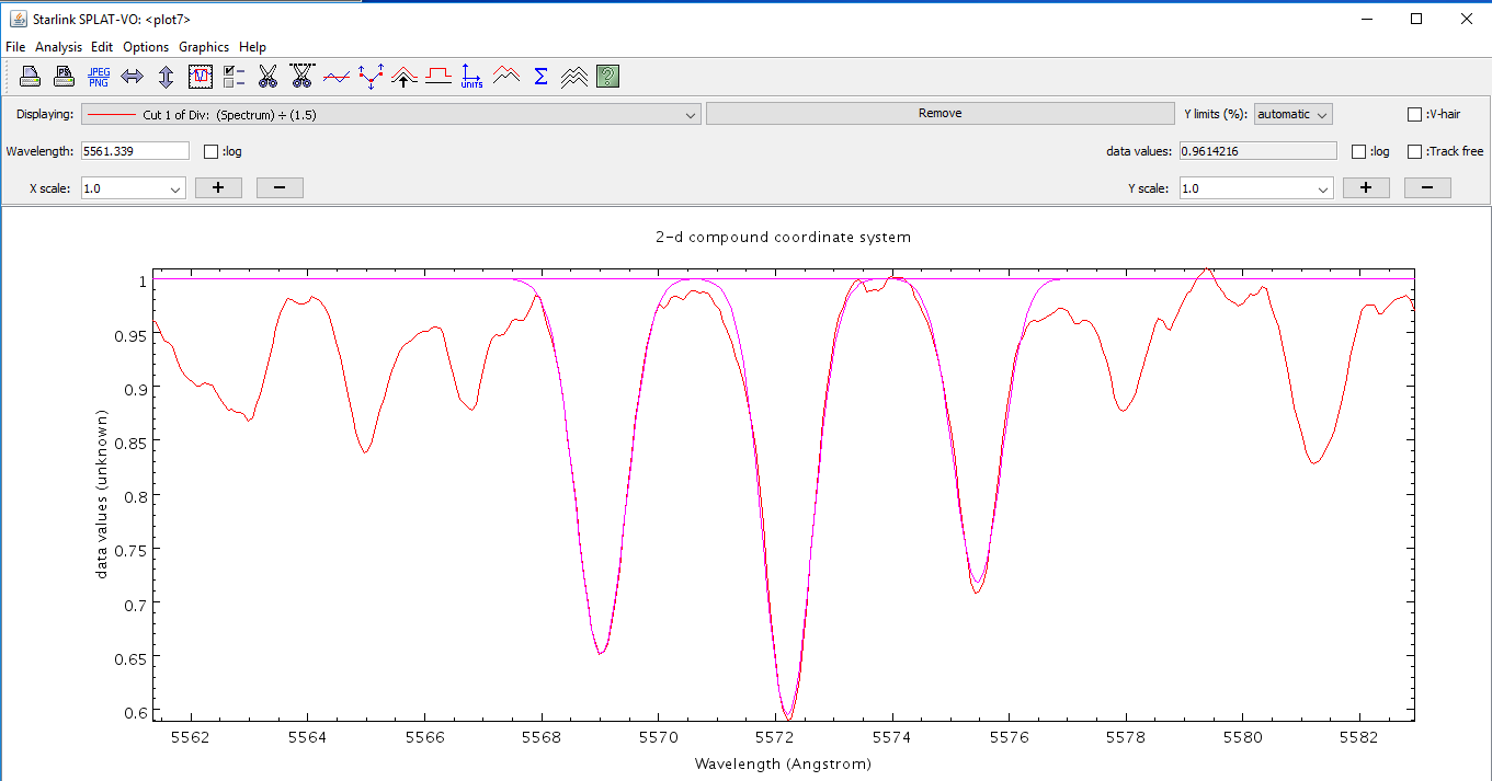

Thanks Thomas, I am mainly interested in absorption lines at the moment. I attach a first attempt using SPLOT on some data from Rho Cas on 3 FeI lines . SPLOT though manual seems to be quite robust to small changes in the continuum estimate and my results seem to be in the right area looking at data from A Lobel et. al.
I would like to get advice on best practice in the area of Equivalent Width measurement.
I have found a paper by P B Stenson and E Pancino on DAOSPEC ( another automatic program) that has a good discussion on the issues involved in the measurement.
Regards Andrew
