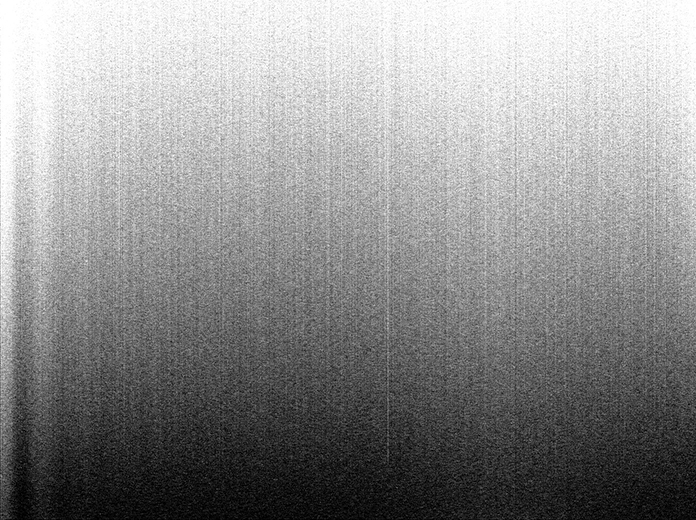

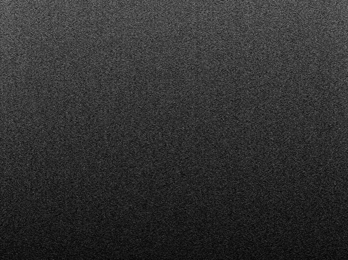

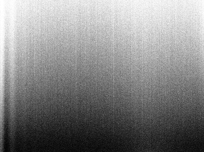

So when I take a simple darkframe there should be a difference between a darkframe taken 'true' the LOWSPEC and one taken from the same camera covered by a metal cover.
I haven't done that yet but I've looked at the difference in darks from the situation where the DADOS was attached and when the LOWSPEC was. In both cases 30x120 sec averaged.
In these situations I cannot see any significant differences.
Dateikommentar: Difference LOWSPEC-DADOS
DARK_Dif.jpg [ 330.95 KiB | 2875 mal betrachtet ]
Dateikommentar: Darkframe LOWSPEC (30x120 sec.)
DARK-LOWSPEC.jpg [ 311.68 KiB | 2875 mal betrachtet ]
Dateikommentar: Darkframe DADOS (30x120 sec.)
DARK-DADOS.jpg [ 333.74 KiB | 2875 mal betrachtet ]
