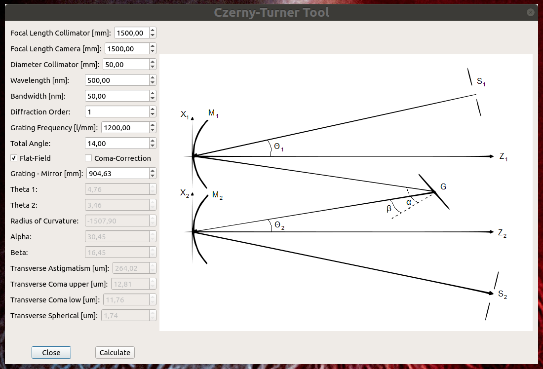

I am happy to announce that there will be soon further tools available in SILENT.

2. Czerny-Turner Tool
To calculate aberrations and geometry in two ways: Coma minimization or flat-field condition.

CTTool.png [ 157.8 KiB | 4969 mal betrachtet ]
