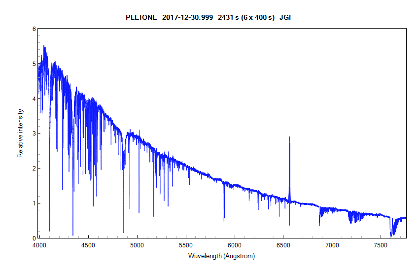

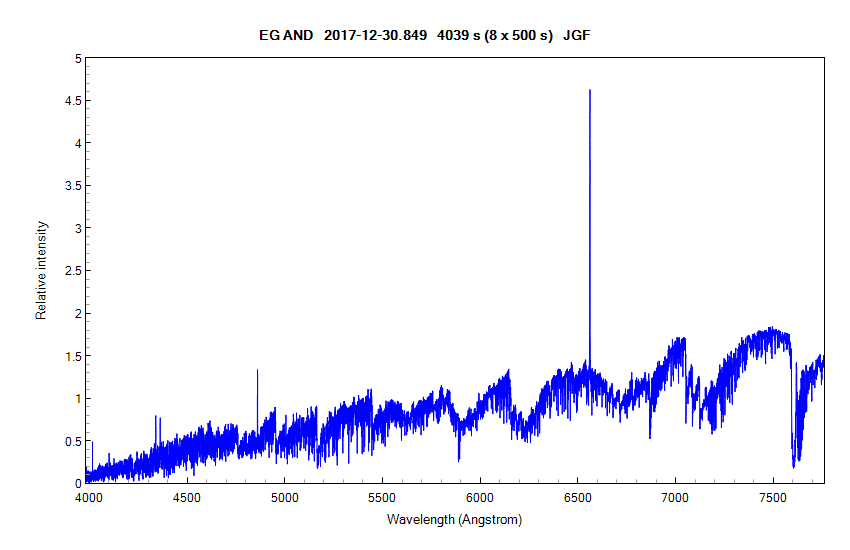

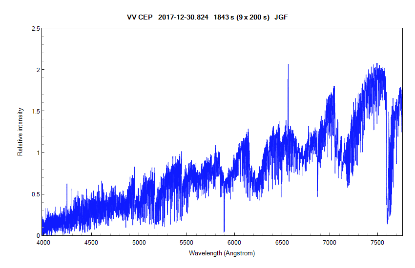

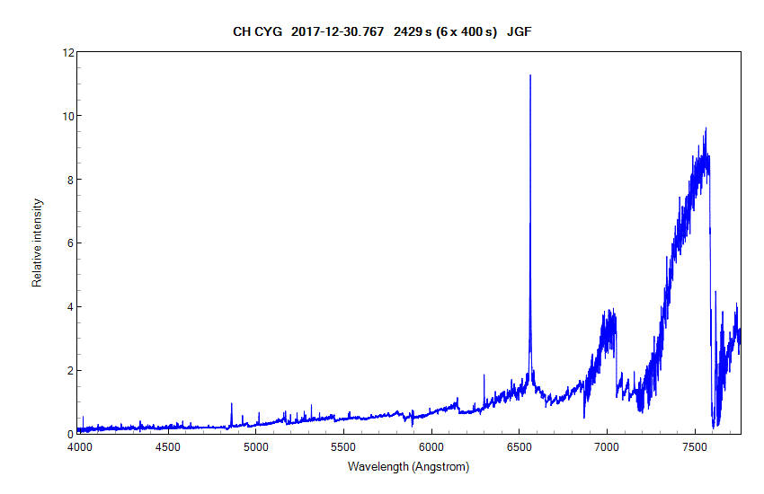

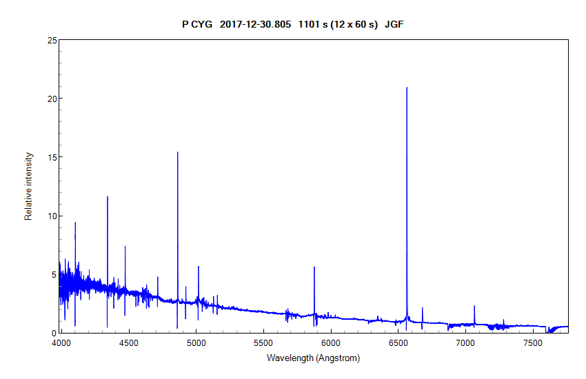

Hi,
These are last stars observed in the year 2017. All of them are part of several observation and study campaigns.
I hope you like them.
With my best wishes for the New Year 2018. Friendly, Joan.

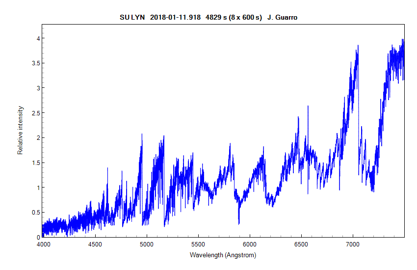

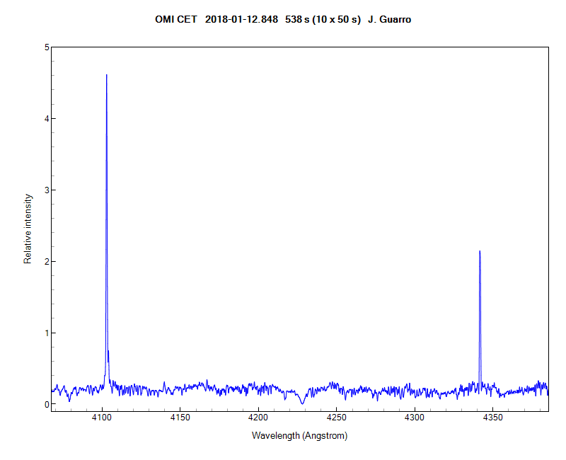

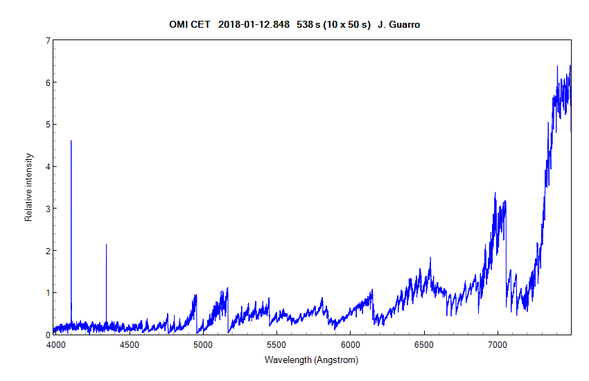

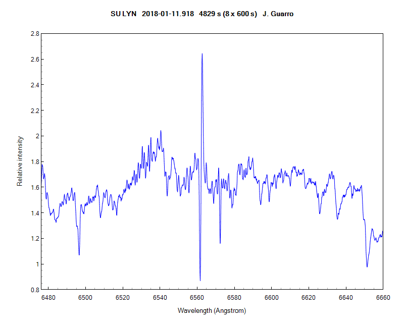

They are graphs of the first observations of 2018.
It seems that Omi Cet is at its maximum, surprises its emission in the Hgamma and Hdelta.
As for the SU Lyn, it shows its magnificent sawtooth and its unique Hapha.
Friendly, Joan.
