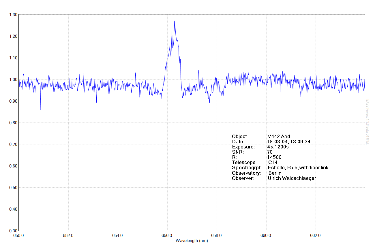

Hi Olivier,
motivated by your thread yesterday I started in the evening my first run on this object. Seeing was not so good here in Berlin, but I got somthing like a spectrum. SN is just around 70 after 4 x 1200s. So fara good training to push the limits. I will proceed.
Kind Regards,
Ulrich

 Betreff des Beitrags: Re: V442 And outburst
BeitragVerfasst: 08. März 2018, 10:04:54 AM
Beiträge: 56
Hallo Ulrich,
Good result !!! Did you put your spectrum in Bess database ? It could be useful to have your spectrum (because there are not many realized on this period).

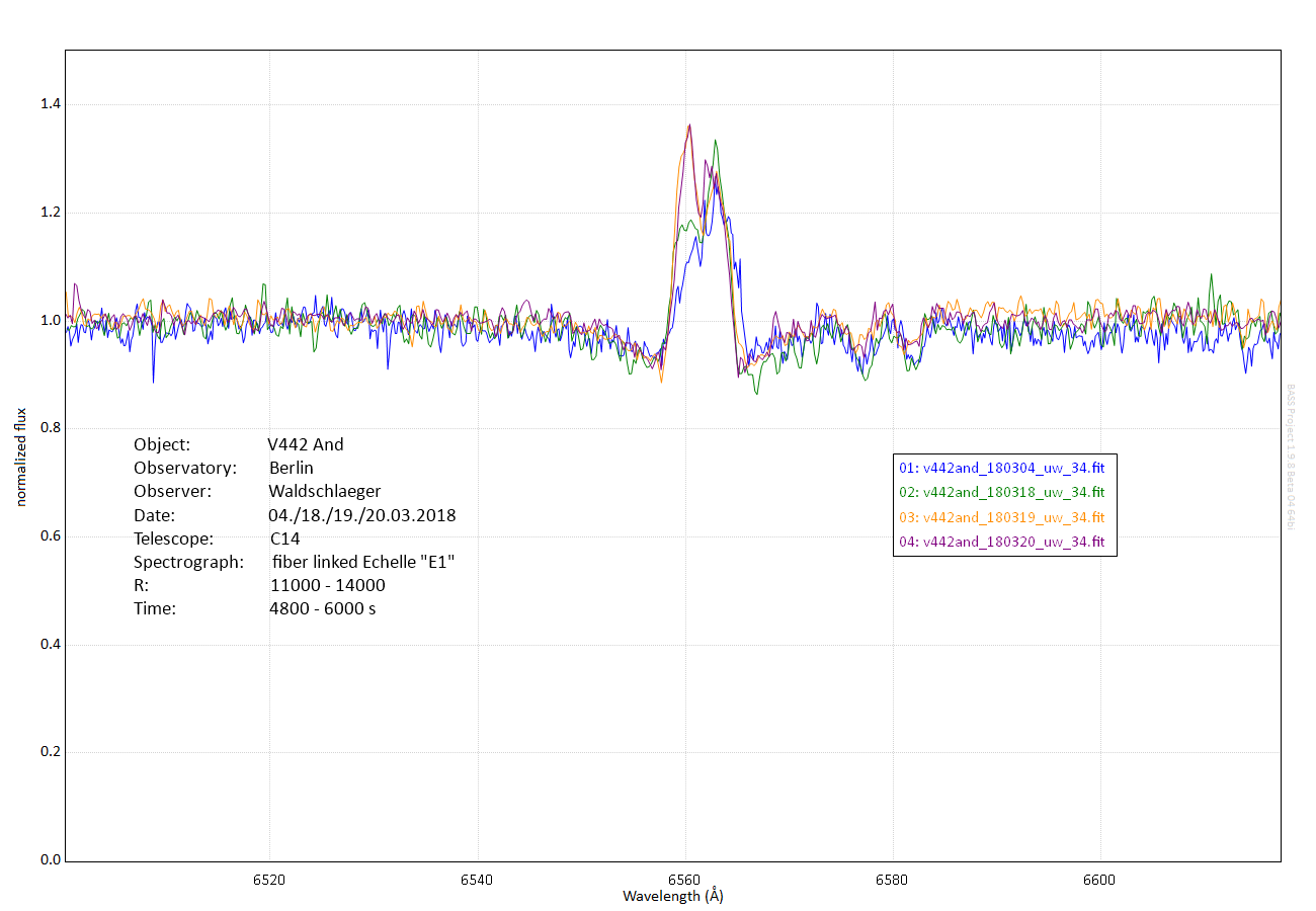

BeitragVerfasst: 30. März 2018, 22:53:52 PM
Beiträge: 132
Wohnort: Berlin
Hallo Olivier,
for me V442 And is out of visibility here in Berlin now. The season can start again in July, on higher Azimut with better SN hopefully.
Attached the yield for March which is already uploaded to the data base.
Happy Easter!
Ulrich
