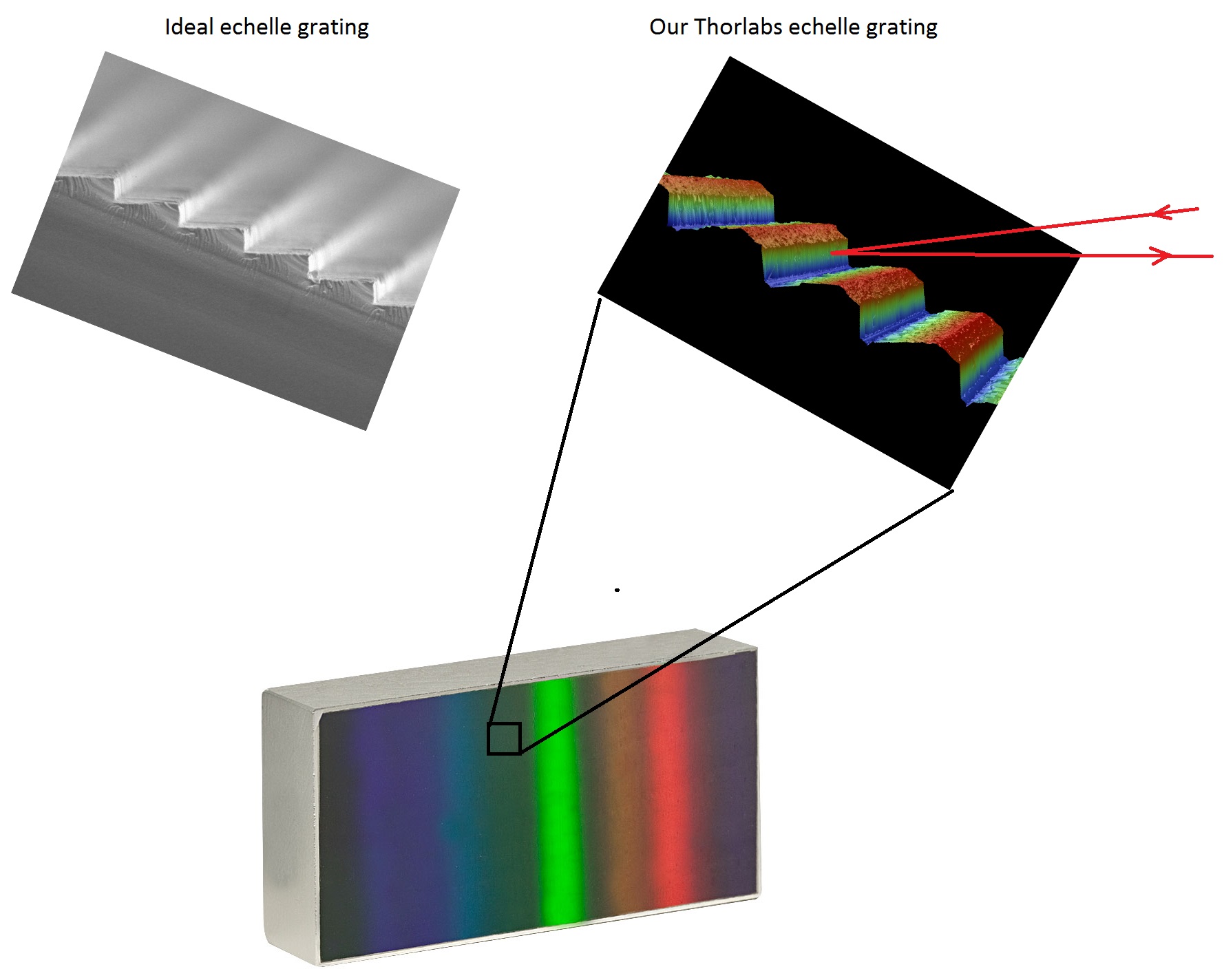

Hi Tobias, your investigation is very interesting! It shows the importance to check all different optical elements in detail.
(From the grating equation we know, incident angle, grating constant, wavelength (here laser) and echelle order are constant (when remaining in the same order). By changing gamma, beta changes which sweeps the emission line through the order (is that correct explained???)
I believe, this explanaition is correct.
Well, not all of the light in the Thorlabs echelle does this.

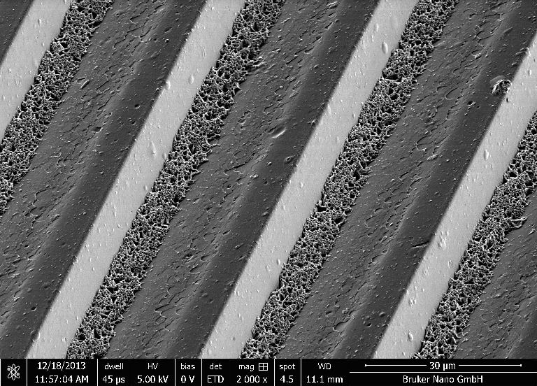

Some time ago Ulrich Waldschläger scrutinized the surface quality of our R2 31.6 g/mm echelle grating from Thorlabs with a microscope at Bruker Nano in Berlin (unfortunately I do not know the item number). The result is attached (see page 252 in our book - Note that we also discuss the influence of the angle of incidence on the Echelle efficiency in chapter 6.3.3 on page 248). There seems to be a chamfer at each grating line but certainly not as prominent as in your grating. I do not know if this is a general production difference or just a coinsidence. We also have a Zeiss grating and it might be interesting to see its quality. It might be possible that a perfect line geometry can not be manufactured (remember the production process) but I fully agree that this is an important issue.
Another potential issue is the positive and negative aberration as we describe in figure 6.14 on page 252.
Hallo Ullrich,
ist der relativ gleichmäßige Schmutz in den Rillen durch die Präparation für das Elektronenmikroskop verursacht? Oder war der wirklich schon vorher auf dem Gitter?
Der nimmt ja auch einiges Licht weg (da müsste mal der Dachkehrer zum Einsatz kommen :D ).
BeitragVerfasst: 24. Oktober 2015, 19:21:05 PM
Beiträge: 132
Wohnort: Berlin
Hi Lothar,
No! Typical preparation for SEM investigations and just for isolators is a carbon (or gold) coating to get a ground contact for the electrons and to avoid charging effects on sample surfaces. Due to the Al-reflection layer no coating was necessary and of course forbidden from the beginning.
I was also suprised by the residues in th edge of the grid. I am not so familiar with the production procedure of these parts, but I would expect a replica technology from a master piece like a disk record. In this case it could be a residue from the separation agent. But for this purpose is it to porose. Maybe the reflectivity is not so effected as it seems. The cross section of the grid shape is not a perfect angle or edge and the residue are placed deep in the edge. Means the remaining smal face of the edge is all we really need for the purpose.
Regards,
Ulrich
BeitragVerfasst: 24. Oktober 2015, 21:57:01 PM
Ulrich is right! It is highly unlikely that the material in the deep part of the grating line has any influence on light diffraction because of the grating shadow effect. So, it does not matter what material it is.
I wonder, though, if the chamfer shape on top is really different to the shape of Daniel's grating. From the microscope image and due to projection effects this is difficult to say.
Cheers, Thomas
I think it depends a bit on how the grating is operated. In the case of a near-Littrow configuration with theta=0 and gamma > 0 there might be some light losses expected since the full width of the facet is used. In the other configuration (in-plane) where gamma =0 but theta >0 this might be not the case since parts of the facet are shadowed by how the beam approaches the facets (see attached figure). I assume there might be some undercut (case A) applied or smaller angle used between horizontal and vertical grating facet (case B) but I am uncertain about the shape and its dimension.

Hi Tobias, the "undercut" remains invisible. Hence, this is speculativ. Better not taking it into consideration as long as we do not know. There is some material but it remains unknown and might introduce light loss. Your argument with Near-Littrow is correct, of course. The only way to get an answer for the gratings is a direct request to Thorlabs, I presume.
Cheers, Thomas

The material on the line bottom is probably dust from the manufacturing process. Its composition is unknown.
The "plateau" area on top of the lines is on the inactive side, hence, of no impact.
The active line flanks are produced by "line-by-line compression" where each grating line is compressed after each other. Hence, this is not a master replica. This very process introduces the chamfer on top of each grating line.

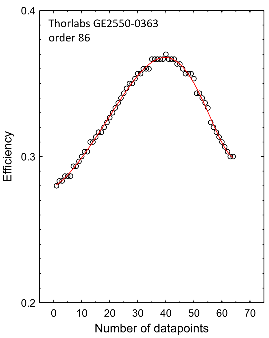

I have attached one of my quick n' dirty measurements. Please note that this was done with my "fliegender Aufbau". I did not measure the turning angle as I was interested in the peak efficiency only. Maybe that helps ... somehow
oldEchelleEfficiency.png [ 88.42 KiB | 28210 mal betrachtet ]
BeitragVerfasst: 05. November 2015, 09:16:40 AM
Hi Tobias,
good to know some absolute measurements. I had also the feeling that something is eating up the efficiency. This would lead to a factor of 0.5 for the efficiency with respect to the manufacturer specification of the master.
Good work Tobias, as always!
Daniel

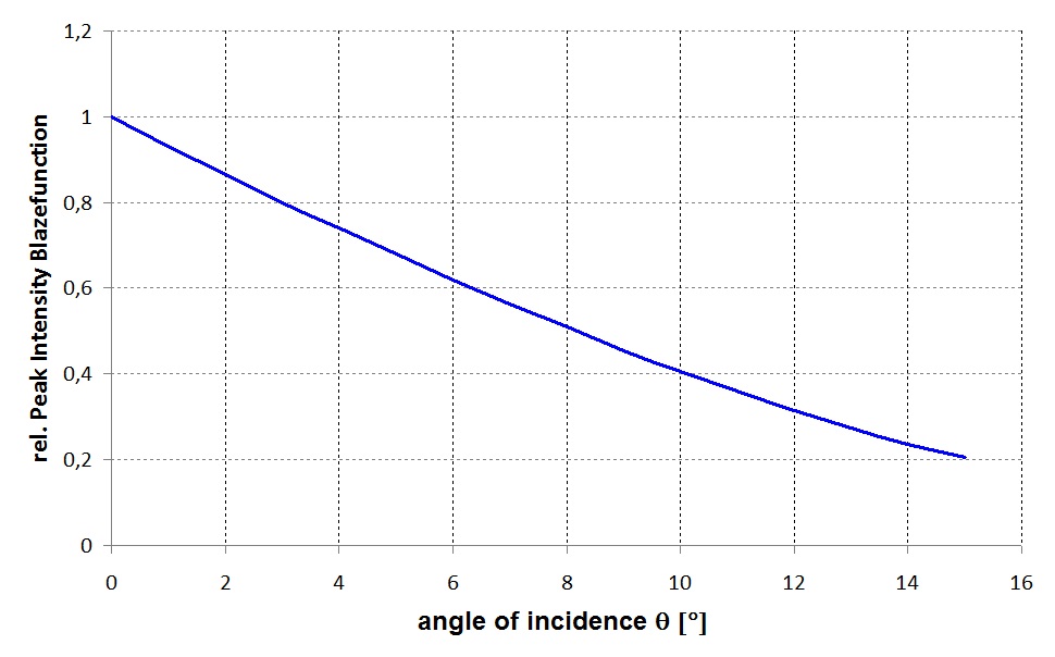

Hi Tobias, it would be important to see the curve for efficiency vs. angle of incidence (how many degrees per datapoints). Note the attached figure 6.16 from page 252 in our book. Already for (should be similar for ) the efficiency drops to 70% of the maximum efficiency. This is very important for the design of an echelle and needs to be considered not to loose too much light. For instance, if we take your extremely bad echelle efficiency of 26% and apply an angle of incidence of, say, 10 degrees, the final efficiency for the echelle grating alone is of the order of 10%! So, could you perhaps give such information?
Cheers, Thomas

That's right. But ... I need to redo the whole measurement, maybe with the new grating. I am using the echelle in near-Littrow configuration with off-plane angle gamma somewhere between 1.5-2.5° (gamma is wavelength dependent here as I am using a prism XD).
BeitragVerfasst: 05. November 2015, 13:01:09 PM
Of course, I understand the necessary effort. Maybe later, if possible. I wonder how you estimate the peak efficiency for . A pure Littrow configuration is impossible. How do you do it?

Hi Thomas,
as Tobias says, he will measure at an angle theta = 0° gamma = 1.5 -2.5° This is as close to Littrow as perfect, since the efficiency does hardly vary with the angle gamma ( see e.g. here: http://spektroskopie.fg-vds.de/pdf/pyo2003.pdf fig 14 and 15 (for an R =2 and R=2.75 echelle). This is also the reason why I chose theta = 0 for my echelle spectrometer (gamma approx. 7°). The efficiencies shown in the paper are calculated for an ideal grating, measured efficiencies are expected to be lower (much lower for Thorlabs echelle gratings :( )
Regards, Martin

This is what I assume: The reason why the efficiency drops for an increasing in-plane angle theta is due to shadowing of the vertical grating facet, similar to a chamfer or dirt that drops the efficiency (see figure above). On the other hand, an increasing off-plane angle gamma does not shadow the vertical grating facet and thus the efficiency should remain somehow constant. Why the efficiency slightly increases (as shown in Fig. 14, p. 31) is not obvious to me ... maybe it has something to do how the beam is projected on the echelle.
Btw. the measurement was done with an off-plane angle larger than 5 degree, but in the final instrument gamma will be much smaller.
BeitragVerfasst: 06. November 2015, 13:50:47 PM
Martin, Tobias, you are right of course! Never mix up and , what I unfortunately did here.
Cheers, Thomas

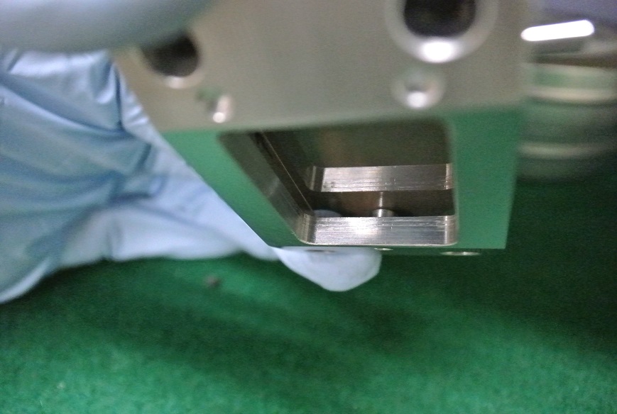

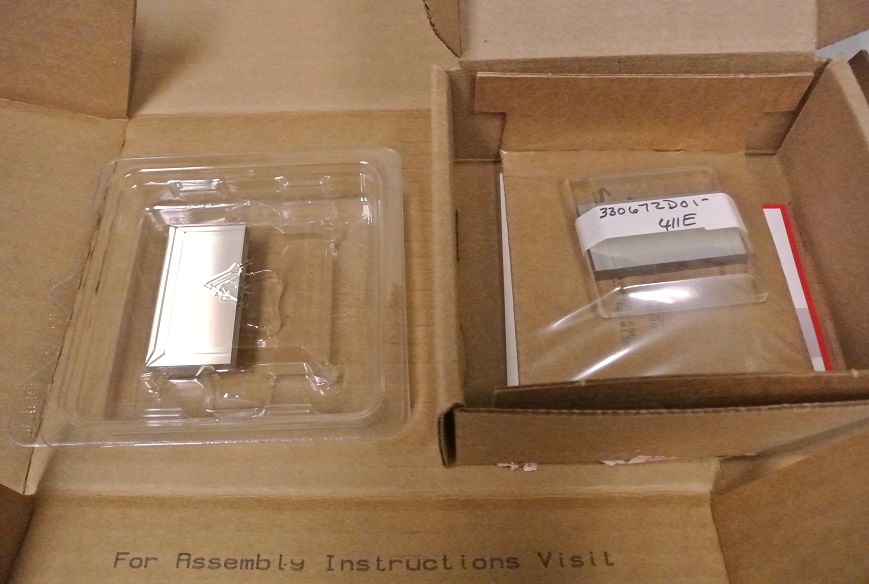

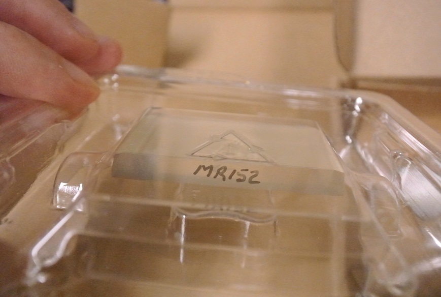

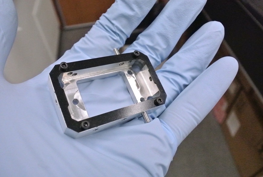

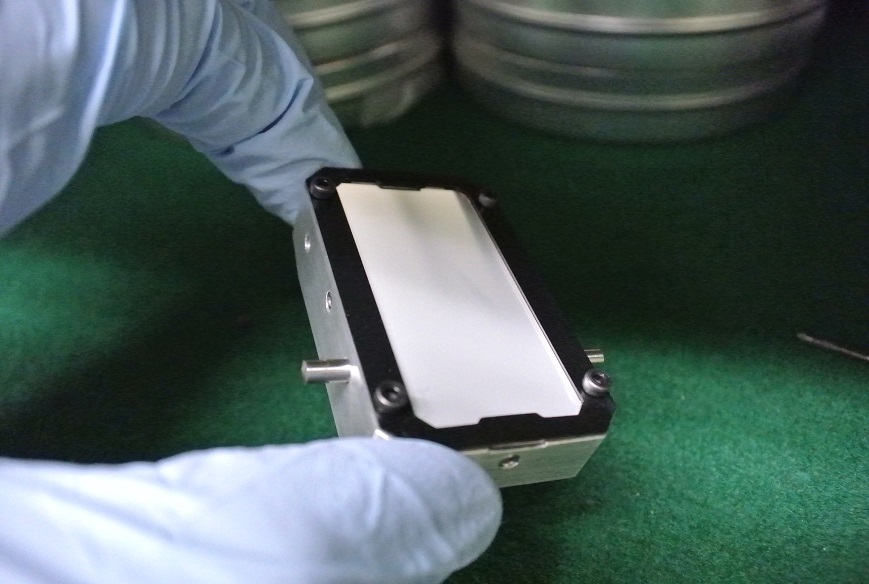

Okay, my gratings have arrived (took a fair bit longer than anticipated) ... will keep you updated with measurements as soon I have transferred the delicate substrate into a nice enclosure.
Cheers,
Tobias
DSC_0684.JPG [ 134.78 KiB | 27703 mal betrachtet ]
DSC_0683.JPG [ 169.54 KiB | 27703 mal betrachtet ]

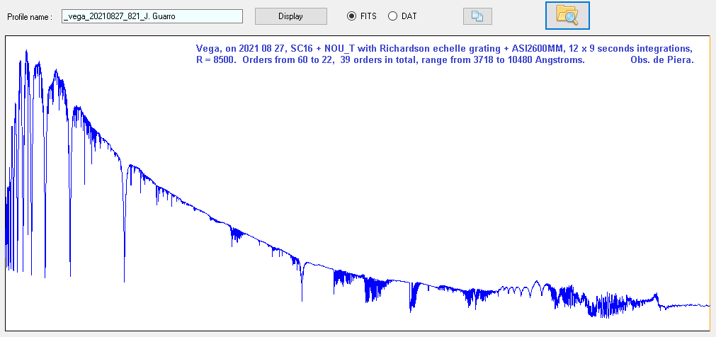

Finally I have been able to test my Richardson grating with Vega. Almost all of us use this generous star to test our devices.
The Richardson EG hasn't disappointed its expectatives, it is around 50% better than the Optometrics one, and Optometrics is also around 50% better than Thorlalbs one so the Richardson is the best of the them with an efficiency  100% over Thorlabs EG.
Unfortunately I don't have quantitative data about that. I only expose here my observational results based on the detectivity and exposure times with the same telescope, NOU_T echelle and ASI2600MM camera.
But all it seems to indicate is that with the Richardson echelle grating my telescope mirror  has twice the area than the Thorlabs one. In other words, my 40 cm. diameter virtually has passed at 55 cm.
Of course, without account the notable improvement is the change of the ATIK460EX to the ASI2600MM.
J.Guarro.
