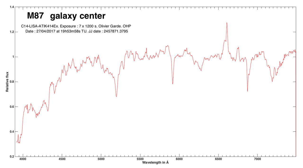

Hi Michael,
Very interesting your analyse of this spectrum :)
Here's my spectrum of M87 taken 2 years ago with a LISA.

And just let me add me data as well, so you or the colleagues can work and these, too ... http://www.astro-images.de/_originale/L ... _rotBB.DAT
Best wishes,
Michael
